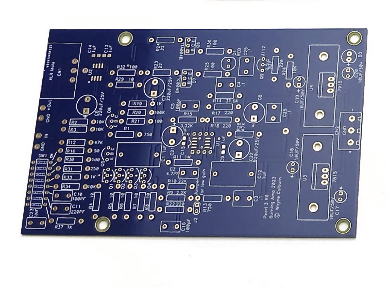

The photos attached to post #1 of the thread about opamp rolling in Pearl3, are copied below.
one-jpg.1282644
two-jpg.1282645
three-jpg.1282646
There were no problems, therefore no discussion of problems. The listeners plugged those adapters into the DIP-8 sockets on the PCB of their Pearl3 phonostage, and played music. With no problems.
A few, but not all, of the opamps tested, were available in DIP-8 packages. Fortunately, ALL of the opamps tested were available in SOIC-8 packages. Thus, for maximum anonymity, ALL opamps were purchased in SOIC-8 packages and then soldered onto adapters. Even the most ancient opamps of the batch, so old that their datasheet was released in 1971 (link) , were purchased in SOIC-8. Ordering code suffix is "D" for the SOIC-8 package on this device.
Here is Wayne Colburn's schematic of the Pearl 3 (left channel), taken from post #1 of the Pearl3 thread. U2 is not an opamp, it is a TI DRV135 fully balanced XLR line driver. PCB photo attached below.
