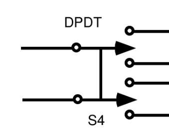

Probably too complicated but it works.
Reactions: tonyEE
I would like to connect two sources (tuner, CD player) to the input on a small tube amp. Can I just hardwire both sources and turn each on and use as needed or do I have to have a switch for some reason to select between sources?
The switch is the best solution, but there is a alternative: a passive mixer. They are readily available with 3.5 jack connectors for use with small class-D amplifiers, the most common one does have a star shape and is sold at low cost on major online retailers. Passive mixers with RCA inputs are less common and way more expensive, it is best to build it yourself.
The circuit is very simple: just a resistor in series between each RCA input and the output. 10K is a common value. The purpose of the resistor is to avoid a fight between the output buffers of the sources. It also overcomes the attenuation that may arise when a source is turned off.
