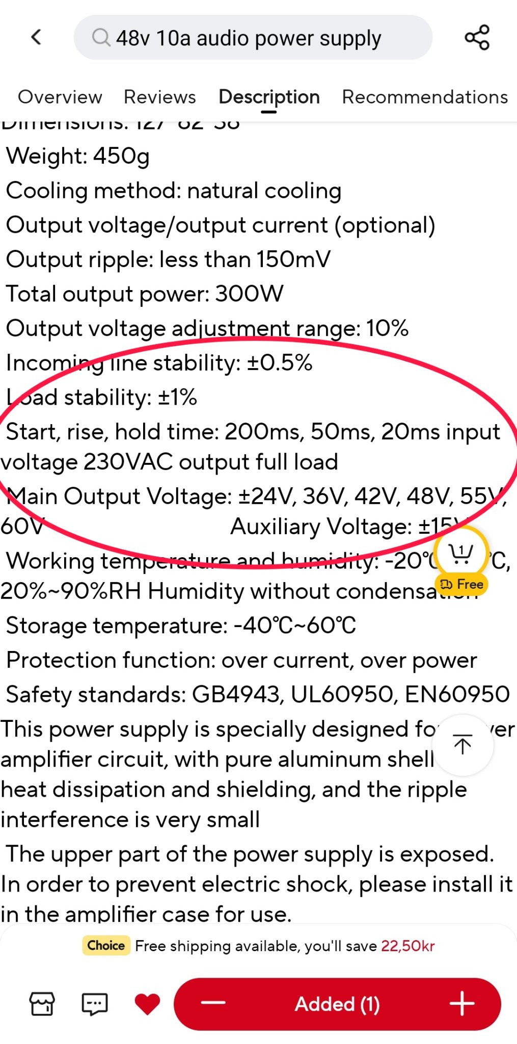

Edit: there is no spec for input voltage range but it is intended for 230 VAC. See here
It's rated for 86-265V
I could not find that figure but that is the usual range.It's rated for 86-265V

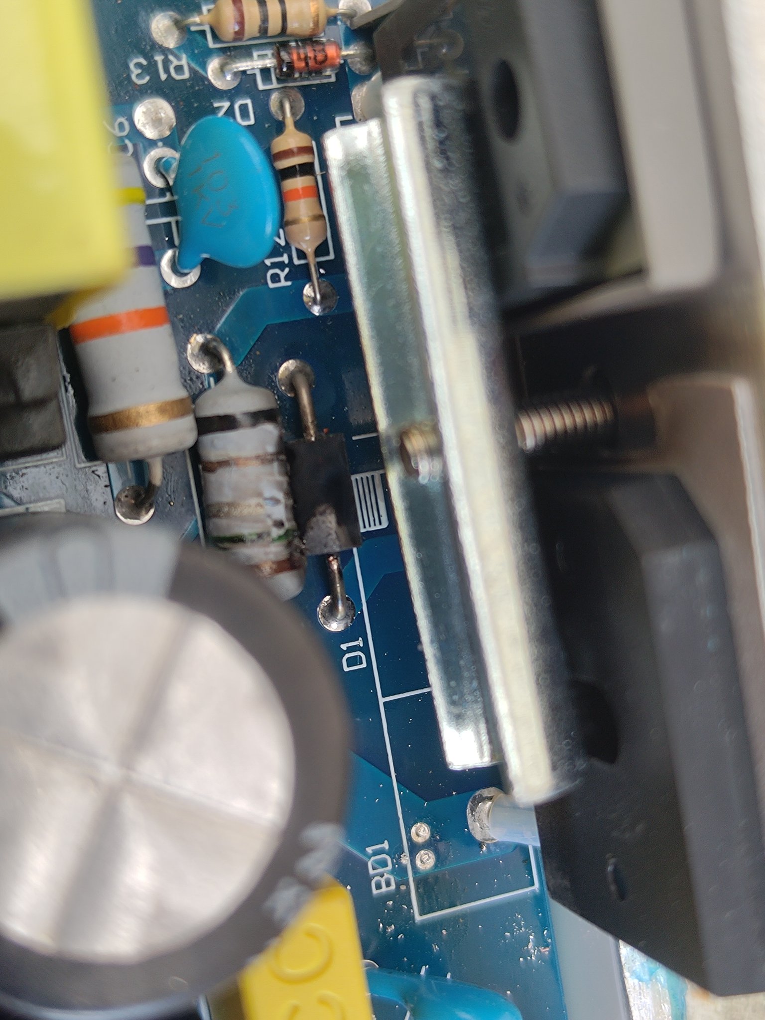

One thing, there is a 1k4ohm resistance between Live and neutral on the primary side of the smps.
And there is an MP72 thermistor.

Such resistance like 1,6k in diode mode is not ok. But due to bleeder resistors, caps sometimes charges very slowly, and this may be false alert. Try to connect to mains directly, if would like to avoid boom, use water kettle in series.
0,15 ohm shunt resistor, so sadly this smps was defective initially. Or it was configured for 110-120v ac input.

Specs for this smps didn't specify ac input range, at least i've not found that. And for full range 85-265v ac it's not designed, doesn't contain booster inductor, at least from seller photos, so it's single voltage range device . Two capacitors near diode bridge, it's very common for devices for 110-120v ac input. Before ordering and blowing another one, first ensure compatibility with 230v input. And for more complete answer, disassemble this blown first, and post a good quality photos of both sides of pcb. Probably a track and jumper was installed for voltage doubler, so if this will be cut, it can work with 230v input.

Maybe you got a wrong version? What did the packaging say?
