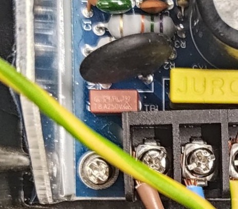

Yes, something wrong. Ac voltage is correct for this smps? I remember some old atx psu had voltage doubler switch (110/220V) and two varistors. High side capacitor was not a single, but two in series, and each varistor was in parralel with own capacitor. They were blown in that psu. Maybe yours have them too? In photo are two caps near diode bridge. Maybe those caps are connected in series and connected to diode bridge? Check for a jumper , from caps midpoint.to ac input. Jumper must be removed if using ac 230v input, and installed , if 110-120v.
Maybe it should. Your SMPS already has a fuse (T8A). The brown-red rectangle. It prolly is universal for 94-264 VAC so you can simply halve the value for your additional fuse (T4A). T2A is just not enough. As for the DBT keeping on glowing, that could be the design of the dual rail PSU. Which would be crap but not fatal. Measure idle power with one of those cheapo energy meters. Then check it against the specs.it shines bright until I switch it off.

From photo isn't clear what is control ic. But i don't see second big inductor ( apfc circuit) ,so assume there's no booster. As it have internal fuse, try to connect it directly. If circuit breaker trips of internal fuse blows, then it's faulty unit and you should open dispute and ask for another . When you get replacement, remove pcb and test components, and can have spare one after repairing it. Do you have electric kettle 1-1,5kw ? It can be used in place of lamp , while testing smps with no load.

Anyway, every chinese SMPS has a sort of fuse directly in the phase line. It is either the very first component in the line, or the one right after an inductor. That means you can safely connect the mains directly to the L-N wires. Without your own fuse.
DO however connect the PE line to the FG.
Be prepared that your house breaker will trip. It is nothing serious but you want to save your files on your PC because you can get a power outage.
The power supply cannot be broken. If it were, the on-board fuse has already blown and it would not blow your 2A fuse.
I am thinking more about one of the filter components in front of the on-board fuse. Either between L-N or between L-ground or N-ground. In this case it can be repaired. But given the electronic skills of the OP I am reluctant to recommend that. After all these are dangerous voltages.
