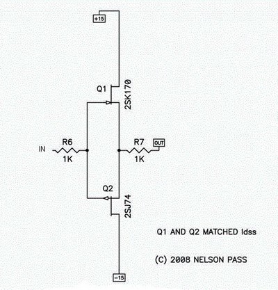

Hi guys ,bought the Pass Aleph L clone from Jim's Audio with relay volume control.
I want to run two power anps : one Rotel Michi RHB10 to power my Gale 401A's and one Connexelectronic IRS2092 kit for subs.
I note that on a lot of valve pre amp designs with parallel outputs have 1k resistors connected between the two left and two right hot pins , is this necessary or advantageous with this solid state design.

leave output to Gale amps untouched , buffer (either with simple R or active buffer) output leading to bass section
Thank you for your help Zen , would you mind explaining how to implement a simple R buffer on the sub output?
R buffer is nothing else than simple resistor in series , to dampen/isolate things a little
things - interconnect cable/next stage input impedance
say that your proposed 1K is good enough
Thank you Zen , So 1K resistor in series with the hot pins of the output for the subs?
Zen: For clarity, is this an adequate example of an active buffer?
certainly.
or you can go with B1 -like ( decrease series resistor on output) - it's using less unobtanium one of a pair - 2SK170BL
2SJ74BL is much costlier
LS ones from DiyA Store are your safest bet
