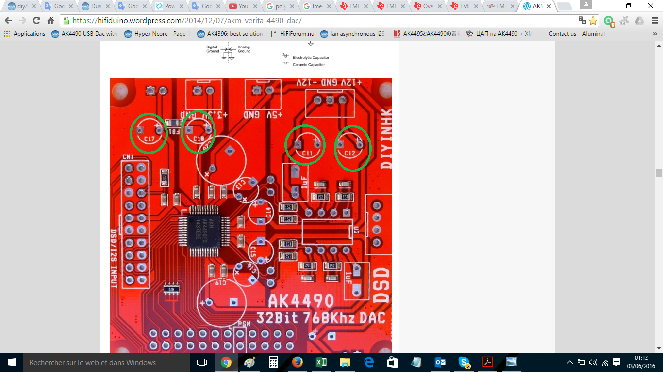

I use two pcb diyinhk ak4490 and I did a test in dual mono. But I have no difference between my stereo and dual mono measures with RMAA. I think there is a problem with output stage.

Just finished a DIYINHK ak4490 board. With a standard 7812/7912 psu for op and a lm317 for 3.3v. On the 5v in i'm use a low noise psu set to 6.8v.
I use the xmos USB card from DIYINHK too.
Everything works, but the sound is really bright.
Anyone have the same problem with this pcb?

Daniel it certainly doesn't sound bright in my set up but I do find that there is no detail missing. I use super regulators for power supplies. In dual mono form this is one of the best sounding DACs I have heard. Better than or equal to the dual mono es9018 DAC I had.
I suppose you can fine tune the sound by use of different op amps. The NE5532 is quite dull sounding compared to the LME79210 but the best I have heard is ADA4898-2.

i tested ne5532, OPA2134PA, ad827, ada4898-2, sonic imagery si994. I love ada4898-2 and si994. si994 is the best for me but is very expensive. I would like test the LME79210 and other on my next LPF. The dac ak4490 diyihnk is not bright at home. Themystical ,have you use a default capacitor?
I have used the Panasonics supplied by DiyinHK. They are good quality. I have put bigger values for the main reservoir capacitor for each supply. 470uF Panasonic FM. No capacitors in the signal path.
