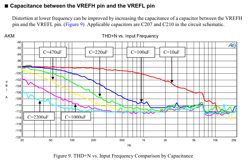

Nice board, but this doesn't have implemented like i see on the board the large value capacitor between VREFH-L/R to improve THD performance, refer to the eval board manual.
Anyway now with some input direction from some post there, i will sugest to go with following line:
- 4 Layer board (minimum)
- Implement a Large Capacitor on VREFH-L/R to improve THD on audio bandwidth... >=2200uF (see attached graph)

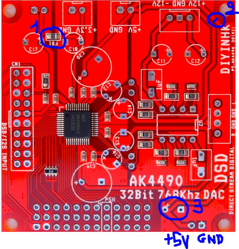

Customize the AK4490 board to provide 2*3.3v , 2*5V to split both digital/analog Ops.
Refer to attached screenshot (1) remove the FB1 to split the 3.3V provided , by adding up to the FB1 3.3V power.
Cut the trace (2) to split the 5V provided on board by two separated 5V, new 5V supply provided under the point (3) .
On (3) solder the 100uF capacitor.
The board now should be cleanly powered (with more direct power line than before 😉
Enjoy your DAC and connect everything by controling any pin to match also don't forget the PSN jumper to set the software mode (for operating trough the XMOS board)
