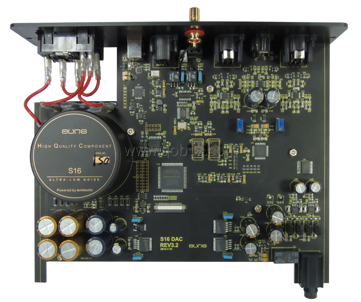

If using ak449x chip I can’t imagine how you can beat the aune s16 dac that sell for about $600. It has the exotic crystek low jitter clocks, Altera FPGA chip, a nice toroidal transformer and many other goods parts. It’s layout looks excellent. Please see the photo.
AUNE s16 dac looks nice, but I remember reading that people were struggling with drivers support... Also can not tell from that photo how is the analog stage executed...?

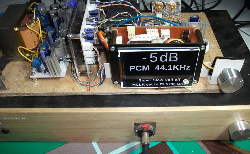

I have tweaked this DAC AK4497 DAC DSD ??? ??384K DSD256 XMOS ????-???
Burson Op-amps in analog output, regs. etc. Now it is really good!

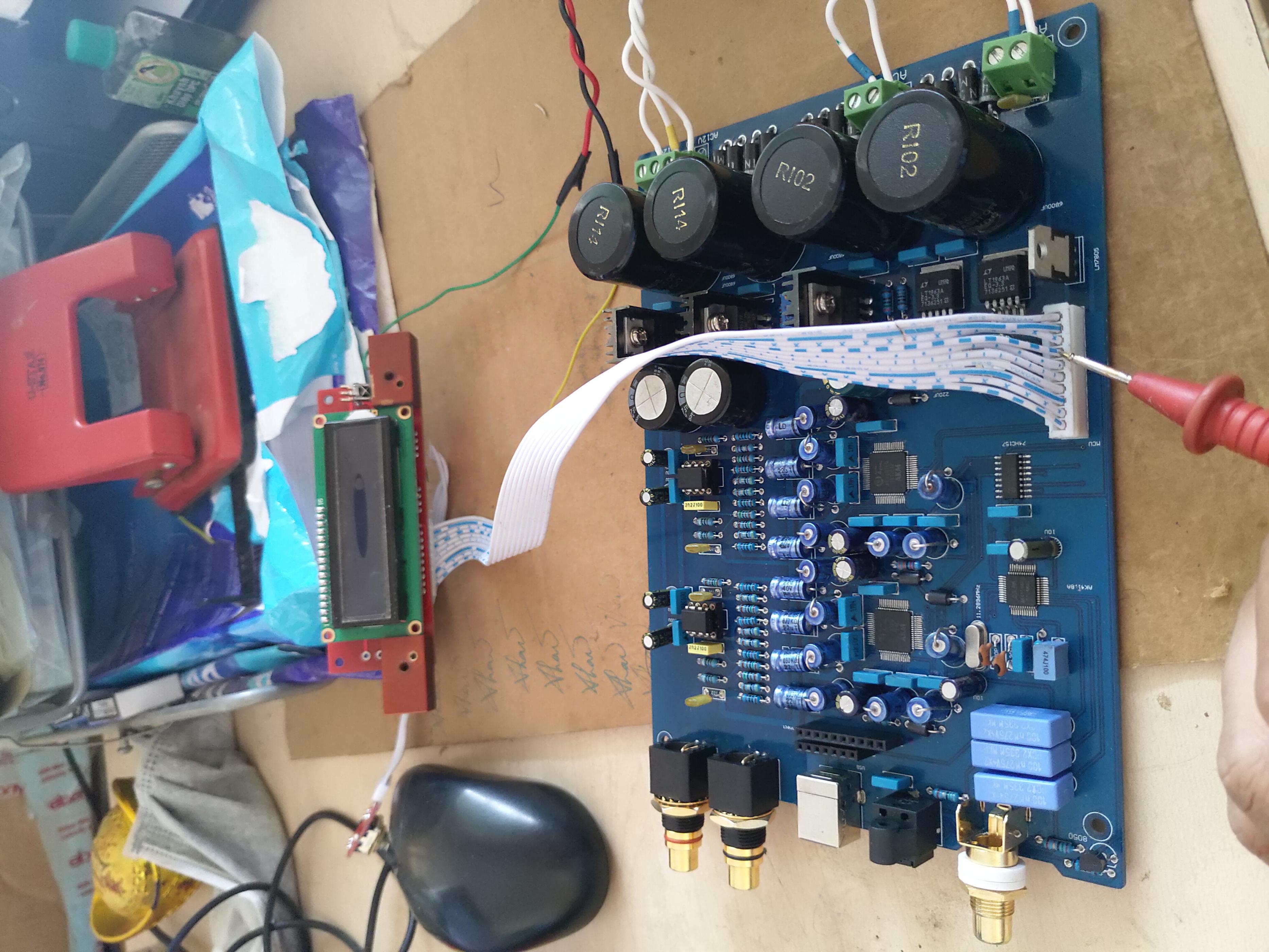

I must say that I'm not satisfied with dual ak4497 I bought.Unfortunately, usb input does not work as it should. I've tried with xmos and amanero card as well and it does not work( I must emphasize that both of those cards work with other dacs). Only things that actually work are optical and coaxialy- digital input

Hello, I am also having the same issue and USB doesn't work. Did you get any help from the seller? I assume the firmware is incorrect on the board or the design itself is buggy. The PCB inside is blue color.
I believe that the AK4497 requires a soft reset upon energisation before it becomes active, check data sheet. The Amanero etc. will need to be programmed to provide this reset?

I same with you, I think it has a problem in MCU, lack of code. You can use USB if you unplug pin 4 cable connecting from main DAC and MCU from main DAC.I must say that I'm not satisfied with dual ak4497 I bought.Unfortunately, usb input does not work as it should. I've tried with xmos and amanero card as well and it does not work( I must emphasize that both of those cards work with other dacs). Only things that actually work are optical and coaxialy- digital input

Regardless of the fact that we have different ak4497 boards, l also think that the problem is with the MCU.Thank you
