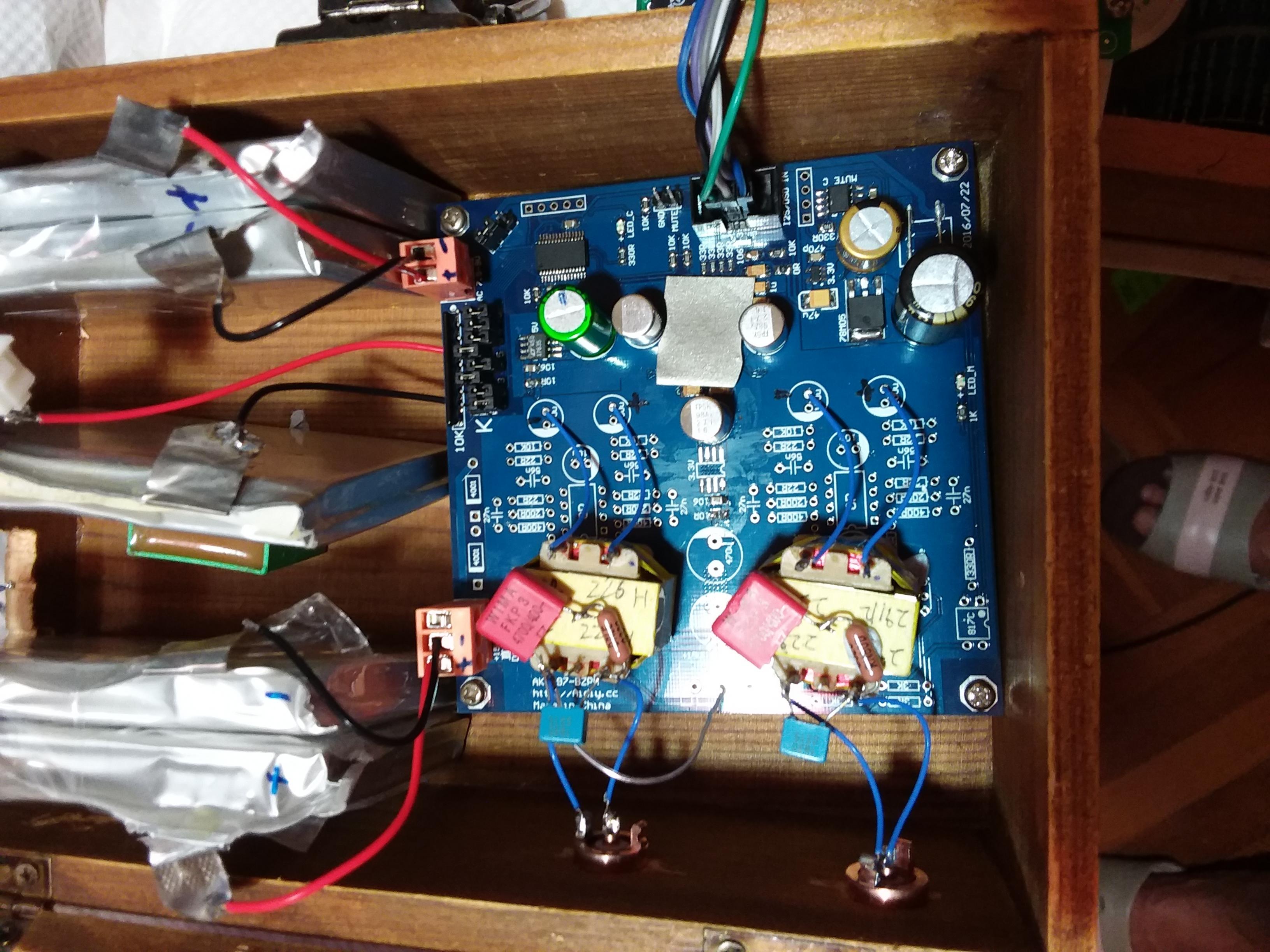

Here is my board photo.
I found this board is very finicky about power up and connection. Even with the xmos board, I have to 1. Detach usb cable, 2. Power up 15v , 3. Power up the a.c. connector, 4. Reconnect sub cable
Note that my jumper 6,7,8 is constantly set to dsd, but it still works with usb feed from ras pi3 using moode

I also got my Amanero board working for the ak4497. I am not sure why it works this time, could be just the incorrect power up/ connecting sequence.
I managed to get sound of the board with the Amanero using your sequence thanks very much. Its all a bit finicky tbh and the SQ using the whole board as designed including the opamps in the output stage is a step below my dual mono AK4490 set-up using DIYinHK boards.
