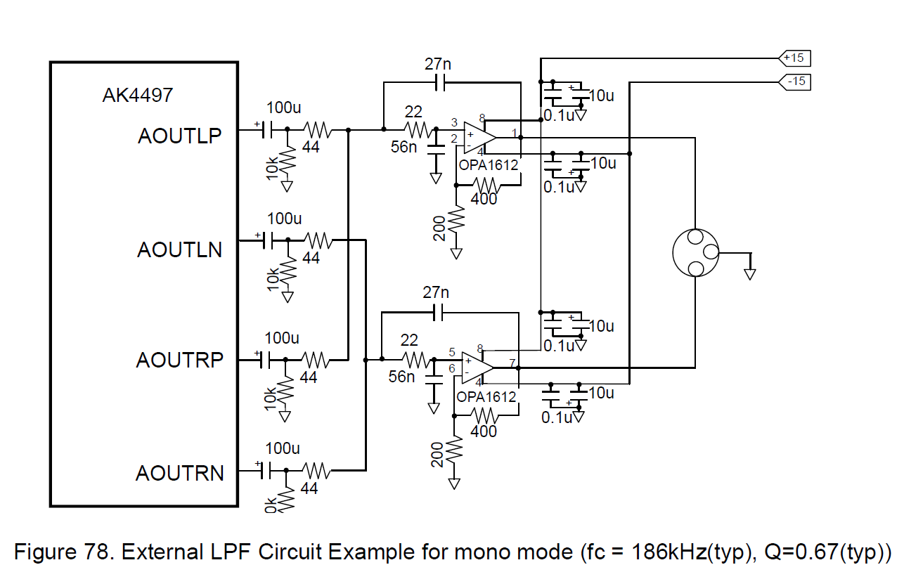

Those resistors and caps *are* summing the outputs. Each summed output is fed to an LPF - so yes, you can use a transformer instead of the two opamps. I would not eliminate any of those components.
I understand that the caps are doing DC blocking. Do they also play a role in the output summing?
Thinking like a total n00b, I am considering omitting the caps and applying a voltage equal to Vref/2 at the opamps' inverting inputs. Wouldn't that cancel out the DC?

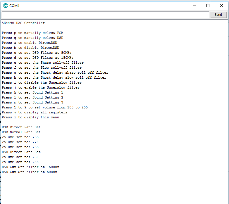

I wrote a piece of Arduino code to control pretty much every parameter of the chip that relates to sound quality for my single chip board. I've put it up on my blog.
It accepts commands through the serial port to change the various options. Here is its menu:
Next up is building a second unit so I can try dual mono operation.
What concerns me is the output stage. I've looked at the dual mono reference design for the 4497 part but I haven't gone as far as comparing the 4490's output characteristics with the 4497's so as to determine whether the 4497's reference design could be applicable to the 4490s.
I also don't like the 100uF capacitors in the signal path, before the summing of the signals. I would like to have full DC coupling if possible.
I'm a noob at analog electronics so any suggestions would be appreciated.
I'm OK with using op-amps but I would prefer something more "interesting", of the class-a discrete flavour. Balanced output would be preferable.
Far as I'm aware they would not be required in stereo operation at all in your scenario, but are needed here else the two outputs are connected directly to each other. Even small DC variances between the two outputs could cause one to exceed its dissipation limits (remember these are inside the chip, so they're exceedingly small).
Frankly for dual mono this is not the correct way of using a DAC chip of any sort, the normal practice is to first run each +/- set through a diffamp and then feed the resultant into another differential LPF. That would allow use of shallow slopes in each filter stage and properly cancel DC.

1) No... if I understand the question, the summing of output for L+/R+ and L-/R- is done after the CR HPF, and the 44R resistors are there to allow for small differences in voltage between channels.
2) If you are using the 4497 as in the picture you show, there should be small to minimal DC. 4490 will have Vcc/2 volts of DC. You can use no cap if you measure DC to be small enough for your taste (consider amplifier gain magnifying that DC by the gain factor) or use cap to be safe. If you try to apply some correcting voltage, I am not sure what would happen. At best you cancel some DC but probably not all, at worst you mess up the signal.
As far as the HPF values, you can mess with the values to get a lower valued (read non-electrolytic) capacitor... Input impedance of the opamp may factor here as well; hopefully someone can clarify whether differential or common mode input impedance applies here?
