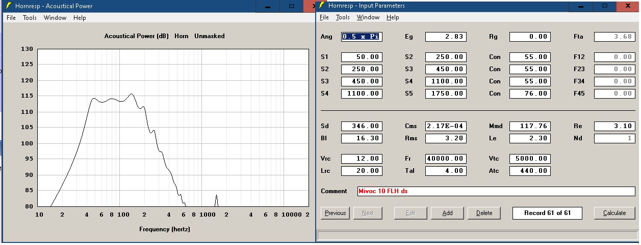

Hello,
Just saw this build, very nice!
I ordered a pair of Mivoc AWM104 (55euro/piece)mivoc AWM 104 - 10" Woofer
I will post later the schematic (i have to do some math 😀 )
But using the same Hornresp input data (just 1 Mivoc instead), the output looks promising. Corner loading.
