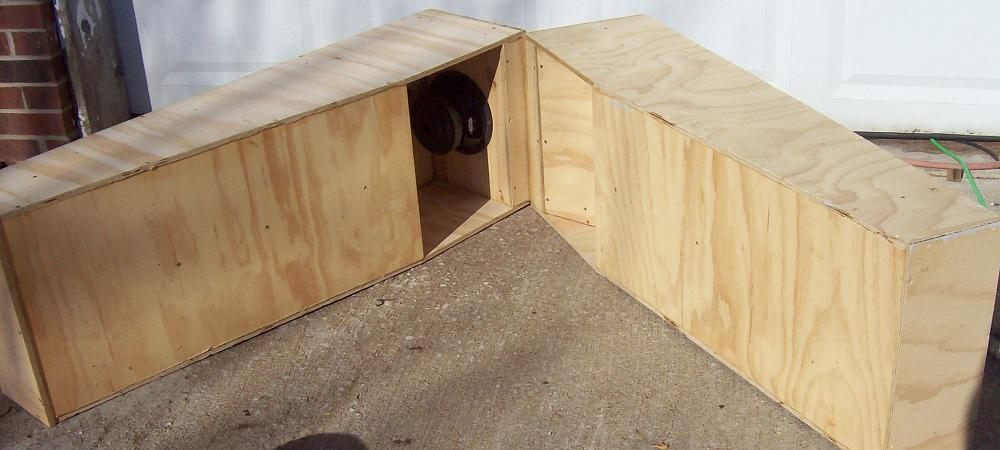

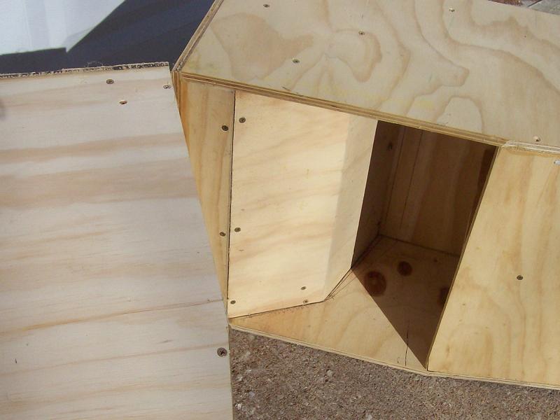

Jbell,
I thought you might like to see my adaptation of your bass-stick design.
I used the same MCM driver but made segment 2 and 3 slightly shorter, at 100 instead of 120. These will be used with four of the line arrays pictured. (It will result an 8 foot long line array on each side of the stage) The small change in height allows me to use the bass-stick cabinets as stands for the line-arrays in a room with 8 foot ceilings for smaller venues. I actually desired a response curve that extended upwards as I cross over at about 180Hz. I did not need response below 40Hz.
These will be used for PA use and to supply music for ballroom dancing. Their first public use will be in the ballroom at the local convention center for a black-tie formal dance. In my living room a single cabinet can easily supply enough volume. (I've been cautiously breaking in the drivers) With four cabinets I'm hoping I'll have sufficient bass to fill a gymnasium sized ballroom to 85+ dB levels.
I do not have the rear enclosure covers for the drivers in place yet to make them into true front-loaded-horns. I expect right now their frequency response is a bit ragged since their back-chamber cover is missing.
The bass-sticks easily exceeded my expectations in performance. I know what really low distortion high quality bass sounds like, as I have a pair of 18" Avalanche drivers in 12.5 cubic foot cabinets in my home theater. I did not expect an 8" driver to come close, but they really are impressive.

Hey JL, I hadn't thought about this thread for a LONG time.... I thought I'd add a bit of info for you on these so you can have success with them.
First they are designed so that by themselves, they are not a complete cabinet. They were modeled in hornresp assuming they were 'v-plated' aka, put in the below configuration and a 3/4" plywood plate bolted to the top, so that the cabinets, floor and plywood plate extend the horn length / mouth size.
For a gymnasium setup, find the middle of a concrete wall, set up the 4 cabinets in a single 'V' so that you have a mouth that is basically 32"x60" Set it up so that the mouth is facing the wall and is about 32" away from the wall. This will effectively give you something close to 1pi cabinet loading.
On the driver cover, yes you definitely want it, and it needs to be as small as possible. I attached a pic so you could see what I did. I basically joined a couple boards at what I thought was a reasonable angle. Then taped a piece of cardboard over the back of the magnet to set a small gap so the cover wouldn't touch the driver, set the angled board down till I thought it was appropriate, and drew a line. The cleats you need to install for the cover to attach to are obviously 1/2" below that line. Use window gasket foam to make sure it's air tight.
In terms of standing them up and putting a line array over them, I think that only works if you have corners. If you have a small enough room that you can put a line array in each of the front 2 corners, then put a bass stick under each one facing into the corner, I think that will work well as the corner will 'finish' the cabinet, ala k-horn.

I understood that when I started the project. In my own hornresp simulations I deleted the final segment of the horn to predict the response without it. (It still looks good for my intended use)Hey JL, I hadn't thought about this thread for a LONG time.... I thought I'd add a bit of info for you on these so you can have success with them.
I don't know if I'll ever need to generate that kind of SPL these things are capable of when stacked and configured as you described, but if I ever need to fill a gymnasium with sound for a younger audience, it is nice to know it can. I'm not sure I would have ever thought to face the mouth to the wall, but I can see how the wall would then act as the final reflector and horn segment.
Actually, they do not do too badly as shown in my picture. The floor forms one side of the final horn, and the standing cabinets the other side at 90 degrees. The four cabinets side-by-side result in a horn width of 72 inches by 44 inches high.For a gymnasium setup, find the middle of a concrete wall, set up the 4 cabinets in a single 'V' so that you have a mouth that is basically 32"x60" Set it up so that the mouth is facing the wall and is about 32" away from the wall. This will effectively give you something close to 1pi cabinet loading.
I described the first venue I'd be using them in as gymnasium sized... Unfortunately, the wall I'm setting up against is a 20 foot high folding accordion style wall that separates their very huge ballroom into 6 smaller spaces. We'll be using two of those ballroom spaces for our dance. The folding wall is probably not a great reflector at bass frequencies. It is most definitely not concrete.
The up side is that I'm not trying to provide high SPL, in fact, the bass-sticks will probably be loafing along most of the evening. My sound equipment is being used to supplement the "house" sound system, as it has very poor bass response being designed more for speech than music.
I'm more constrained by appearance and stage placement then the need for as loud and deep and even a response as possible.

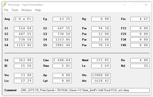

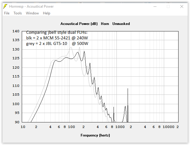

Hi Sublimacon,
As the JBL GT5-10 seems to still be on sale, I decided to see if I can fit two into a close approximation of jbell's fold here. A dual 10" w/ Xmax=12mm for $39.-- ea.. It'll be a few days, but I'll let you know how it comes out. I does look promising.
P.S.: epa does great work.
tb46,
I've used the classic series & various generations of GT's in auto installs. My bucket commuter car has a single GT15. Infinate baffle to the trunk, feed through a sloped plenum on the rear window deck. It's a little sloppy on the transients, but it causes >1/8" windshield flex front & rear on less than 400 watts. BTW, I've beat the crap out of that driver for years (mech-limit) and it just keeps ticking along!
So I got to admit, I'm rather curious to see the out come of your 10" experiment. In my experience the consumer JBL stuff has above average sensitivity, but not the strongest motors coupled with middle of the road Q's to work in sealed/ported/BP boxes. A compromise by design.
So with the SD of a 10" and a set of T/S not anywhere near optimized for horn loading. I'm not sure they'll be as awesome at 8:1 as the el-cheapo mcm drivers. If the OEM would of used an epoxy a little stonger than elmers-glue, they would of been golden!
I seem to remember a line of Goodwood (not a fan of that brand) that responded well to H/L, perhaps a 8" from them might be a low'ish cost upgrade from the fragile mcm's.

Hi Sublimacon,
After playing around w/ the GT5-10 in Hornresp it looked promising. There is not enough room for the S1 that this FLH/drive combination would require, but w/ a CR of 4.7:1 it can be made to work. This driver should be able to handle quite a bit more power than the MCM 55-2421, so that would help.
I'll attach where I'm at right now if someone is interested, or wants to build it.
Hi Sublimacon,
