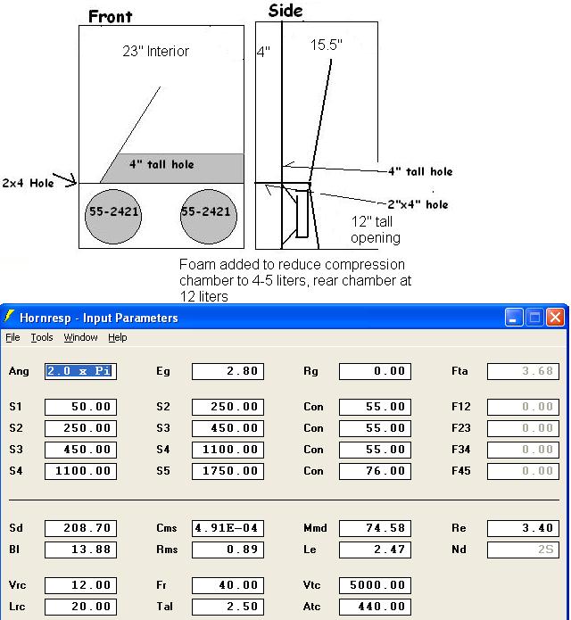

Well, I'm far enough along in my test cabinets, that I thought I'd create a thread for this.
I reformed by dual 55-2421 cabinet to end firing, moved the first horn path to center, instead of offset, and made it out of fresh ply, so it's 'to length.' VERY respectable numbers down to 43hz. No it's not flat to 40. but it's within a half step, so I'm happy.
The numbers aren't bad.. I especially like the very flat 103db through the 50's and 60's, a little dip in the 80's, and then off to the races as you hit low hundred's.
For $50 in drivers and 1.5 sheets of ply.. it's pretty respectable.
Measured C-weighted, corrected to flat, rounded down to nearest .5 db 2.83v / 1M / Drivers in series

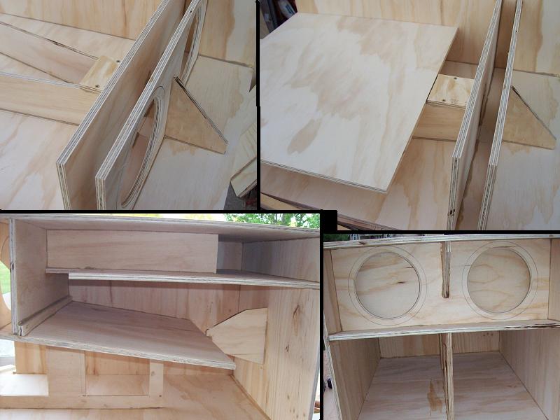

One interesting thing to note. I goofed up one of them, and didn't transition on the first flare correctly, and got an extra db at 66hz, vs the 2nd one that is basically flat. If you look at the pic above, you'll see what I did wrong... Not sure, but the extra db at 66hz almost seems like a bonus.

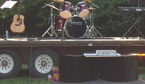

I thought I'd update this thread with last weekend's success.
A pair of these for outdoor events, seem to work very well.
zed14 and an xti1000 make for an easy set up.
flat to 40 is nice... very nice.

Here's my original test cabinet, and fold. I since increased the length a little to get me flat to 40, as well as reoriented the drivers 90degree, and took the suggestions to put the first horn section centered, instead of offset to the side.. I'll try to dig up some dimensions and pics if you're interested.
BTW, the 8:1 compression, no problems with 8" cones. I've had these cabinets wound up, and no issues, I'm pretty sure the small chiwaneese voice coil will melt down before I have a cone issue.

The key to this cabinet is the compression chamber.. change your sims by even half a liter, and things change DRAMATICALLY. (4-5 liters is where things look best)
I think you see what I did by the construction pics, and can reverse engineer from there.
from memory, here's how I assembled.
cut back, attach compression board. (compression board has a 2x4 hole in it) attach first horn path, use PL and screws to connect compression board to horn flare, and cabinet back. Attach 4"x4" ply on top of first flare. Then attach driver baffle. Attach one side, then cover first horn flare, then top. Install board that divides the last 2 flares. (I used a single piece of ply that went the entire length, driver chamber, compression, horn path) Install bracing, and front and last side. If front firing, make front 12" short for opening, if end firing, make front full length. The 'bottom' panel is full size of cabinet, and also seals rear chamber, so it's removable.
I'm sure there are other folding schemes that are more efficient that this.. but I wanted the weight of the driver at the very bottom of the cabinet, and I wanted the driver chamber easily accessible.
