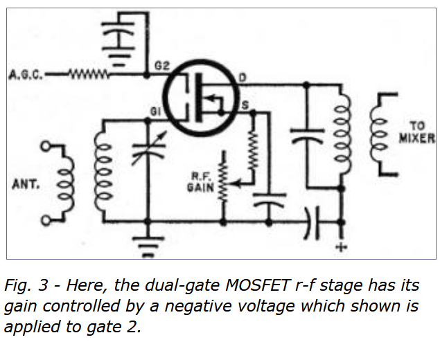

Here's one circuit where the gain is controlled by a second signal. Sounds like Amplitude Modulation to me.

The word "mixer" has quite different meaning in Radio and Audio.
Radio 'mixers' multiply (not always exactly).
Audio 'mixers' add (usually pretty good).
The multiplication can be a gain control. Or AM modulator. There are other ways to do these things. However radio front-ends does seem to be the main use of these things (before chip consumed that vanishing market).
