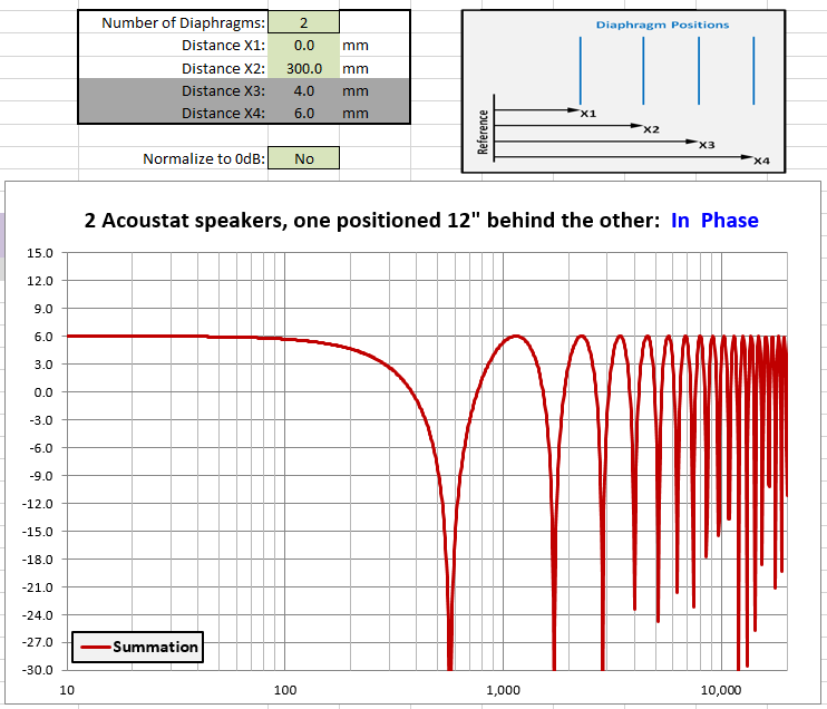

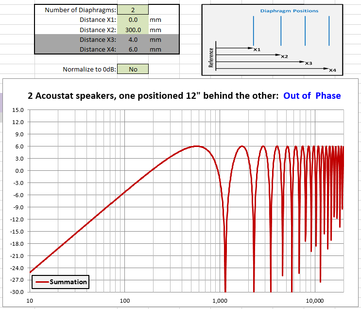

In case anybody is interested, Wrinex had started a thread where he was investigating stacking of multiple diaphragms in close proximity to each other. There was a spreadsheet posted that could be used to investigate the result of different number of diaphragms and spacings between the diaphragms.
http://www.diyaudio.com/forums/planars-exotics/272742-sandwich-esl-yummie-3.html#post4292045
Using that spreadsheet and estimating the distance between your two panels at around 300mm give the results shown in the attached pics. With the panels acoustically in phase you would get a 6dB bump in LF output, but midrange and higher is compromised with phase issues. Putting them out of phase results in substantial cancellation of output, which agrees with your comment back back in Post#3 “I tried them out of phase and that just sucks the life right out of the sound”

Thanks for that input. I think for my next experiment I may try a full isobaric trial. There's room behind the Monitor 3s to mount directly against them. I'm thinking to use foam gaskets firstly unbroken and then with gaps.
