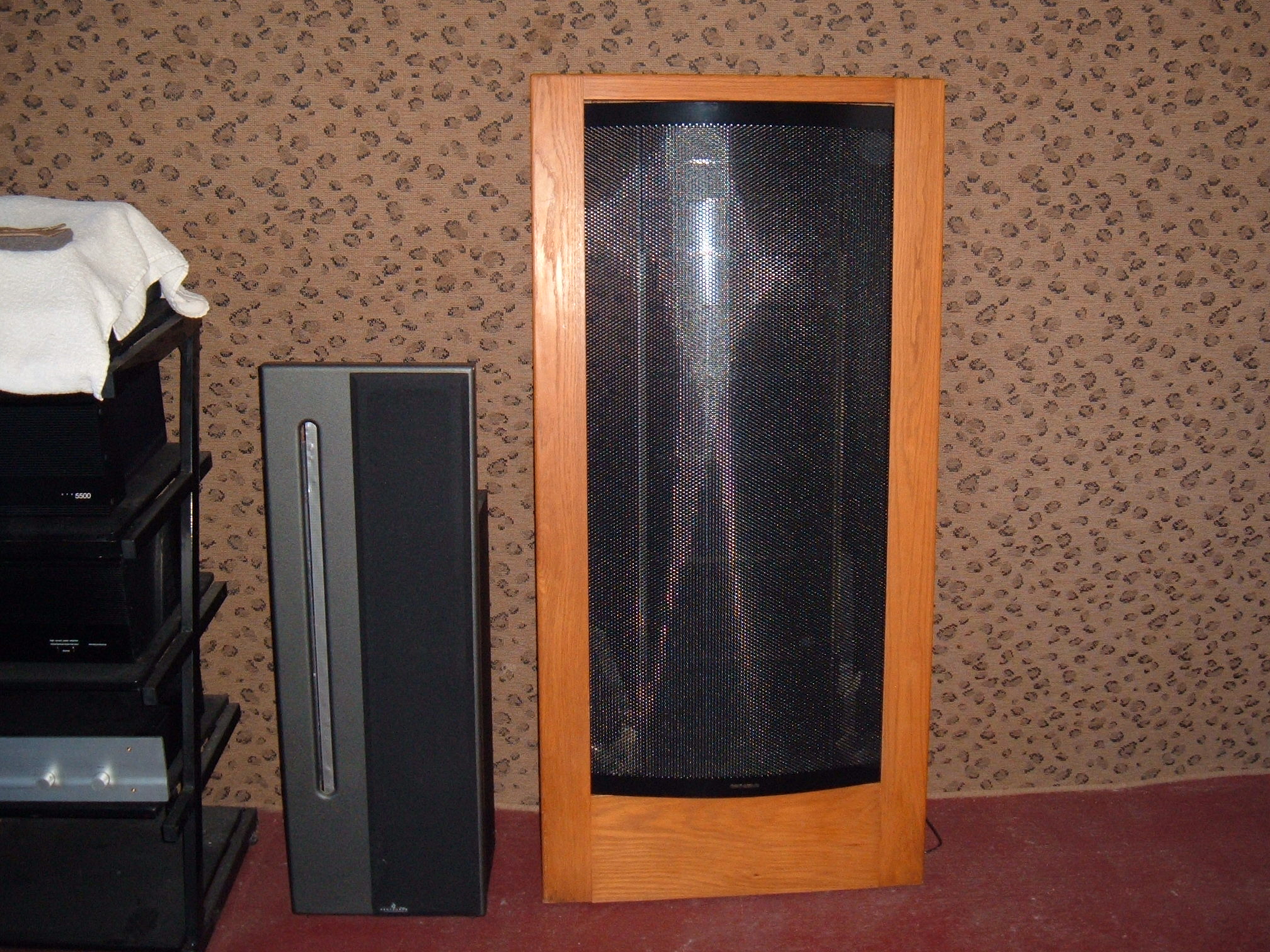

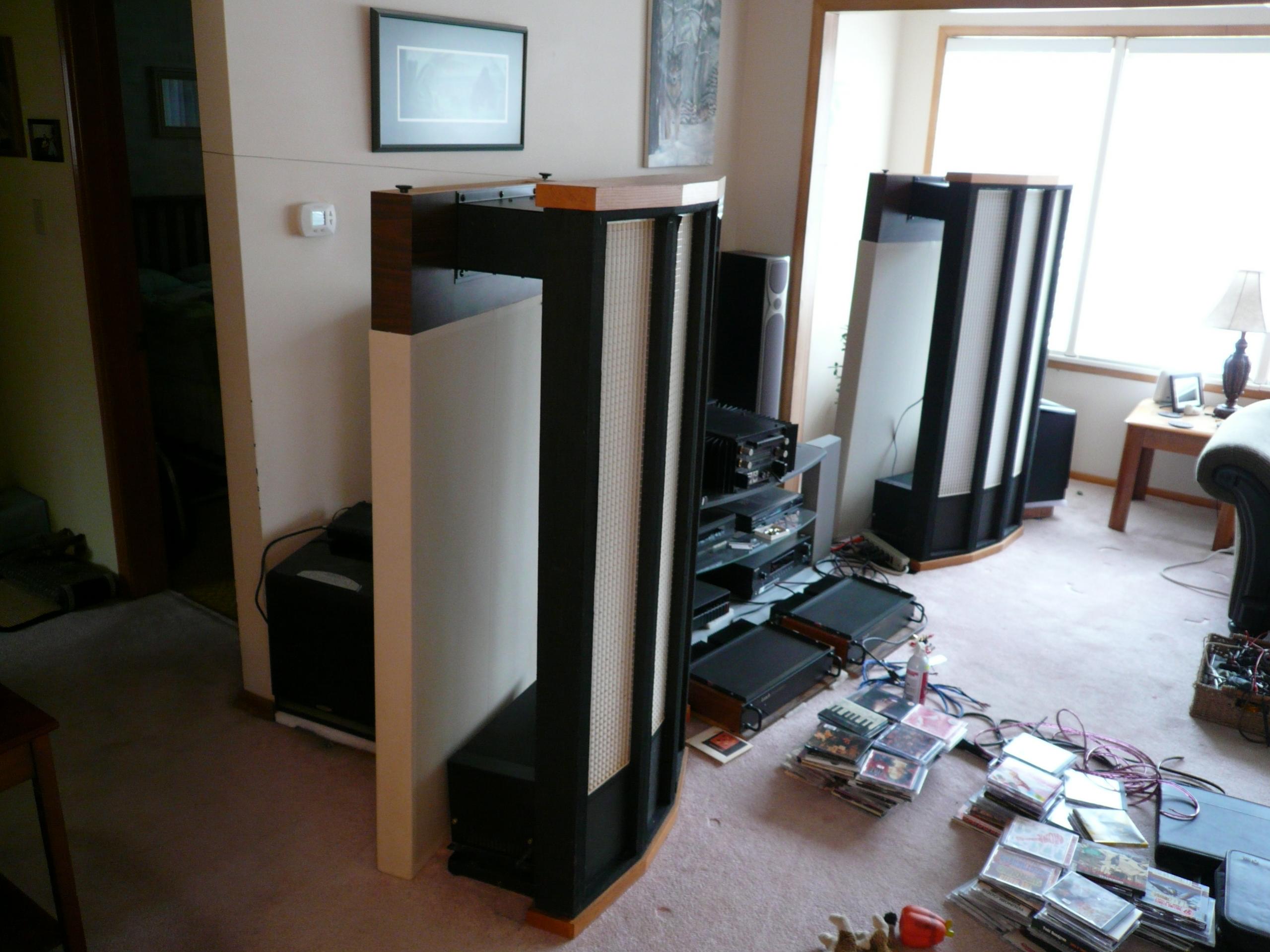

Disco Pete: Rob MacKinlay of ER Audio here in Australia was developing a dual layer stat panel along the principles of what you have jerry rigged with your Model 3 set up. He told me at the time it had great potential to strengthen the sound field of stats and give a positive result in the manner you are describing with yours. Not sure Rob proceeded with the concept though? It was a few years ago we discussed all of this ...
Steve.
I think what may be a factor is that the rear firing panels are powered separately.

Thanks for that input. I think for my next experiment I may try a full isobaric trial. There's room behind the Monitor 3s to mount directly against them. I'm thinking to use foam gaskets firstly unbroken and then with gaps.
Hey, I have 9 panels!🙂
Was the isobaric electrostat project ever realized? I had the idea to try it myself and came here and this post is the only one I could find. I thought of putting the Acoustat panels almost touching each other with seals that could be applied to the sides with a band that could be tightened.
If it's sealed, it should act like an air piston and have improved bass. I don't think there would be destructive interference because the two panels would be rather closely coupled. An isobaric 1+1 arrangement may be better than a 2+2 by having all the bass and pinpoint imaging with no combing.
