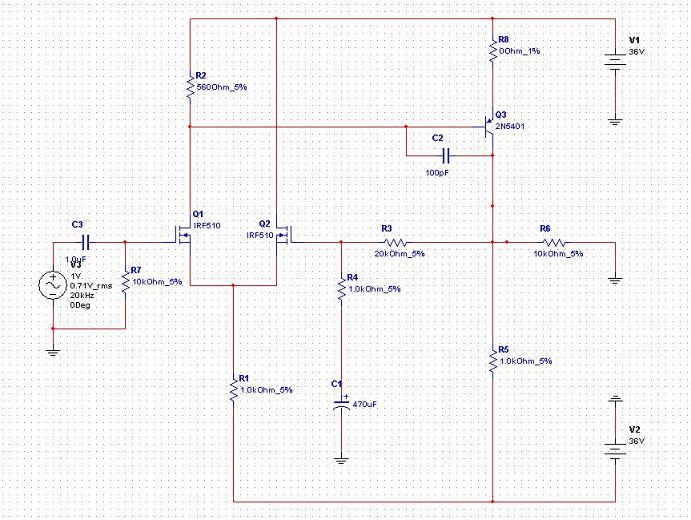

here is my implementation of the nelson amp.
this is an old project (on breadboarded and it worked). I also did a version with a source follower (IRF540) driving a hologen lamp 🙂)) as load (sort like a 10w power amp). and it also worked quite well.
the problem with this particular design is its quite large DC offset (100-200mv). I suspect that moamp may have similar problems so having some sort of offset adjustment mechanism may be a must.
this is what Nelson had to say about the use of a follower as the 3rd stage:
"the follower not only gives a lower output impedance, but makes the performance of the opamp less dependent on the load impedance. if you want to drive a lower impedance load, particularly a speaker, you will want some current gain, and very often you will want the 3rd stage".
http://www.passdiy.com/pdf/diyopamp.pdf
I tend to trust Nelson far more than others, especially those who had tremendous problems correctly capturing a <10 component soft start circuit in the lm317 datasheet.

"yeah. I am sure the Pass DIY OpAmp then doesn't work right by your definition. Some kind of "advice""
It wasn't advice it was satire. Go read the post again....... It was aimed at P-A and I think he understood the point I was trying to make. I guess I have to put warnings in for the humor impaired.
I have no problem with common source or common emitter output stages. One should be aware that the open loop output impedance and open loop gain are determined by the load resistance in parallel
with the feedback resistance. I can't quite grasp your point about Nelson's statement about followers. The circuit under discussion (and similar topology in the Passlass active crossover that inspired all this) has no follower output stage. Trying to leave some wiggle room as to which of the approaches you would take?
Concerns about DC offset in circuit with a monolithic transistor pair with low offset voltage (read data sheets for jfet pairs), in a circuit intended for use at low DC gains, mystifies me and perhaps you can elaborate on the reason for this.

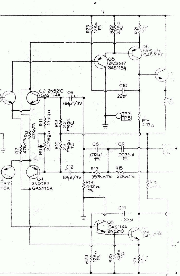

Just observing sonnya's design. It's amazing. Without the output stage (just the differential+folded cascode+current mirror) it should have worked fine as a SINGLE STAGE OPAMP, wouldnt it? The gain comes from differential only.
I think most of the gain comes from the current mirror loading the folded cascode.....
Folded Cascode Design
Hi lumanauw,
Maybe Sonnya's circuit was inspired by the AD817 datasheet or AD797.
Sonnya's circuit has made it to one of Gromans sites:
http://c213-100-118-115.swipnet.se/LM4780/DiscreteOPamp-sonnya.gif
AD817 here:
http://www.analog.com/UploadedFiles/Data_Sheets/289066266ad817.pdf
Hi lumanauw,
AD817 here:

it wouldn't be difficult to add a follower (as Nelson had suggested) to drive low-impedance load.
Alternatively, you can use a power bjt or mosfet (my preferred method) and turn up the idle current.
in the schematic I had posted, I have used irf9540 as Q3 and it drove real life speakers without any problem.
there is nothing foundamentally there in the topology that prevents this thing from driving low-impedance load.
tiroth said:Output impedance at 10 ohms is very low with respect to most reasonable uses...
