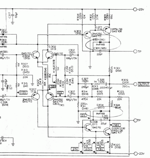

Very interesting project, and
very nice work Tiroth.
I wondered if you could shine your light on the performance of this design.
How does it for instance compare to an OPA627 or AD8065.
Do you have an idea how long the Wiki-page will be open for ordering these boards.
Thanks Henk

Thanks Calimero! The best person to comment on the sound is moamps, as he designed and built the original circuit. I don't yet have any 2SK389 on hand to comment, but I expect it is quite special.
The wiki "preorder" will go on for about a week and a half more, and then payments for a week after that.

IMHO, a discrete OPAMP sounds better than ordinary OPAMPS like TL, NE, OPA .... This opamp (the term itself might be misleading in a way, though) has a small open loop gain, small bandwith and relatively high THD (0.02%). But, it has only two stages and works in class A. I reckon this would suffice for this particular application.
OPAMPS with high bandwith, high open loop gain, minor distortion remind me of many 1970s amps - great specifications and crapy sound. 😀
I haven't tried OPA 627 and AD8065.
(too many zeros in specifications, I don't need an XVGA buffer 😉)

"The best person to comment on the sound is moamps, as he designed and built the original circuit."
Nelson Pass actually designed the topology and provided some implementation help for those who want to build such a circuit.
http://www.passdiy.com/pdf/diyopamp.pdf
While a bipolar second stage is great for repeatability for fixed bias resistor values, I wonder if the mosfet second stage might sound better for those willing to adjust the circuit for different values for the gate to source turn on voltage for the mosfet. maybe not practical for a production circuit, but not to hard for DIY small quantiities.

Too simple
Hi, the circuit is really too simple!
You cannot expect quality from that.
The 2SK389 is a large geometry FET with big capacitances. Now what are you going to do about it?
Lay it on the line!

Elso........... I assume you are funning us. With in the limitations of a reasonably low closed loop gain and driving reasonable impedances, >5K or so and reasonable cable capacitance, the circuit will work fine. One could lower the drain load resistor and increase the jfet bias current or even cascode the jfets if one wanted less input capacitance.
The only thing I might add is a small output resistor to isolate cable capacitance a bit.

Fred, No I am not funning but maybe I am raising the bar too high.....I have built circuits with the 2SK389.....I have an idea how it sounds but not how it measures. Nelsons article is a nice appetizer, but only a start.
I did not lick the blue frog or I would be dead by now. Yes you used the right icon: cannotbe. The blue frog is known for its arrow point poison. What I am doing in Papua New Guinea? Collecting frogs perhaps?

Is it good to have a high impedance output in this opamp appplication? This will create a very sensitive amp against load variations. The gain will variate with load. Why not add an output stage like all normal opamps have?moamps said:Hi,
If the discrete opamp is going to be used in Jens's board, some parts can be left out. R10 is necessary for DC stability and can be soldered directly onto the bottom side of the motherboard (from pins 1 and 7 to the ground), and an additional ground wire isn't necessary.

The question brought up if an output follower of some sort should be appropiate is interesting. James Bongiorno had a similar circuit for the Thaedra phono amp, that is without followers. Later in version II he added followers. I will try to find the schematics.😎
I doubt the output impedance is high because of feedback in moamps and James' circuit.
