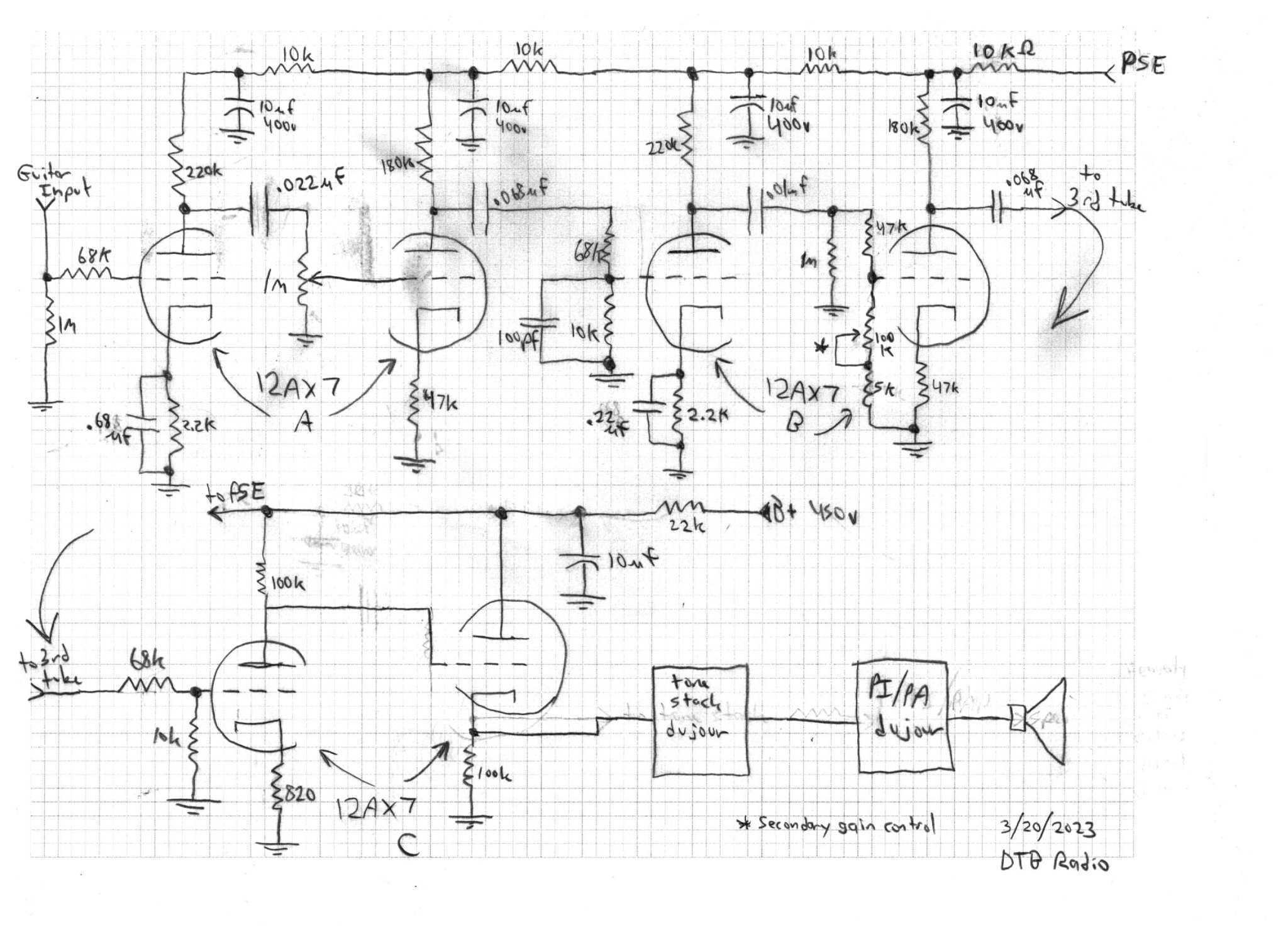

I'm toying with the idea of building a high-gain amp with two cold clipper stages in order to get more asymmetrical clipping and harmonics. The second clipper will be preceded by an attenuator and a typical gain stage to keep the clippers in phase with each other. Dual cold-clipping may have been done before, but I haven't seen any dual-cold-clipper circuits in any amp schematic I've come across so far. Before I do any actual building, I'd like your thoughts, good/bad/indifferent, on the idea in general, and on my preliminary circuit design (schematic attached below). All input is welcome and valued!

In any case, two cold stages have been used in many amps (CAA/CAE and many others), and in most of Guns’n’Roses albums, but usually one after the other, and way less cold than yours.
For an high gain guitar amp, I’d cut alot more lows on first stages.
Have fun!

@zintolo: If used one right after the other, you lose the asymmetrical clipping, IE both top and bottom get clipped. I only want the bottom to be clipped to maintain asymmetrical clipping, hence the extra gain stage to flip the signal back 180 degrees before clipping again.
I definitely appreciate the thoughts so far, hoping for input from anyone who has already tried this idea in this way (if someone has).
