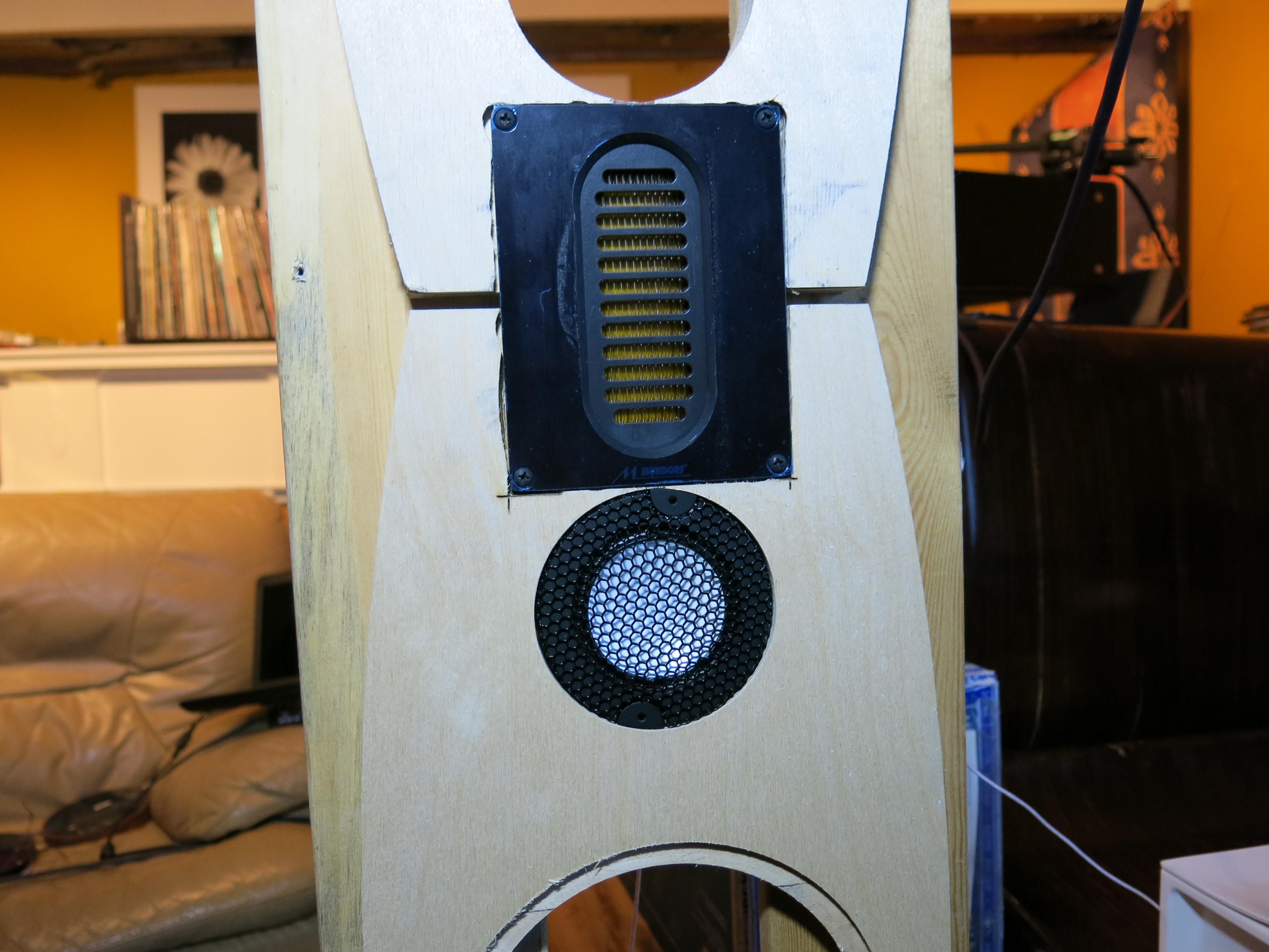

Picture 1) Erik, this is for you. How's that for a makeshift thrown together test baffle? No laughing please!

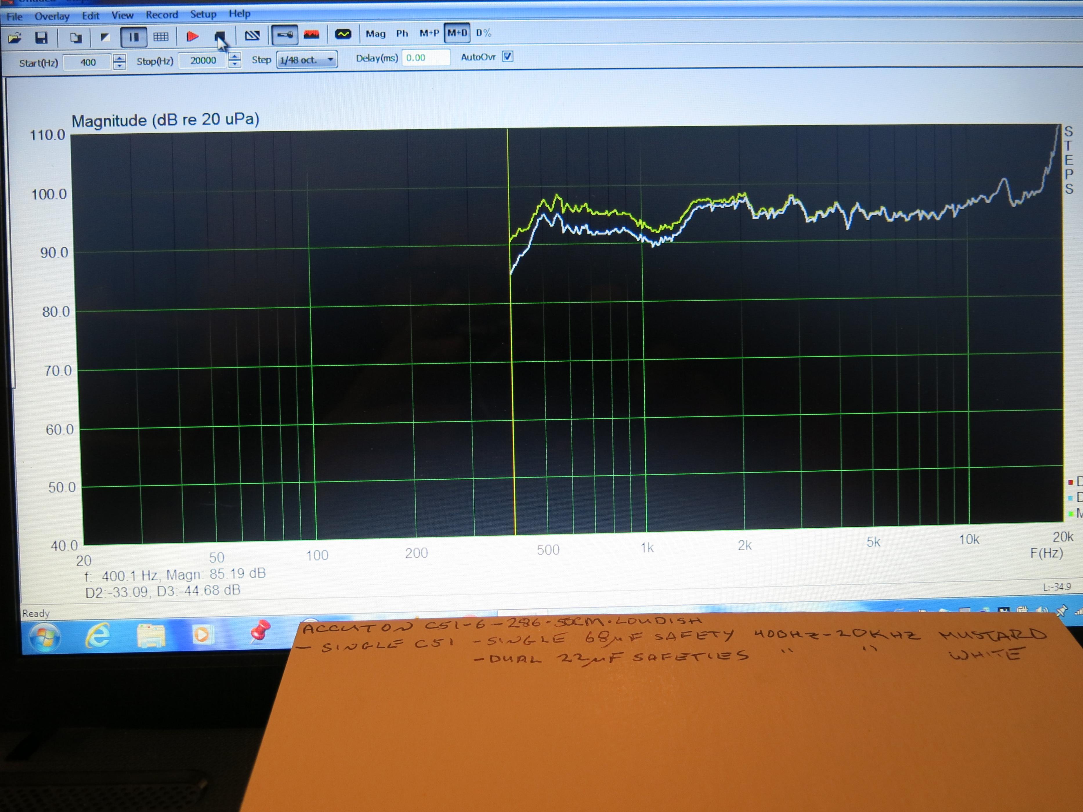

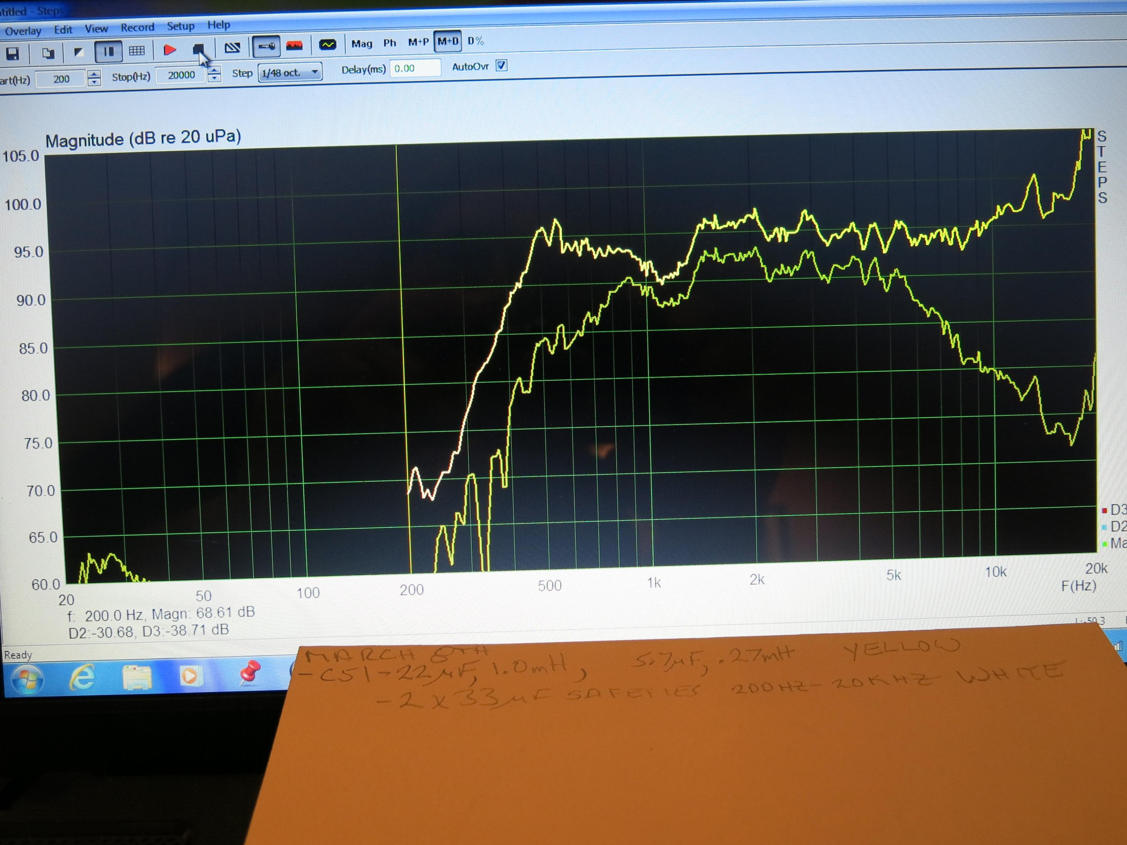

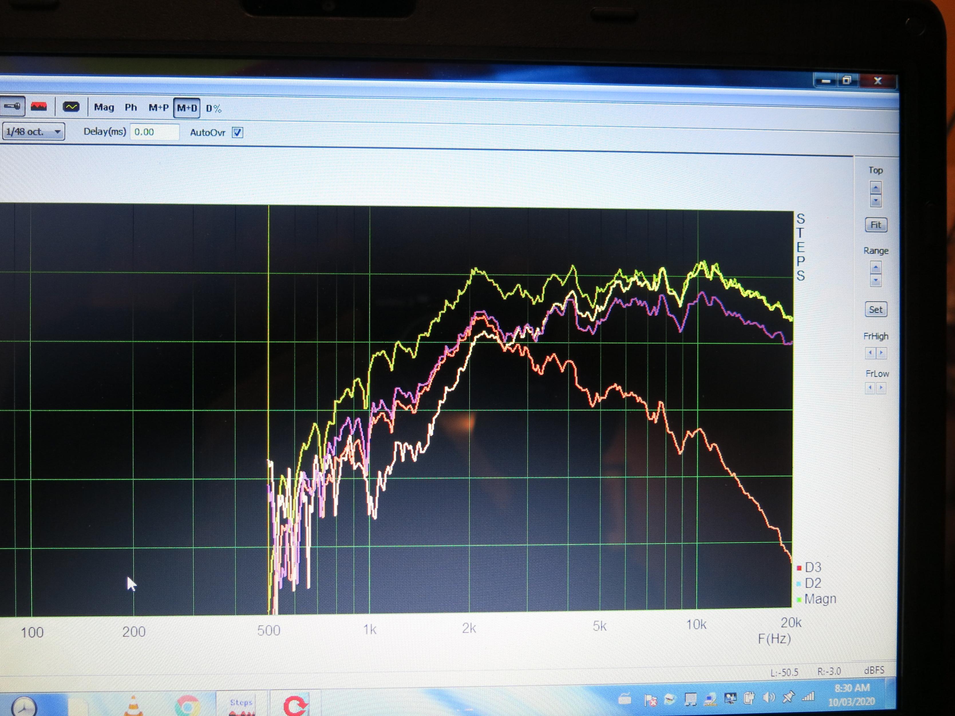

Pic. 2) first frequency response measurement, straight out of the box. Single 68uF safety

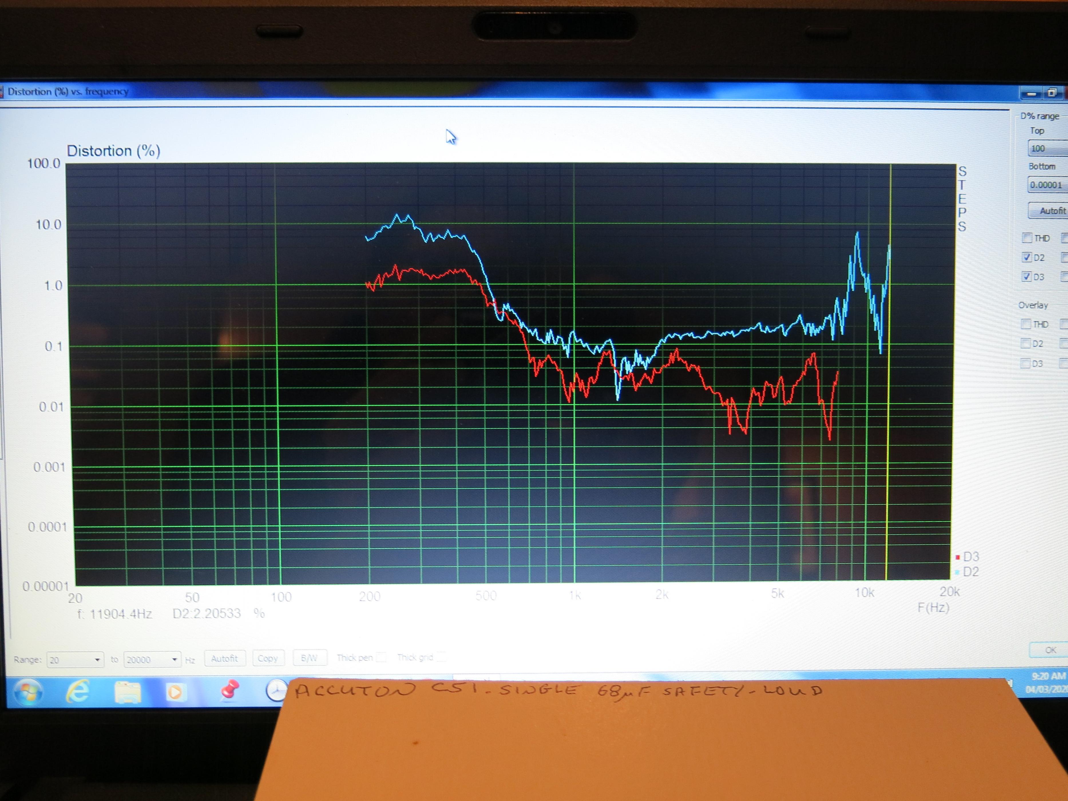

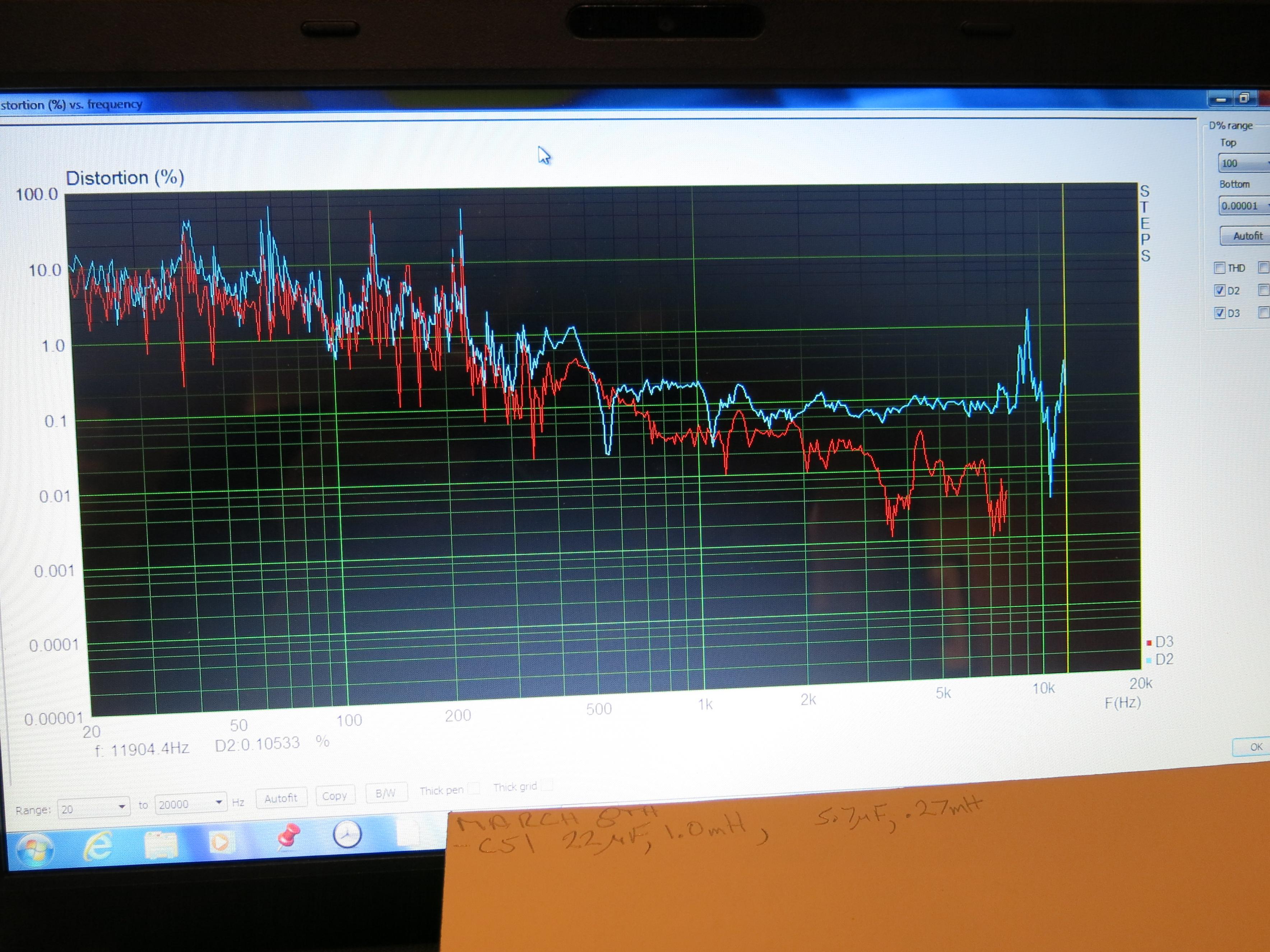

Pic. 3) distortion. At first glance, I'd say usable range is 800Hz to 5KHz. There's a bump in D3 at 7K, and a bump in D2 at 9K.
Pic.4) FR with two 22uF safeties. This will likely be close to the value used for the final crossover. The driver is well behaved, so I started at 400Hz.

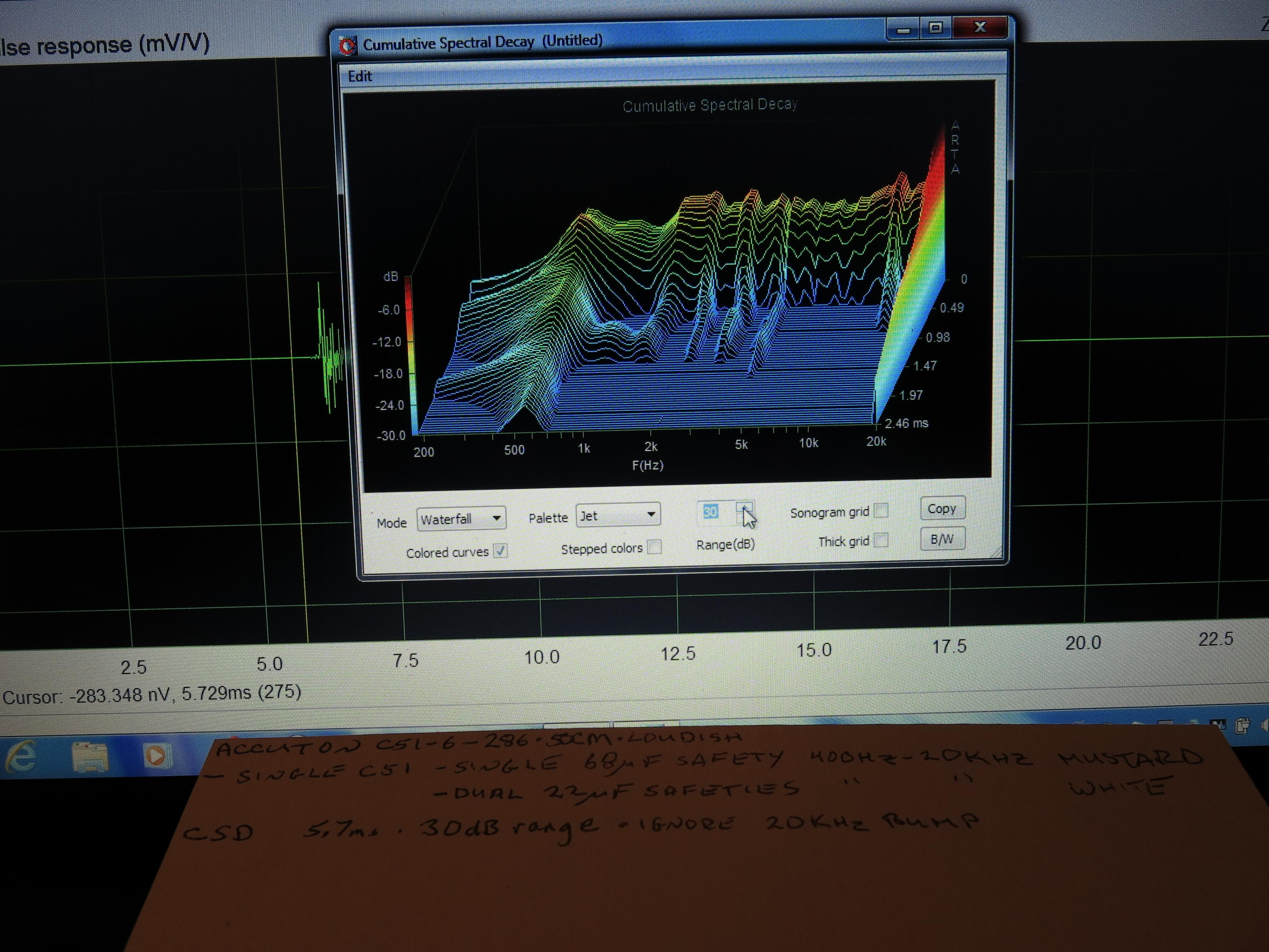

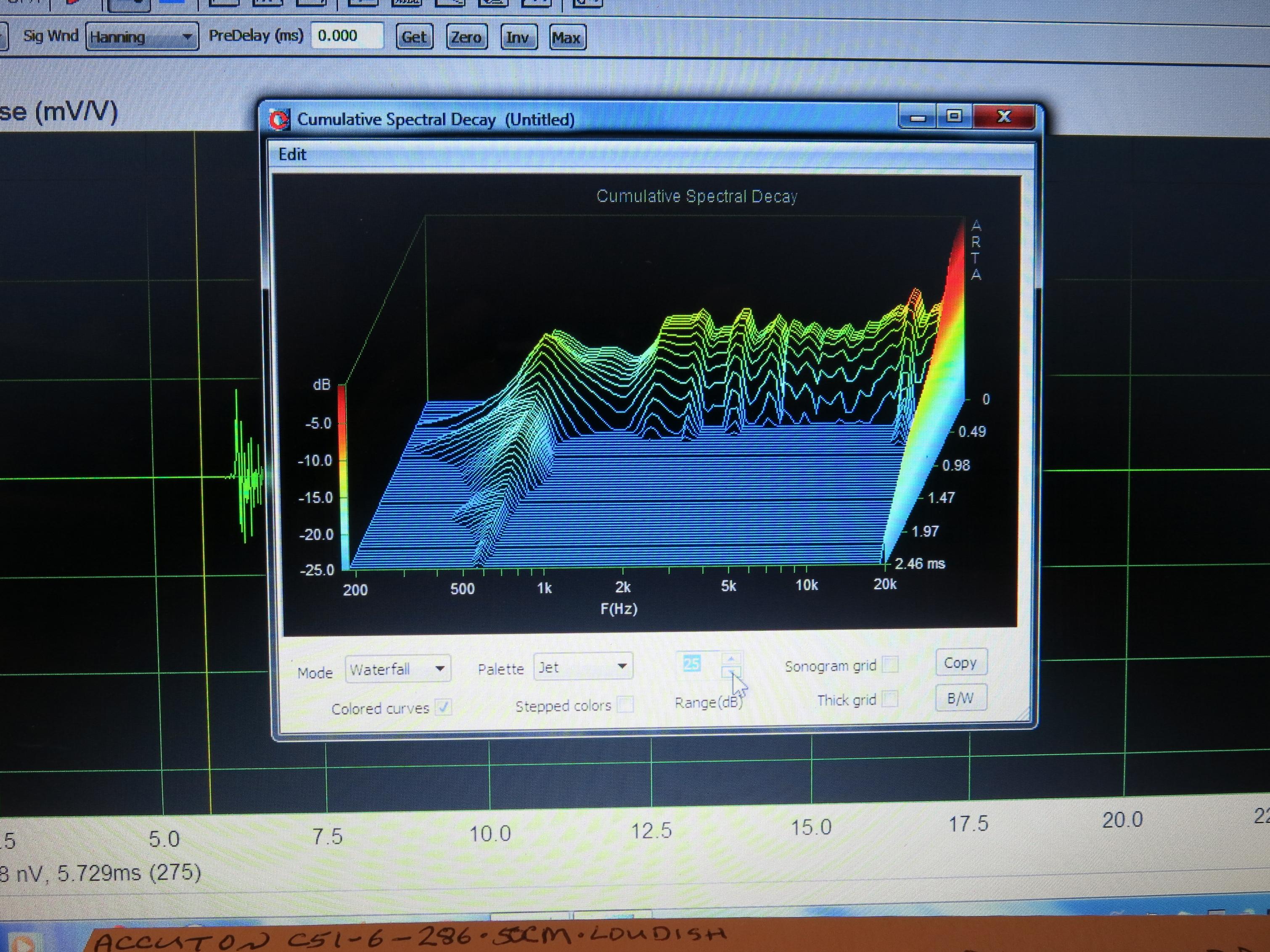

Pic. 5) CSD. From 1K to 5K it's pretty nice. I have something going on with my Focusrite, ignore the bump at 20KHz. The default range of Arta is -25dB. This doesn't tell us enough.
Pic. 6) CSD range now -30dB.

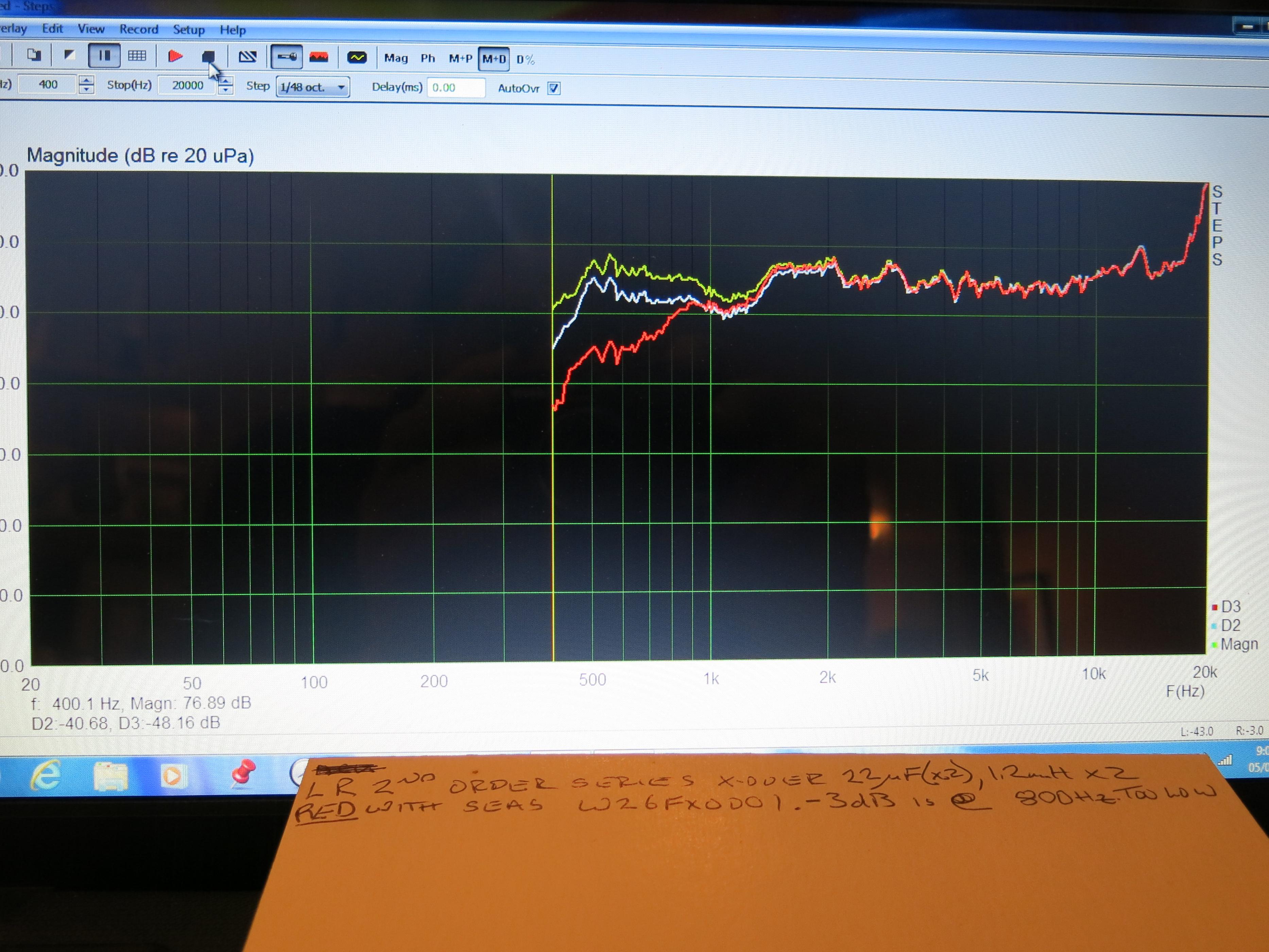

I have a SEAS W26FX woofer in house. I'll use it for a makeshift L-R 2-way Series crossover, cap. 22uF, inductor 1.2mH.
Pic. 7) frequency response. The -3dB point is around 800Hz. For me this is too low. Tomorrow I'll try 1.0mH.
Pic. 8) CSD with woofer. -30dB. The free air resonance around 500Hz is mostly gone. I really like this midrange.
The Mundorf AMT 25CS2.1-R measurements went well. Let's see if I can mesh them to the Accutons. I'll need a lot of help figuring out how to physically time align them. But first some base measurements.

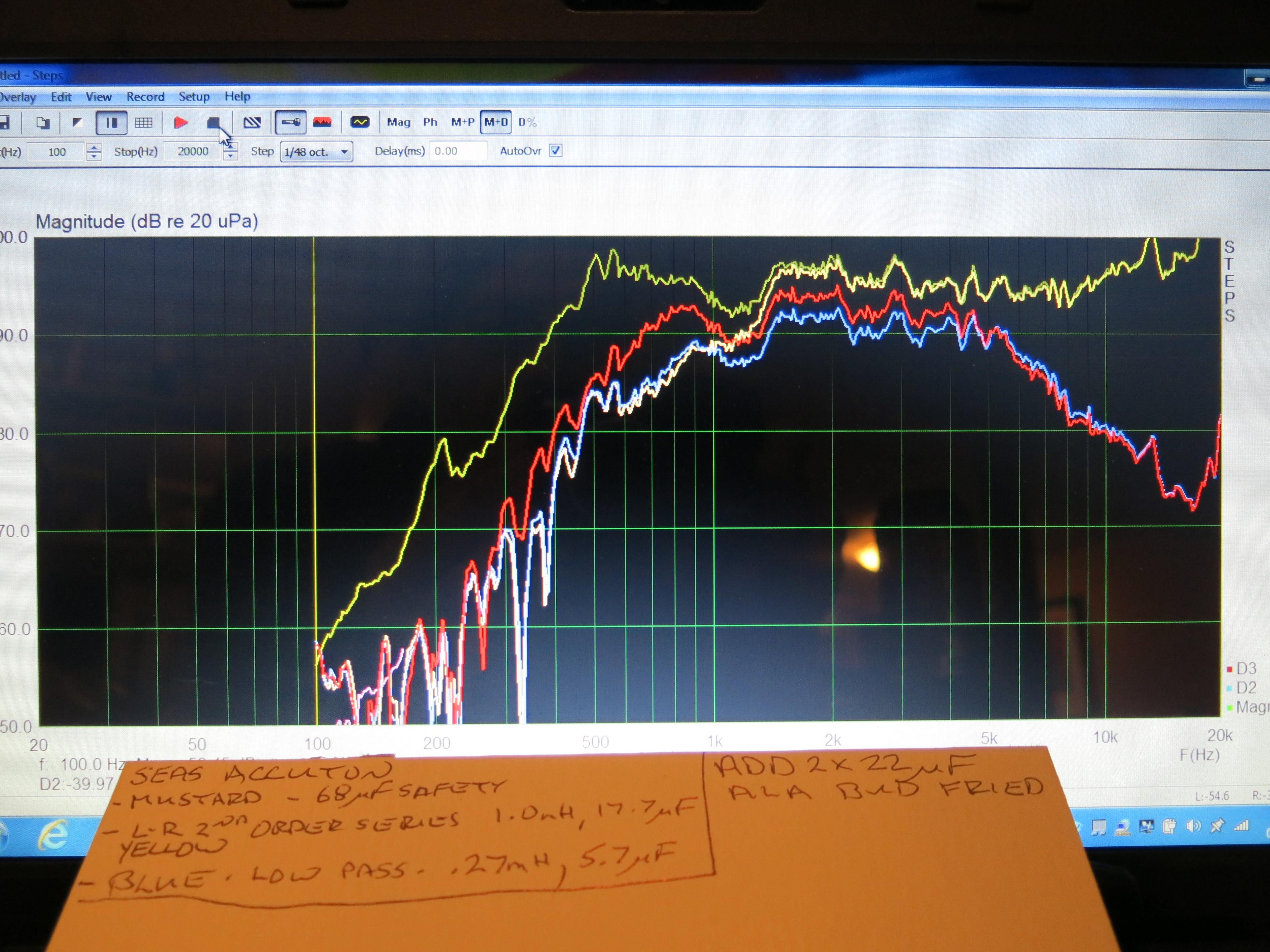

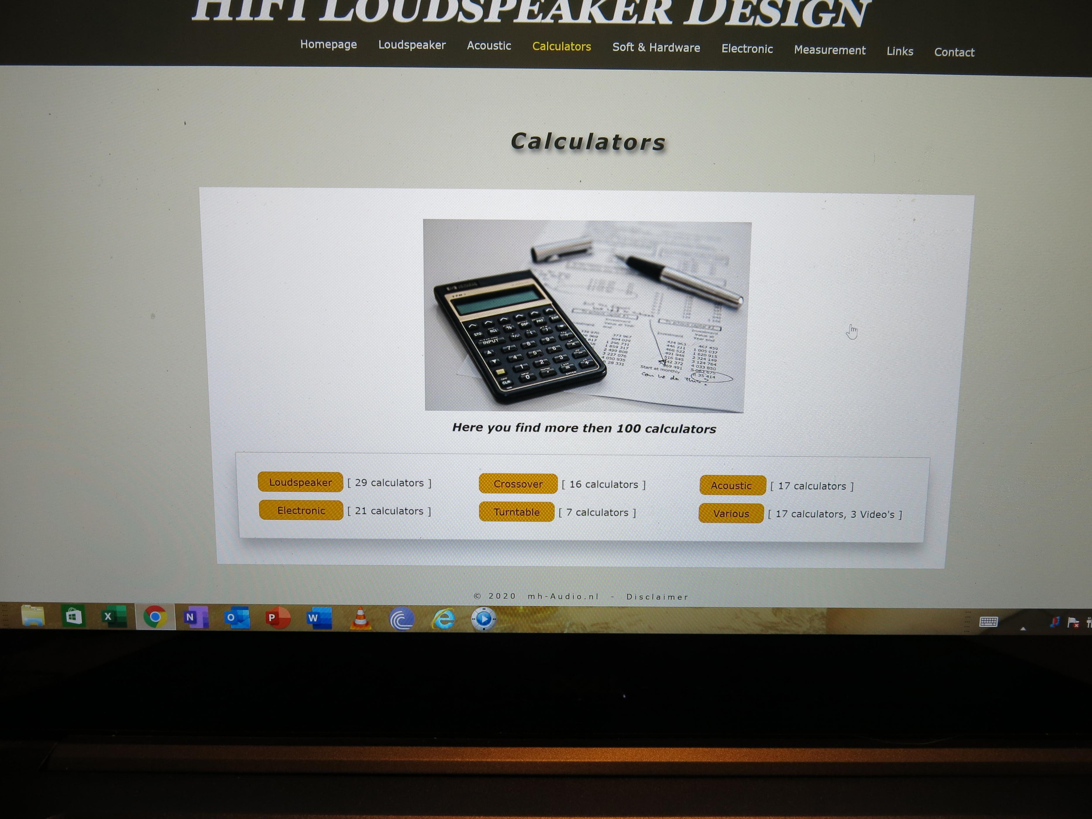

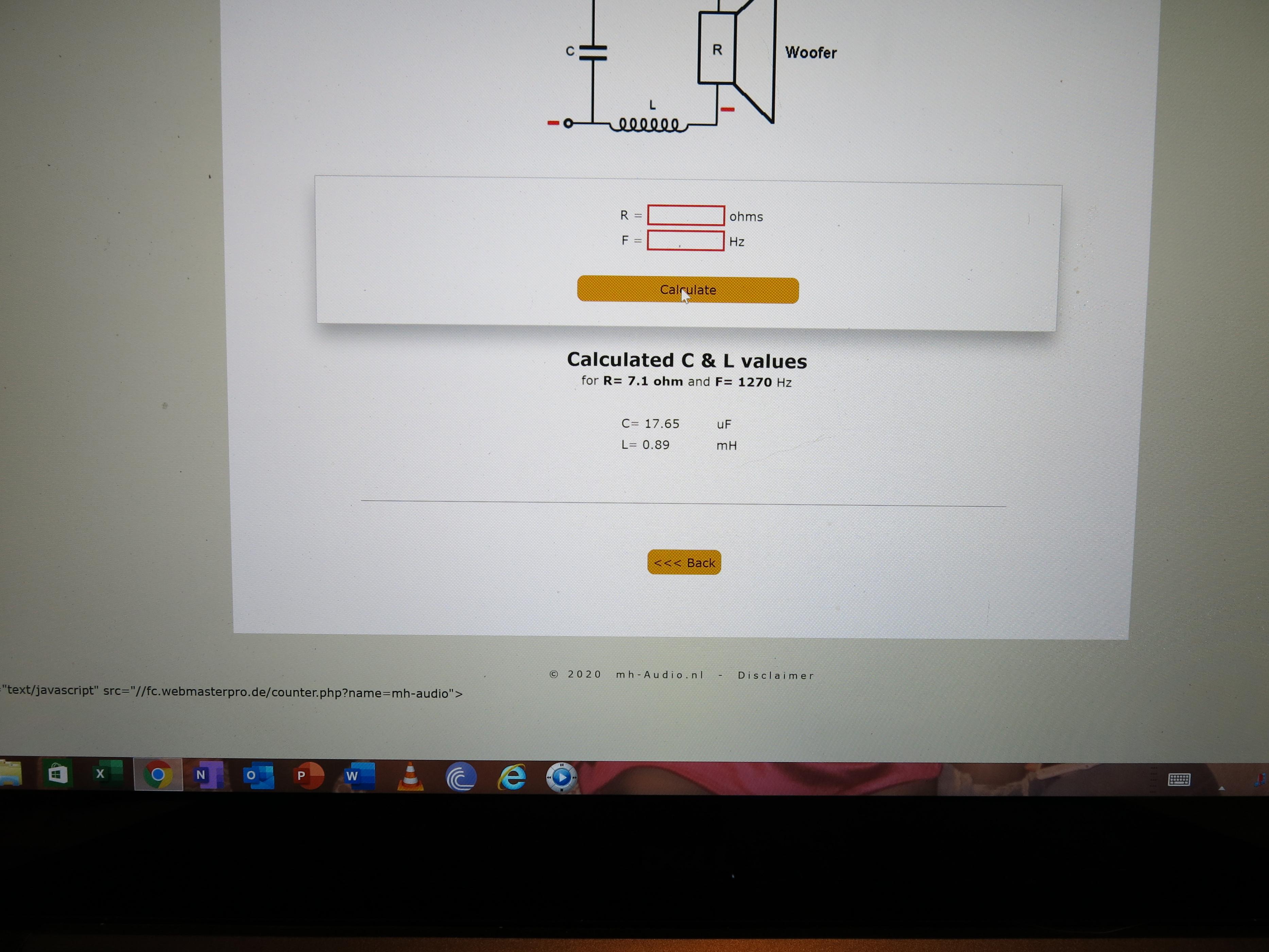

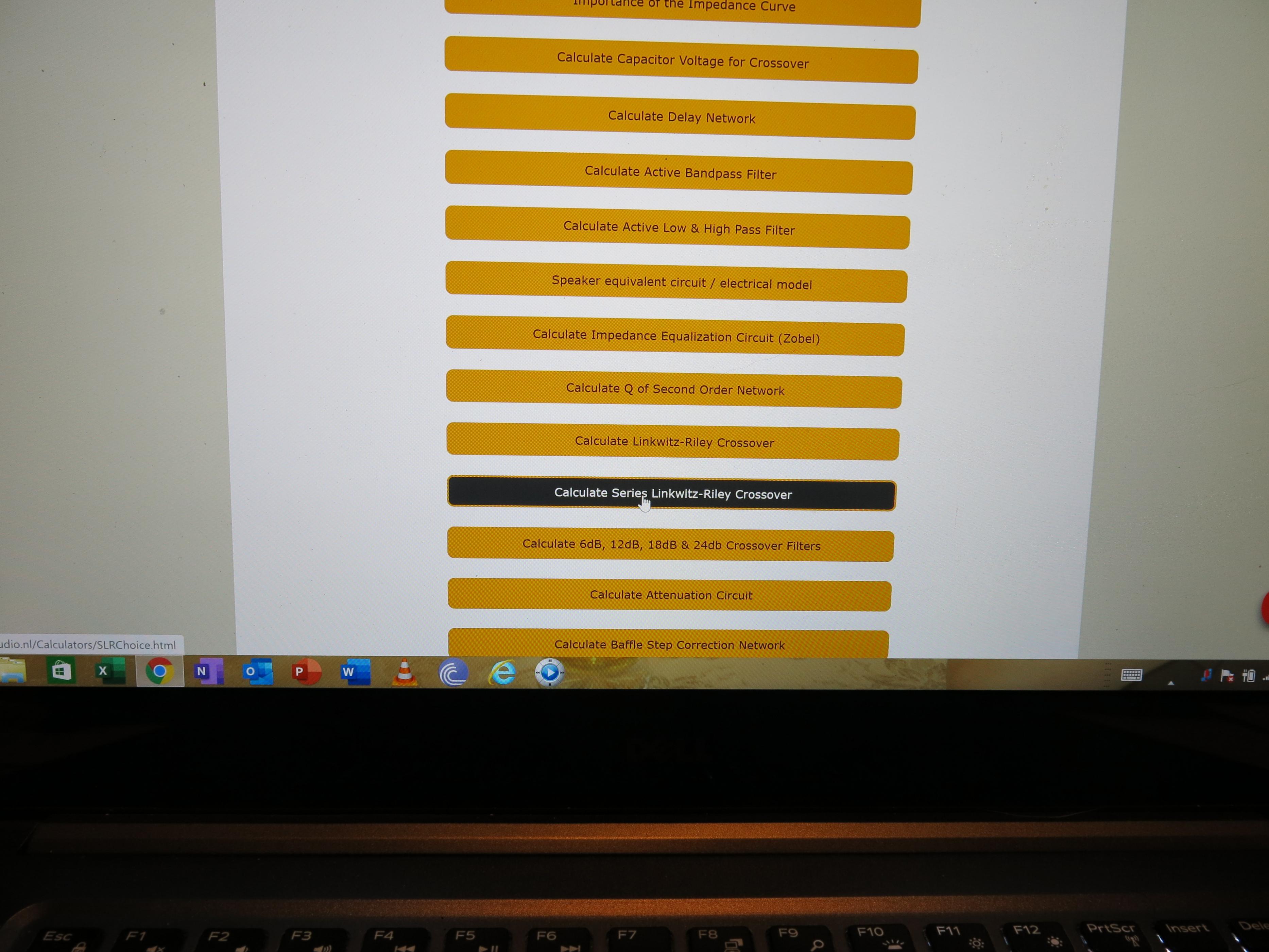

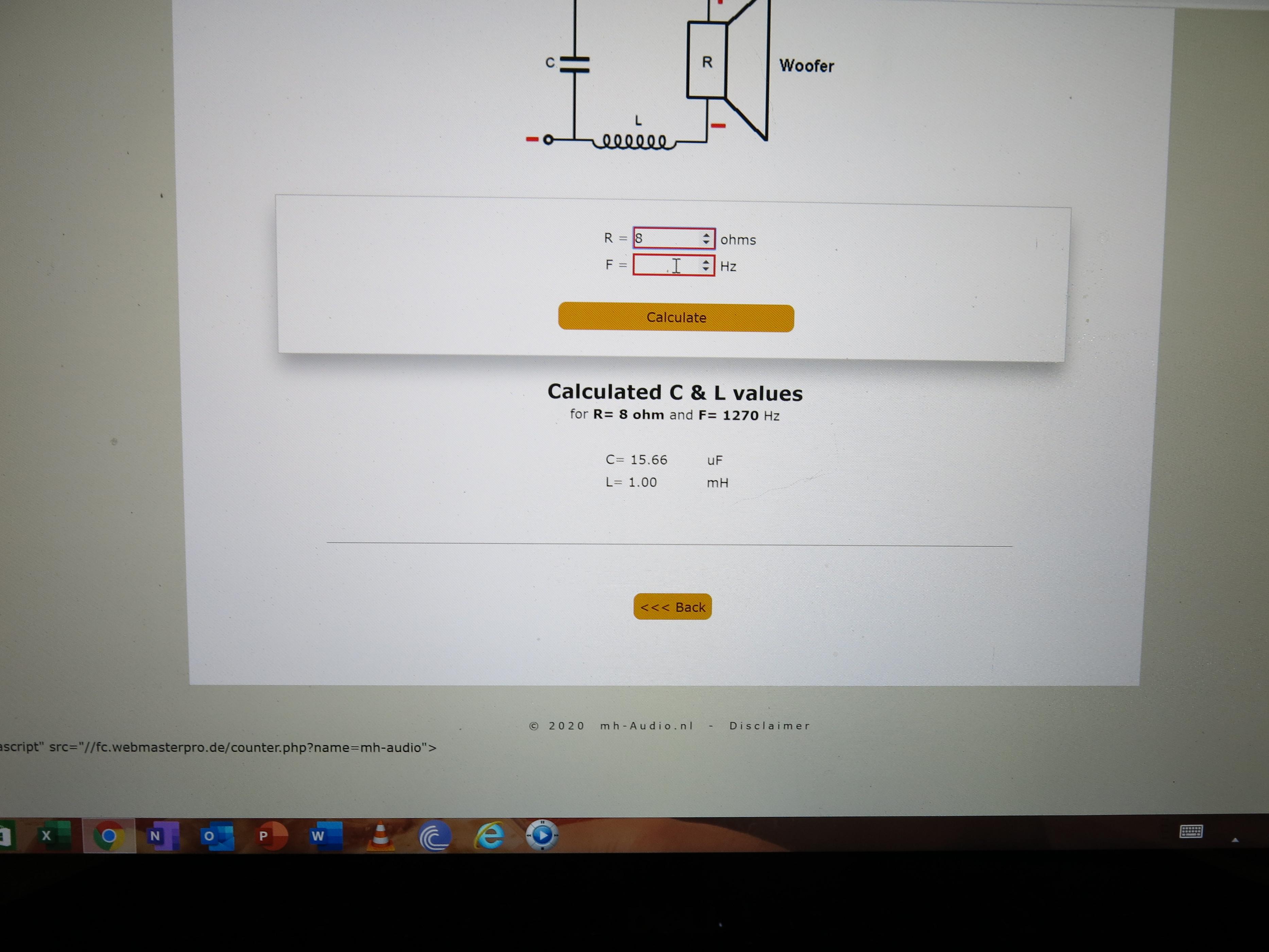

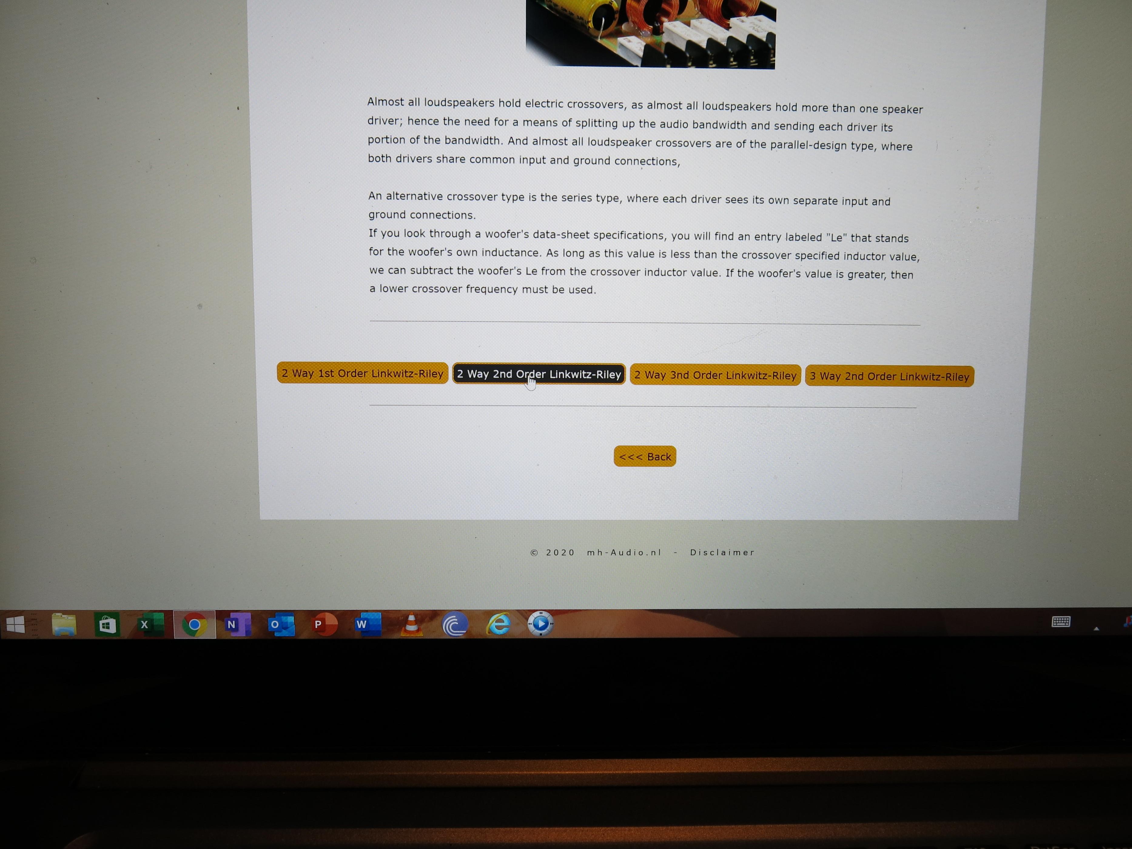

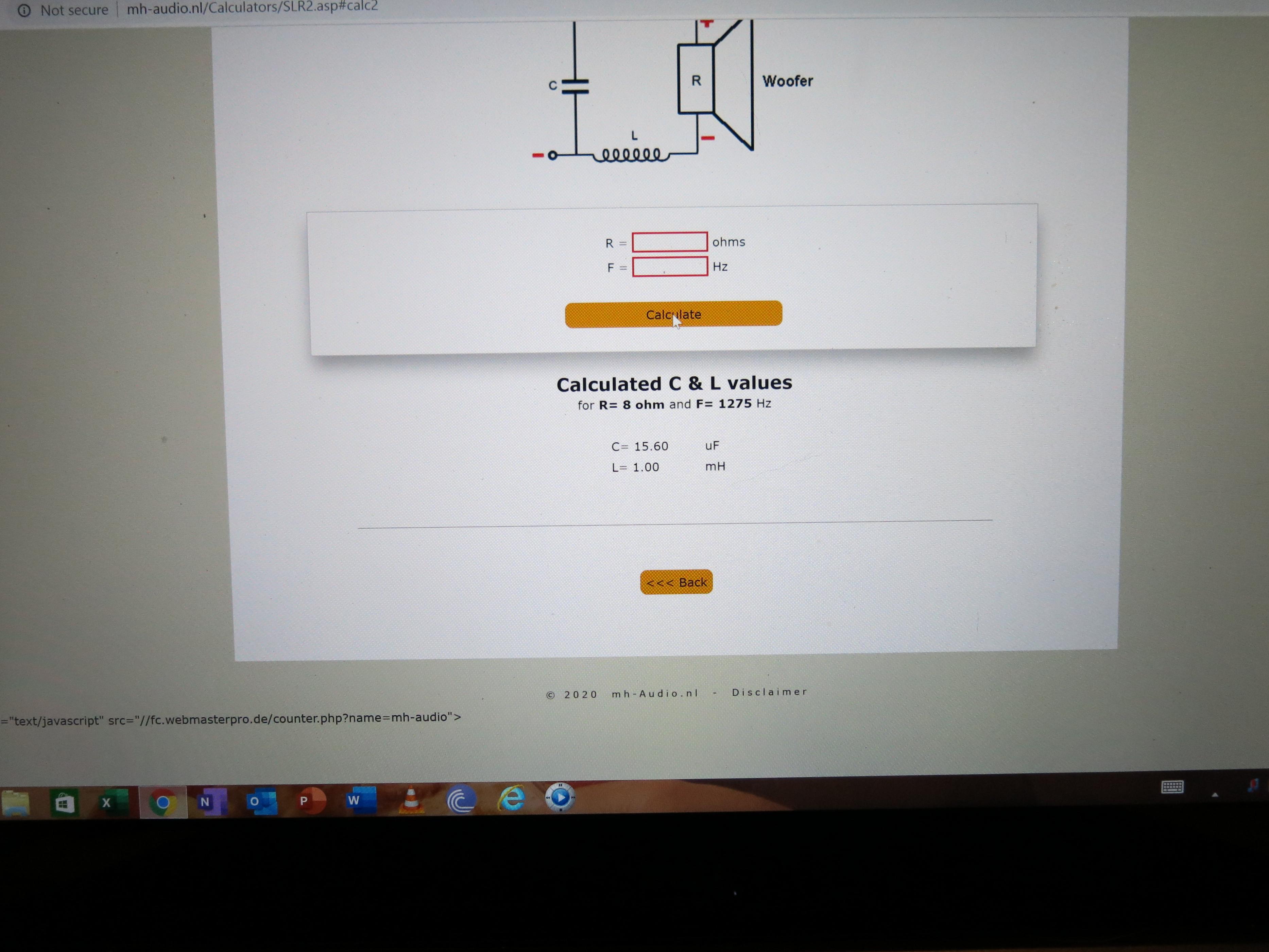

How do I find my L-R 2nd order 2-way Series crossover values?
1) I go to HiFi Loudspeaker Design . I choose 'calculators'
2) at calculators, I choose 'crossovers'
3) at crossovers, I choose 'Series Linkwitz Riley'
4) at L-R, I choose '2nd order 2-way'
5) I start to play. I am ONLY looking for an inductor value. This is the low pass for the SEAS W26FX woofer, at 8 Ohms. At approximately 1000 Hz it's 8 Ohms. I fiddle with different frequencies until I arrive at the wanted 1.0mH inductor value.
6) 1270Hz looks about right.
7) 1275Hz is also good.
But, but, but, I ignore the capacitor value. The value given is for 8 Ohms. The capacitor is the 'high pass' for the Accuton midrange. The midrange is NOT 8, but 7.1 Ohms. I go back to the 'boxes'.
8) the frequency of 1270 is set, that stays. The new impedance is 7.1. My new capacitor value is 17.65 uF. I ignore the new inductor value of .89mH.
9) the frequency response. Mustard is with a single 68uF safety cap. The yellow is with my L-R series crossover in place.

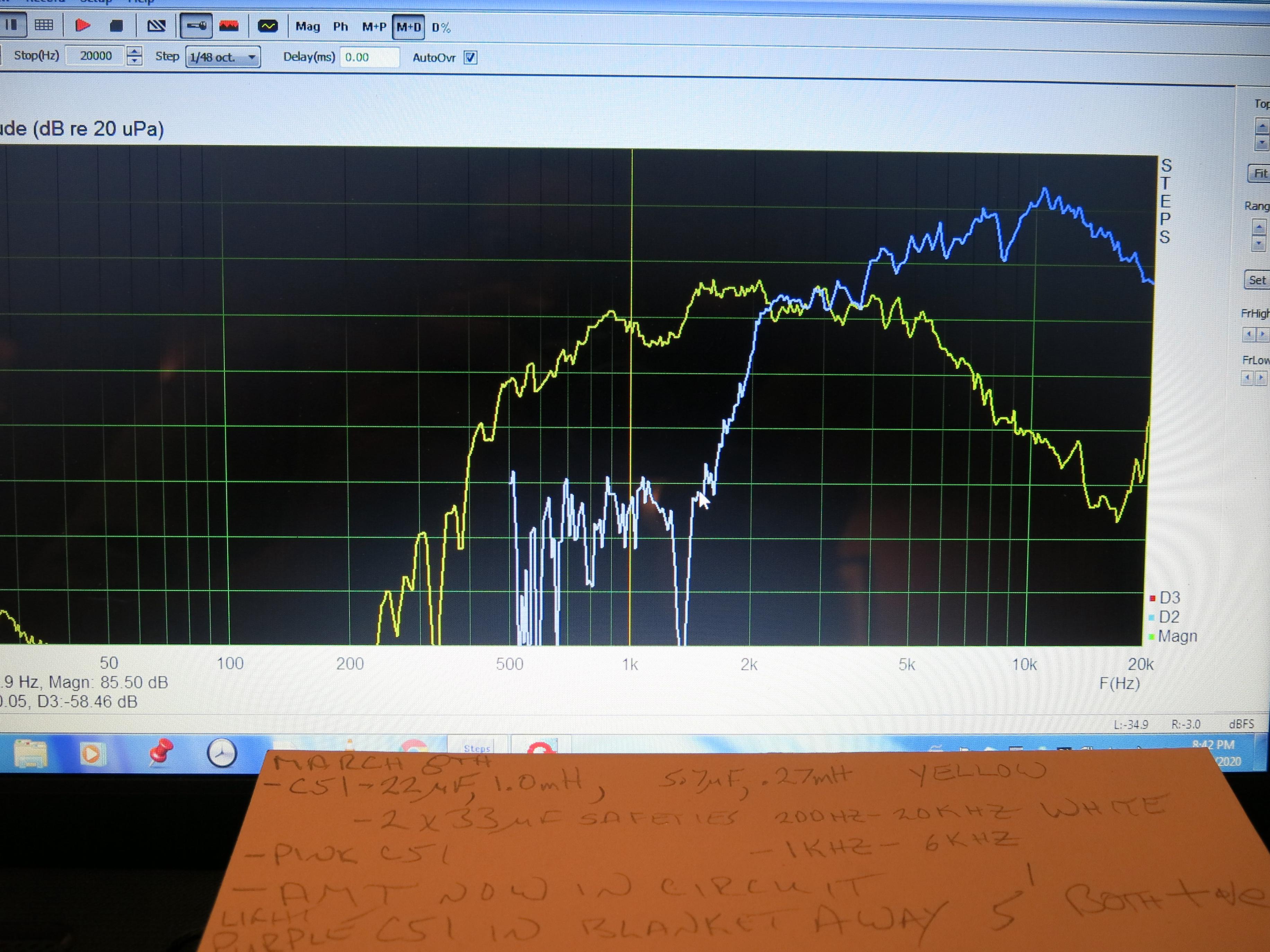

Post #3, picture 9, shows the high pass filter. The Accuton now drops closer to our 1270Hz target.
Housekeeping; the woofer is in the room, but 10 feet away, and buried in blankets and pillows. The Mundorf AMT is also in the room, 5 feet away, also buried in blankets. They might contribute a bit, but that's not our concern right now.

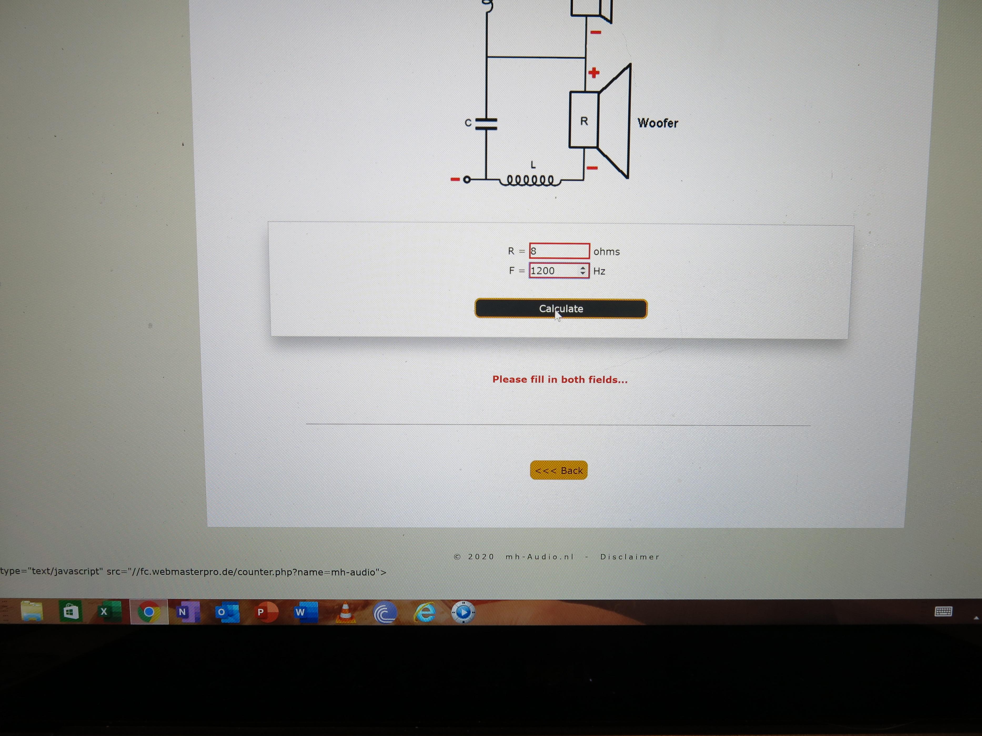

Using mh-audio I got my low pass numbers. I have a 0.27mH inductor, so that was my target. I had the Accuton impedance wrong, but I'll worry about that later. For the low pass, I now use 6 Ohms.
The high pass capacitor for the Mundorf is 5.7uF.
Picture shows the frequency response.
Series crossovers have large overlaps, which is one of the many reasons they're avoided. I don't avoid them.
No anomalies from using a Series crossover.

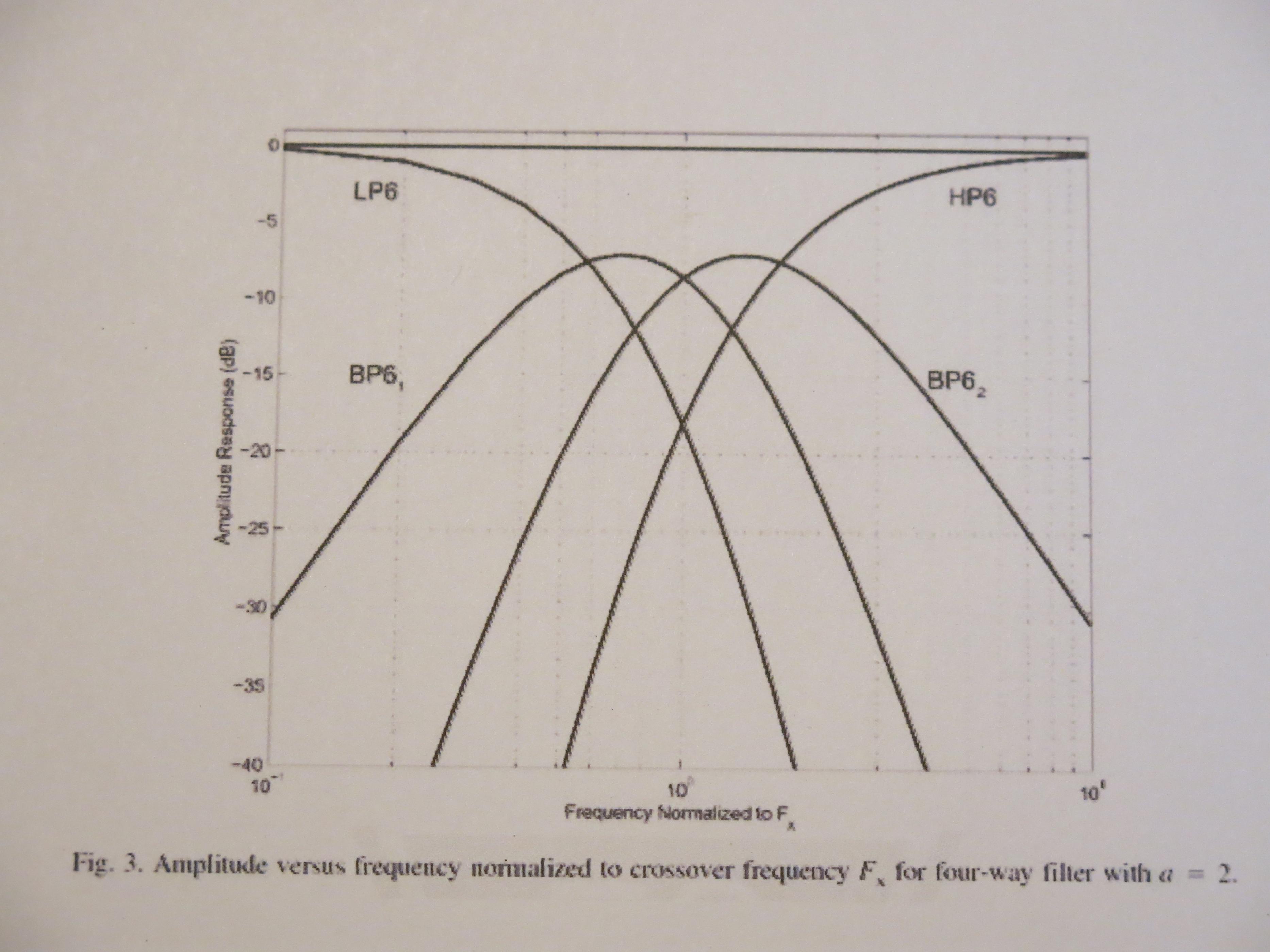

1) thank you system7 (Steve). About 5 years ago you introduced me to the work of Bud Fried. He believed oversized capacitors sounded better? But, will they give us that fear mongering series crossover picture that made us all afraid of these crossovers?
Pic. 1) Red trace. I added 2 x's 22uF caps, one to each of the 17.65uF caps. This gave us two x 37.65uF
Pic. 2) Green trace. I added 10uF to each of the tweeters 5.7uf caps.
With the exception of moving the -3dB point, no wild output swings. I will concede this is a trace of only one driver. Maybe when the speaker starts to take shape I'll try again.
So far so good.

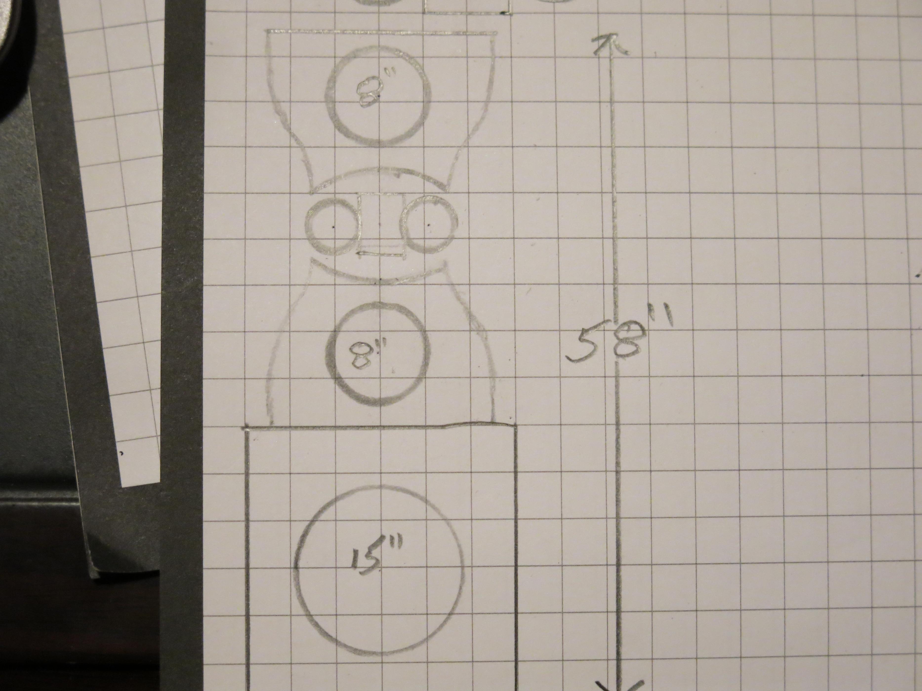

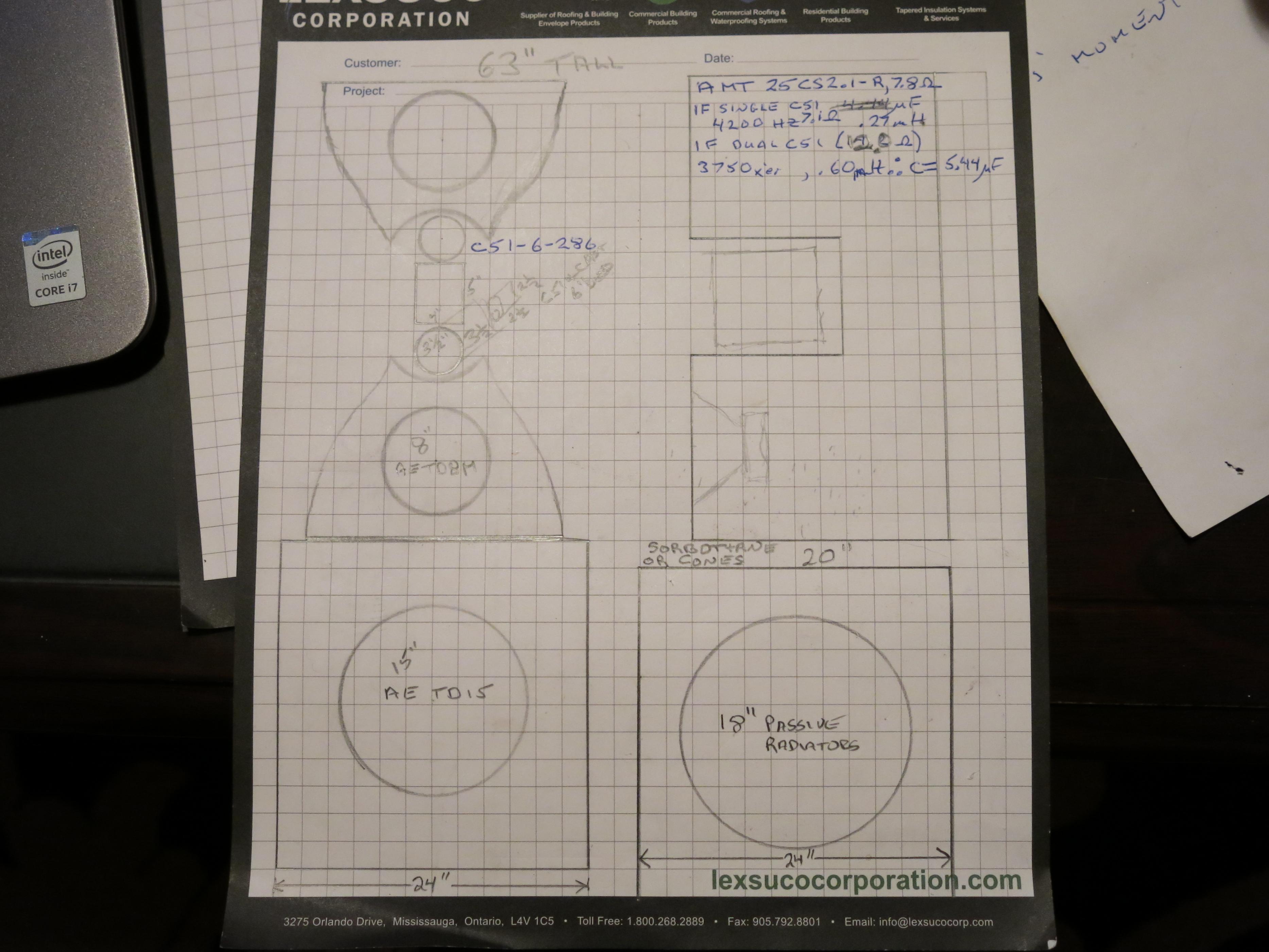

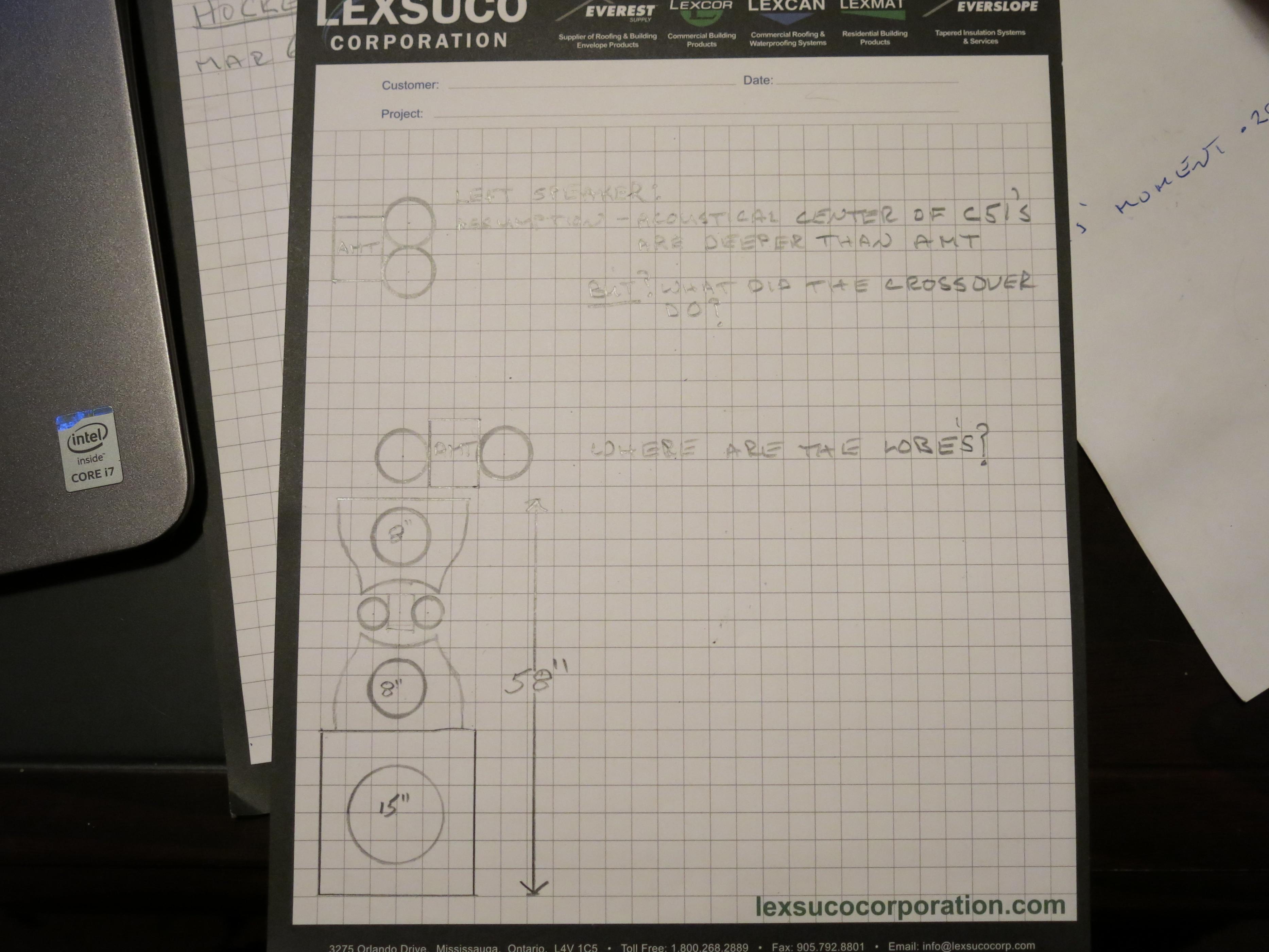

I drew a preliminary sketch. My wife didn't say no!!.
I redrew the tw/mid section as per erik. I'll show it to her, and let you all know what I've decided.
Since the Acoustic Elegance drivers are still a long way away, I have time to think?

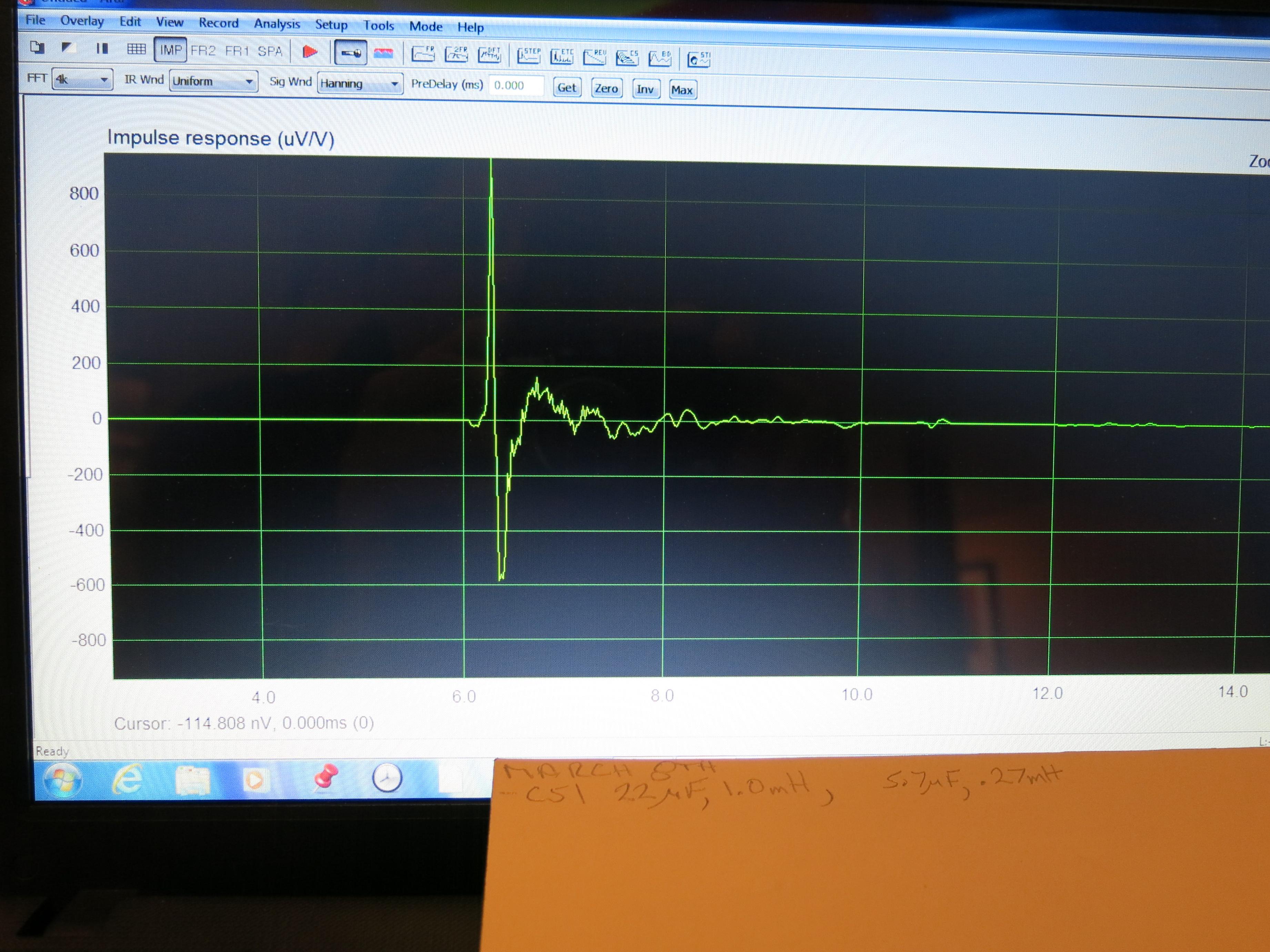

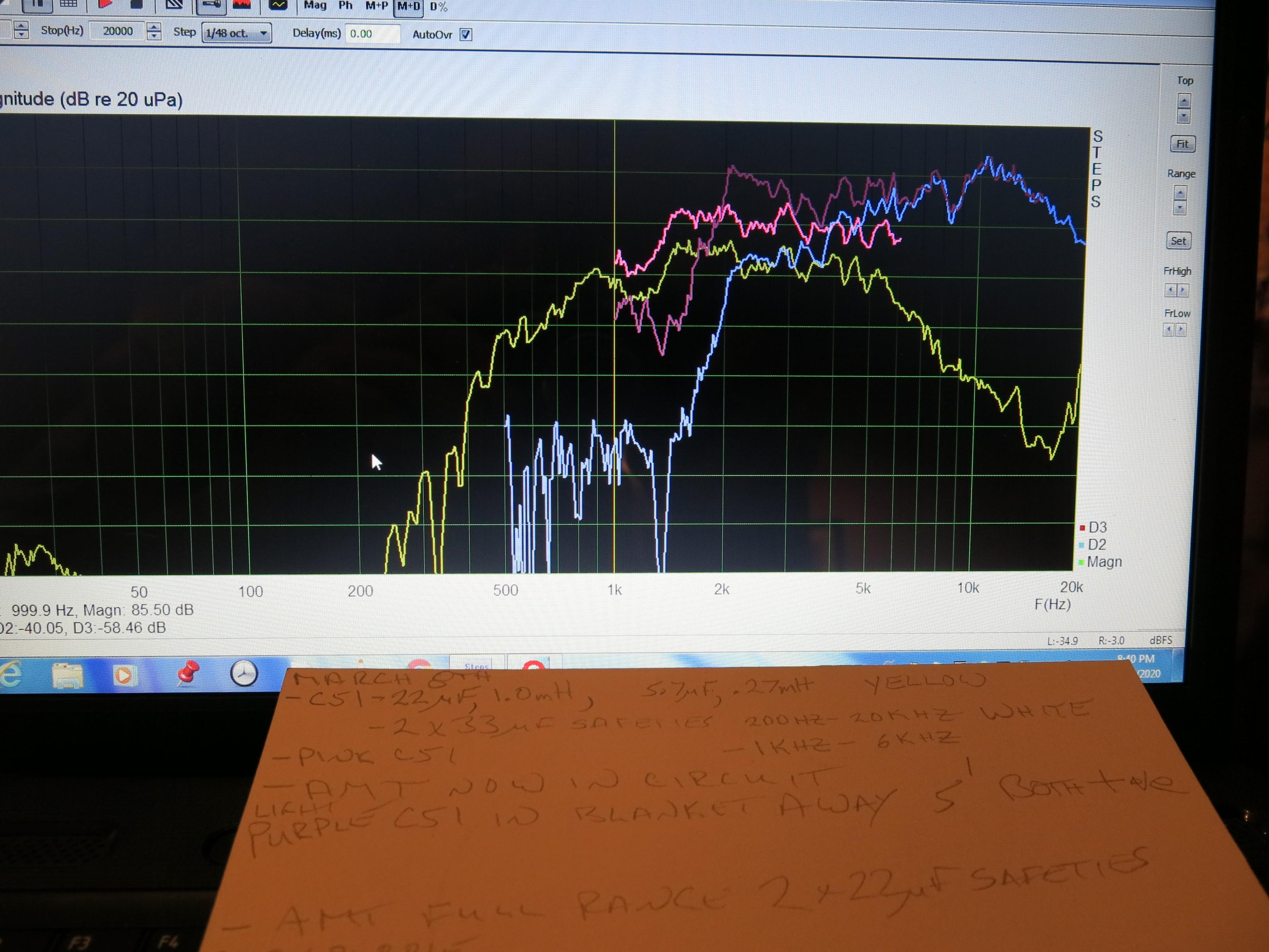

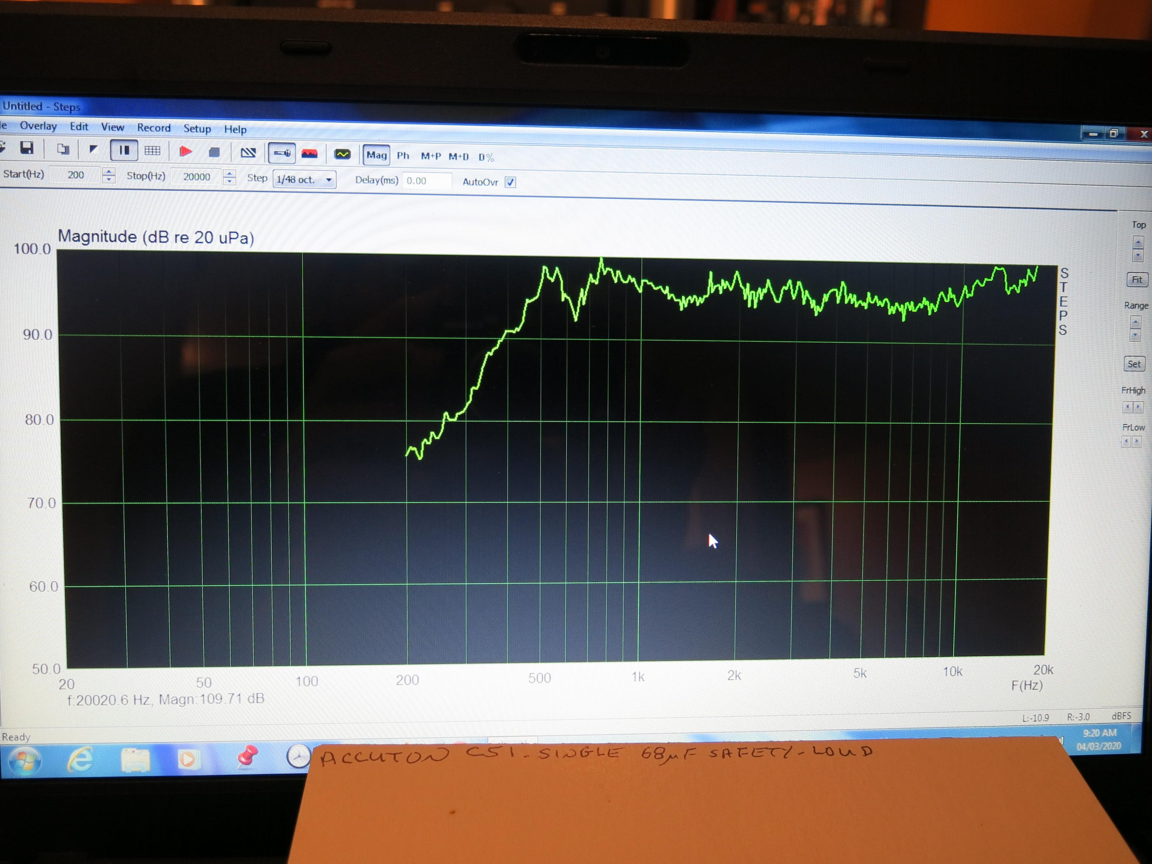

I now have baseline measurements;
The single Accuton C51
Pic. 1) fr in circuit
Pic. 2) distortion of C51 in circuit. Looks good. Dist. is 0.2% or lower in it's intended range.
Pic. 3) Impulse response in circuit. I've never done Imp. measurements. How does it look?. Please comment.

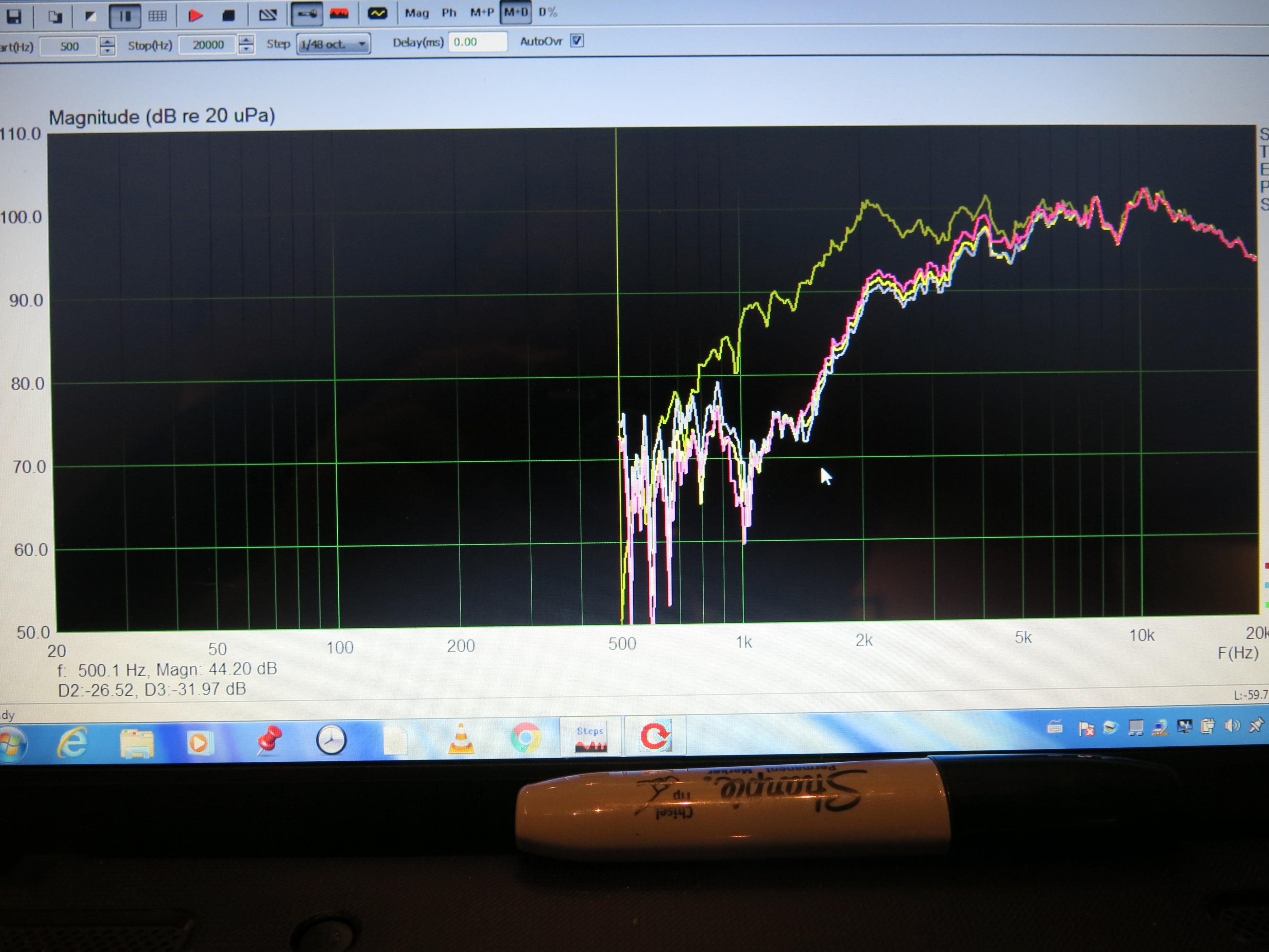

Pic. 4) C51 out of circuit, but with safeties. I'll post a picture latter showing why the lower output (in circuit) was expected.
Pic. 5) AMT in circuit, and with only safeties.

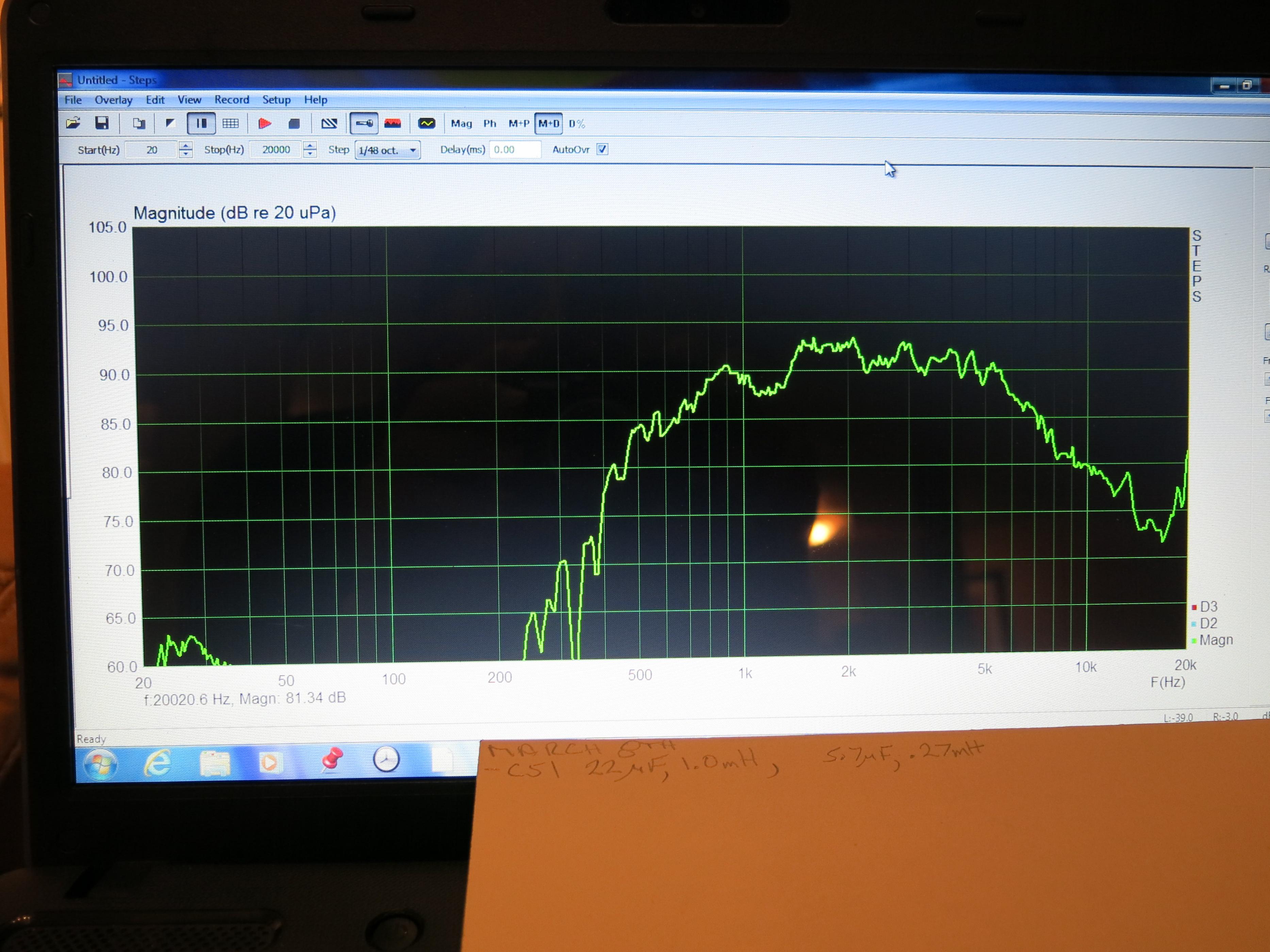

Pic. 6) C51 and AMT
So far so good. Outputs are as expected.
Pic. 6) C51 and AMT

Well, that's not what I meant. If you do a horizontal array, you'll end up with narrow mid-beams, and very wide tweeter beams. I meant like this:
8 [ || ]
With the 8 representing the two mids, and the [ || ] representing the AMT.
This will give you more similar horizontal and vertical beaming for the mid and tweet array. ..... but.... experimentation can lead to unexpected results, so don't let me stop you. 🙂
8 [ || ]
