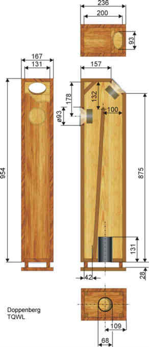

ik vond op internet dit stukje over de TQWT welke sterk lijkt op de tapped horn.
hier maken ze gebruik van een extra pijp en driver afgestemd op 2e harmonischen.
maar als ik zo kijk lijkt die stub daar ook wel op.
wou het toch even plaatsen voor de info.

I found a peace of info about the TQWT these sory go about using a parasitic pijp tuned 2e harmonic of the main pipe who is tuned to speaker fs.
and here start the info

Hi geitmans hmm sounds dutch?
oke , yes I now it is nog a tapered horn, vut so I read it is 95 procent identical.
maybe it is nice to do with the tapered horn the same way with a extra pipe tuned to f2.
so you can have a horn 15 hz, and the second pipe on 30 hz to expand it to three octaves.
this I saw on the stud.
greetz kees

Hi kees52,
Do you have a link to the information you are mentioning, or any other references?
here is the link where I read it.
http://yu-ra.tripod.com/tqwta.htm
further I have no information.
we have to simulate it with hornresp.
I have not much experience with loudspeakers, only with amps but read some about it.
but to correct the specs of the enclosure we need to experiment with the second pipe to get 3 octaves.

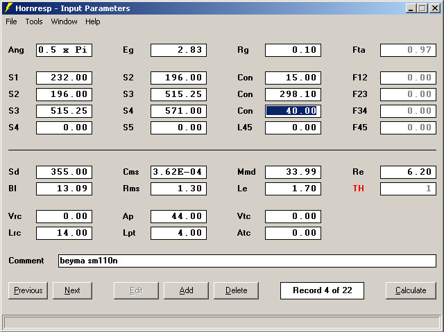

Hi kees52,
At this point Hornresp will not be able to simulate the enclosure you described above, you will have to use AkAbak.

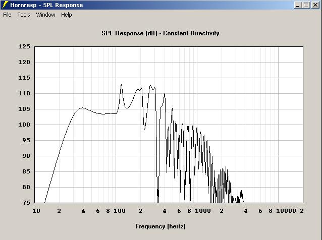

@geitmans
Great documentation of you project!
I noticed the scale you used. Between the 20Hz SPL and 100 Hz is about 10 dB difference, which is quite a lot. Did you have a chance to do some sweeps, how´s subjective perception of these "bumps" ?

Sabbelbacke,
There is indeed a 10dB difference but this is also the case with the original as can be seen in this measurement:
Up to now this has not bothered me too much when listening to it. When you will use this in a normal room the room modes may have an even worse effect on the frequency respons. When you install this speaker with a some kind of subwoofer processor you can compensate for room modes and uneven respons of the speaker itself.

No real progress here. Still haven't been able to measure it outdoors. The problem is really that this thing is too big to handle on your own. It also has to leave the living room as its taking up too much room (Be warned: the WAF of this speaker is below zero) . My goal to build this was more to learn a bit more how the tapped horn behaves in reality compared with simulations and to see what this design was capable off. The best way to start I thought was to use an existing design as a reference. Now I can start thinking of perhaps a smaller design which will fit my needs better.
Annyway, If there is someone from the neighborhood of Antwerp who knows a good spot to do outdours measurements and wants to help me drag the thing overthere please contact me 🙂
As for the plans, I based myself on the info which is available on the net. I did make more detailled plans based on this info but I don't want to share these as this is still a commercial design and Tom still has to make a living out of it.
