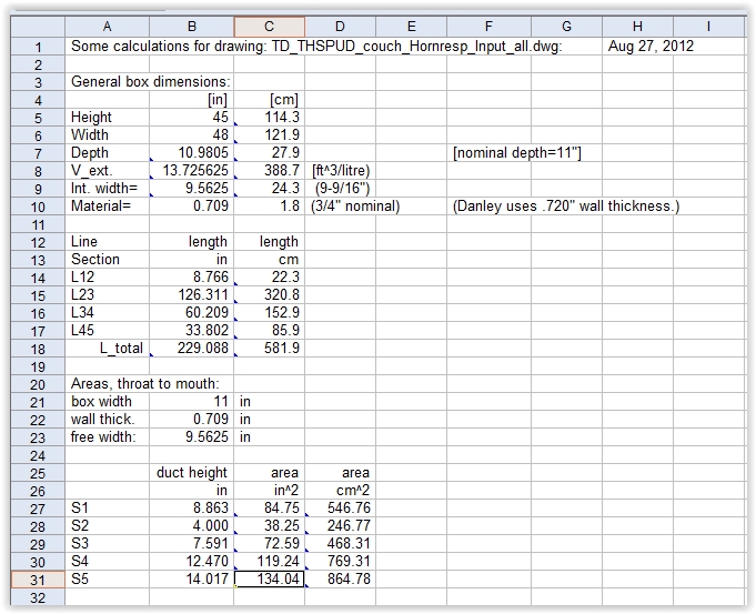

Hi Y'all,
Post #138: "...Has anyone ever done the work and created a proper HR model for the TH-SPUD?..."
Didn't have much time yesterday, so I just posted the Hornresp Export, here is the drawing on which I based the Hornresp data. This is derived from the "leaked" drawing that can also be found in Post #30.
I used Soho54's advanced corner method for the duct length in the corners, and had to introduce an arbitrary S3 (slightly reduced from the actual) so that the Hornresp flare matches the actual flare better. E.g.: If you use a three section simulation w/ a Par flare there will be quite a bit of added internal volume, and the simulation will be quite a bit off. AkAbak could be used to get more precise, even though that may not be necessary.
Let me know if you find any major errors, that would be good to know.

@TB46
thanks for sharing that valuable drawing and the hornresp export file.
I just took a closer look to them and have some questions:
The export file contains dimensions which are VERY different compared to the PDF file. I also noticed that the TSP in the export file are different to those in TB's spec sheet.
This is the data from your hornresp export file:
Based on the dimensions from your PDF and the TSP from TB's spec sheet the input parameters look like this:
Corresponding to your hornresp export file:
Consequently the results of the sim look very different:
This is based on the data from your hornresp export file:
And this is based on the dimensions from your PDF and the TSP from TB's spec sheet
Or am I missing someting?
At least the last simulation looks close compared to the measurement I took from the clones I buit (uncalibrated ground plane measurement in the garden, mic. approx. 8m distance to mouth):
So, what do you think?

Hi Volvotreter,
Post #144: "...So, what do you think?..."
The T/S data came from mwmkravchenko. I don't have any way to verify the data, maybe you have measured T/S for the TB W8-8740P? (I'm also fighting w/ a recently "updated" to Windows 10 laptop. MS is nuts.)
At the moment I don't have a lot of free time, but I revisited the spreadsheet I used to convert/calculate the Hornresp Input data. The main difference is that I used .709" wall thickness in the calculations, otherwise the areas and length seem to be correct?
Hi TB46
Mine are from a TB spec sheet. Now I checked the TB web site and surprisingly they show somewhat different TSP.
To the left is my (old) spec sheet, to the right is the one which is currently on the TB site:
Levc: HUGE difference, Q's and the suspension compliance are also somewhat different. Sadly I have not measured mine.
The comparing simulation shows a little difference (black = new data / grey = old data):
In the PDF (plan) there is the unfolded horn horn shown with dimensions. These are the dimensions I took.
The dimensions in the export file you posted 1st look odd to me. Their simulation
shows the rugged response and the dimensions are very different to your drawing.
And I trust your drawing...
I also simulated the Eminence 290-4008 driver referenced by brookhart995. This is what it looks like:
(black = Eminence / grey = W8-740P "old data")
Considering the price they are in the same ballpark. I cannot judge on which might be the better choice.
BR.

I only have a couple of minutes right now and I'll look into this further tonight when I have more time.
BUT a quick look at the drawing in post 30 says Exit 1, Exit 2 and Exit 3 are all the same dimensions, roughly 9.5 x 14 inches. These 3 possible exit locations look like 3 mouth placement possibilities. 9.5 x 14 inches is approximately 133 sq inches, or 858 sq cm.
Therefore the sim that has S5 close to 858 has to be the correct one. The second sim has S5 at 356 sq cm which is way too small.
Like I said, I simulated this years ago and from what I remember tb46's results look pretty reasonable. This flare is close enough to a single flare rate single CON segment from S2 to S5 to get an idea of what's going on, so if you figure out the cross sectional area at S2 and S5 a very simple sim will show that tb46's results should be pretty close, I think.

Hi just a guy,
your're indeed right. I misinterpreted TB46's drawing
. These should be the right input parameters:
Wit these parameters the comparing simulation of new vs. old TSP shows (again) a little difference (black = new data / grey = old data):
And the Eminence in question
compared to the W8-740P (black = Eminence / grey = W8-740P "old data")
That a peaky response can be smoothed with stuffing, as you're saying, is then supported here as well since the ones I built measure also smoother than the simulation without stuffing predicts.
BR.

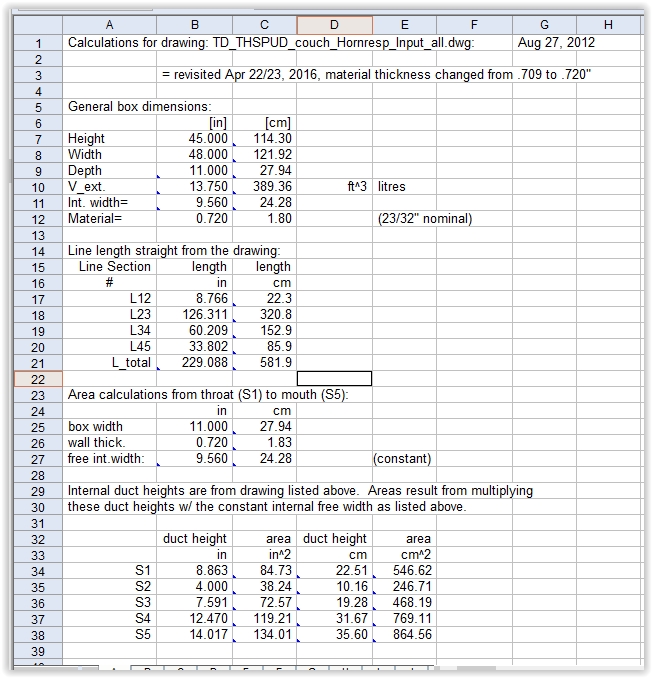

Hi Volvotreter,
Good that we found agreement on the numbers. 🙂 I'll just summarize my posts on this subject here, and add another spreadsheet screenprint, this time w/ .720" wall thickness.
Post #140: Hornresp Export file
Post #141: Referenced drawing pdf
Post #145: Spreadsheet for Hornresp Input data - wall: .709"
here: Spreadsheet for Hornresp Input data - wall: .720"
At the very least this should give somebody a good start into AkAbak (using Hornresp Export-AkAbak Script).
Please excuse my ignorance, but how would a person derive the panel sizes from this spreadsheet? I can see the overall outer dimensions as 45" X 48" X 11".
