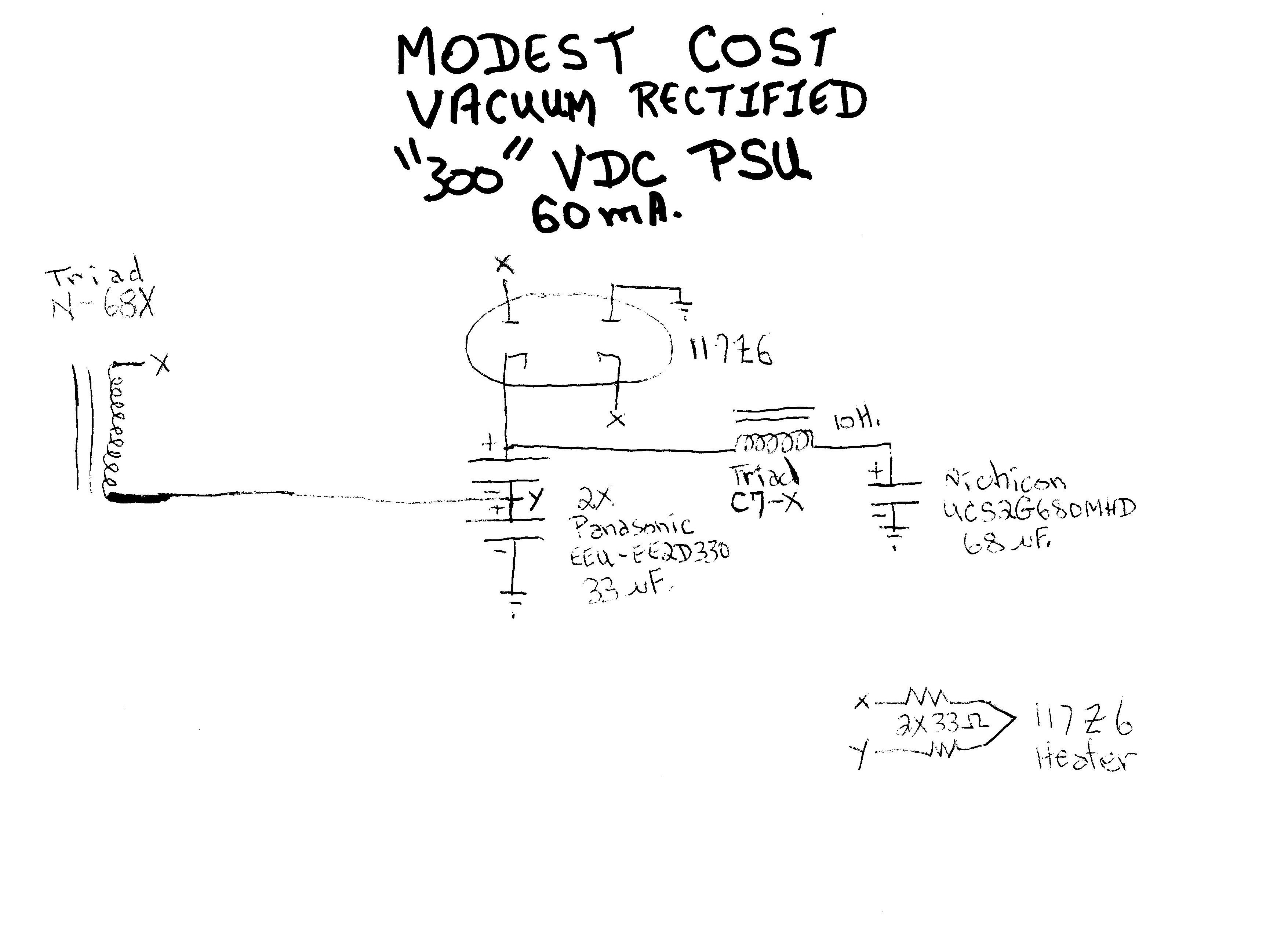

Possible lay out for power supply.]
10 1B3's , 19 pound tektronix transformer, maybe 10h 300ma choke and 1000mfd of film caps! should be enough for a single 12ax7.
Take that times 2. One transformer per channel. two rectifiers, massive choke and filter caps and you have the makings of a decent preamp once you ditch the 12AX7 in favor of a decent tube.
