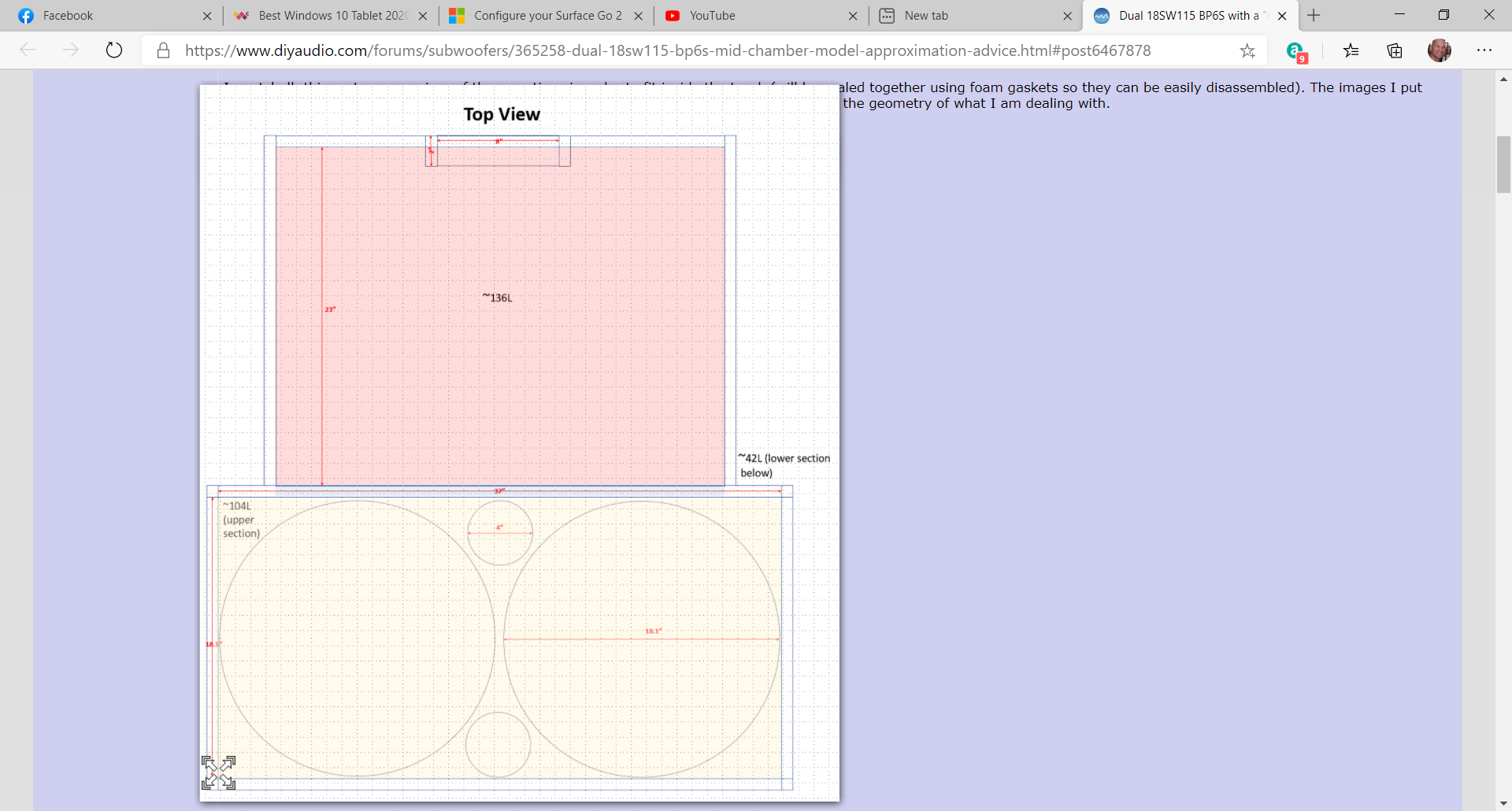

In nutshell, this system comprises of three sections in order to fit inside the trunk (will be sealed together using foam gaskets so they can be easily disassembled). The images I put together PPT below show the general configuration. The side-view I think most clearly shows the geometry of what I am dealing with.
attachment.php
attachment.php

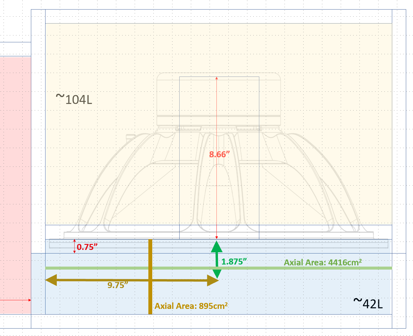

(All values below are net after displacements, wood thickness is 0.75" MDF)
- Rear (yellow): ~104L: houses two B&C 18SW115s, two 22cm 4"ID PVCs, when considered standalone tunes to ~38Hz. The drivers are recessed in this chamber by 0.75" for speaker protection.
- Mid (blue): ~42L: a chamber with an open-top that serves a "pedestal" for which the rear chamber to fire into. In essence, the foot-print of this chamber is identical of the rear chamber that is mounted atop of it. The front of this chamber has an opening to where it mates to the front chamber; the opening here will be ~3"x29.5". This chamber is the crux of the problem as it has an effective axial area of ~895cm^2 (3.75"x37") over a length of 47cm which then steps into to front chamber having an aperture of 571cm^2 (3"*29.5").
- Front (red): ~136L: this chamber sleeves the inside portion of the trunk and mates up to the ski pass (~489cm^2 of port, ~2" in length but this can be adjusted as needed). From the top, the front chamber is slightly narrower than the rear/mid chambers.

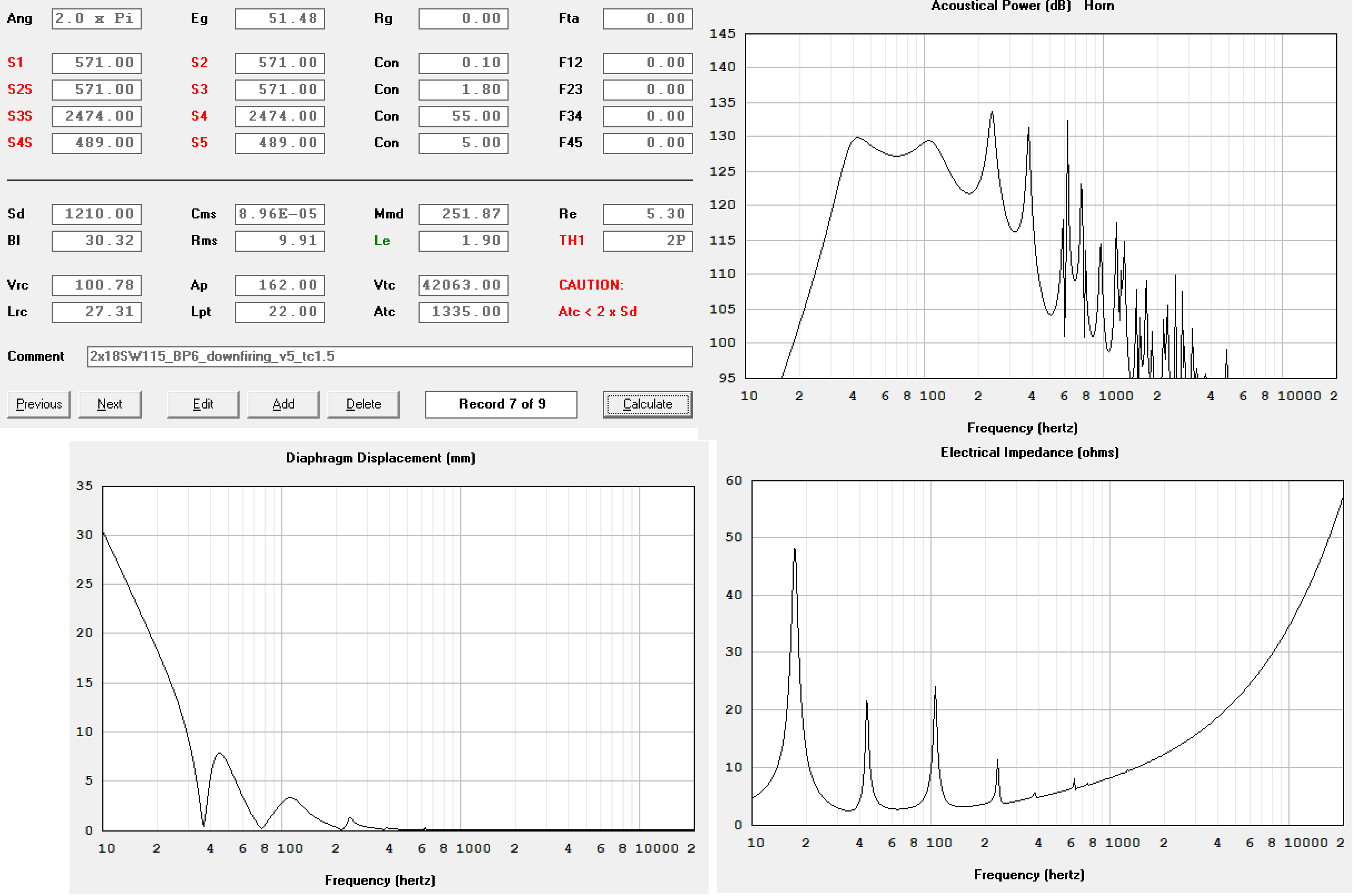

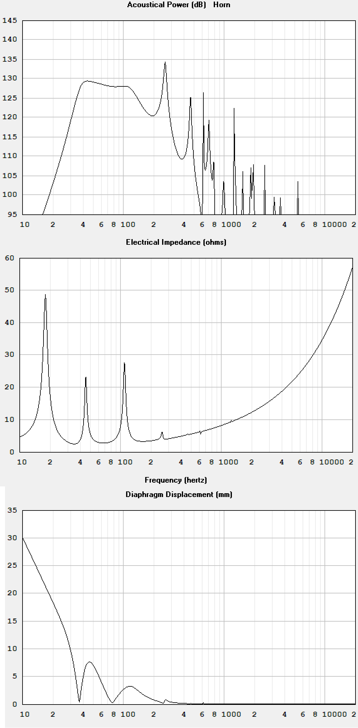

Modeling is done in Hornresp, with 1kW of power, using semi-inductance parameters I've derived from the impedance curve. The volume of each section is quite trivial (~286L total in each model) but it seems that the geometry (in terms of length/areas) results in significant deviations from model to model. I would appreciate any advice on what would be most appropriate. The problem at hand is that I don't think I can bin the mid and front chambers and consider them simply in terms of volume as I think there are some compression effects happening in the mid-chamber.
Model 1: TH1 using a standard rear chamber, mid-chamber is approximated ~895cm^2 using two horn sections (this not account for the step change into a 29.5"*3" (571cm^2) aperture into the front chamber.
attachment.php
Model 2.1: TH1 using a standard rear chamber, mid-chamber is accounted for in Vtc/Atc; Atc is 4416cm^2 giving a length of 9.52cm, this loads into the front chamber through the 29.5"*3" aperture into the front chamber which is accounted for here
attachment.php
Model 2.2: TH1 using a standard rear chamber, mid-chamber is accounted for in Vtc/Atc; Atc is 895cm^2 giving a length of 47cm, this loads into the front chamber through the 29.5"*3" aperture into the front chamber which is accounted for here
attachment.php
There are a couple critical questions in regards to the models:
- Models 2.1 and 2.2 are quite similar with the difference being the consideration of the "length" of the chamber relative to everything else. Is it seen as 9.52cm (height) or 47cm long (length). I like these in that they both consider loading into the front chamber through the step change in the mid chamber but are quite different due to the considered length of the mid-chamber? What is most appropriate? Or maybe something in the middle, like a 24cm approximation of length.
- What is the most "correct" placement of the front and rear entry points? Effectively, I would like to have woofers and port as a single point loading in at 25cm (the center point of mid-chamber) but I don't think that it's possible to do with more segments, which I don't believe Hornresp supports. Given horn-resps constrains it seems that the driver and vents are offset by some distance which results in model differences between the two.
Model 3: BP8 Wizard where the mid-chamber step is considered as a 0.75" port of area 571cm^2. I think this one is the most ambiguous of what is happening in terms of geometry.
attachment.php
All in all, I think the responses in all models looks fairly workable in the frequency band I want to target but it would be nice to have a relatively flat response with slight emphasis at 40Hz (which model 2.1 presents).
As always, I would be very greatful for any advice and insights on this design.

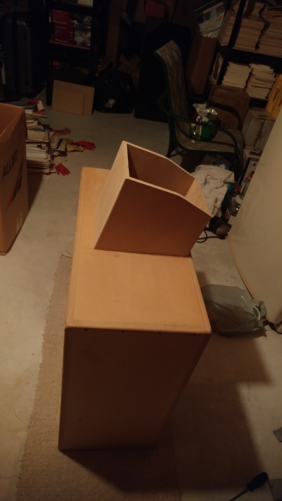

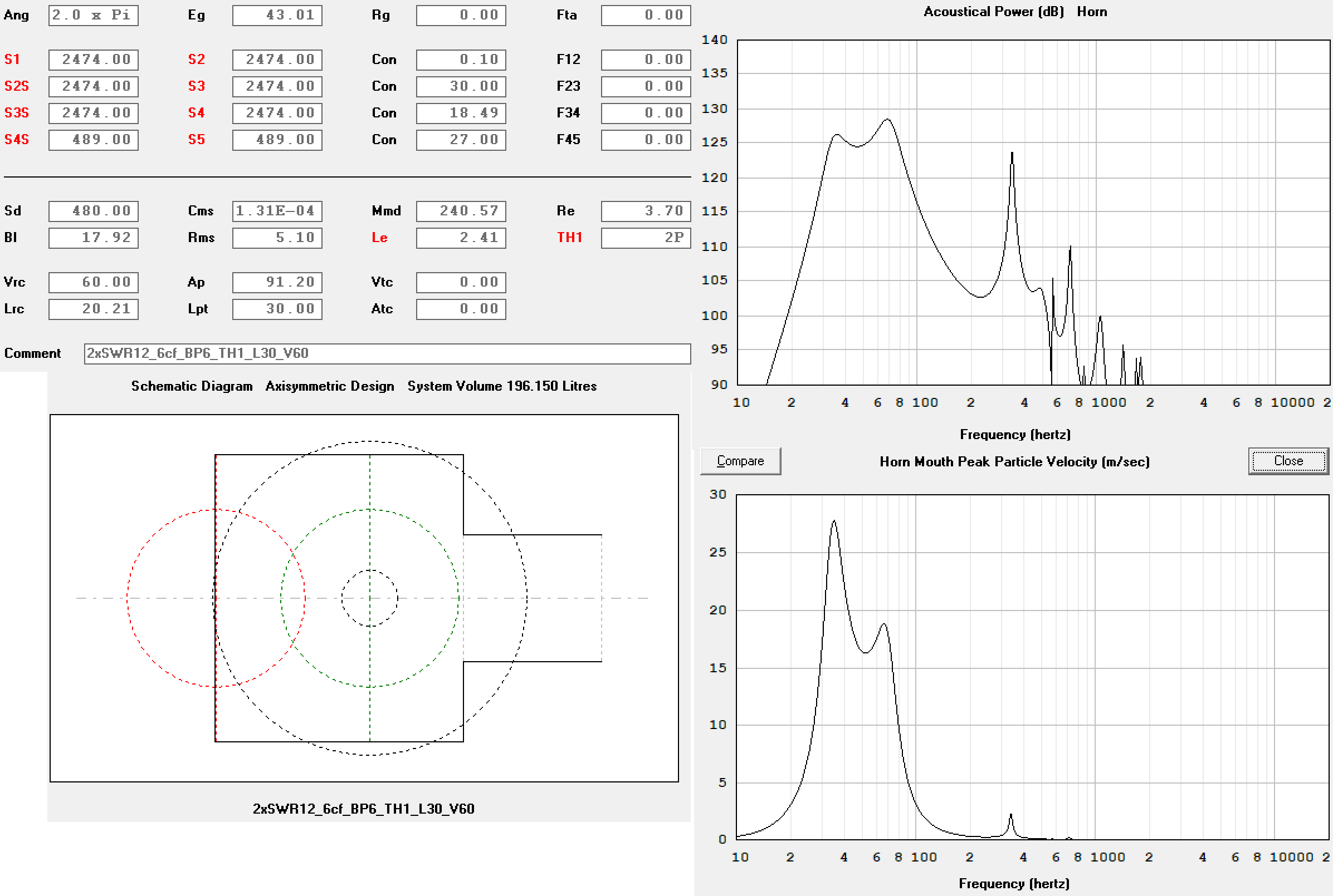

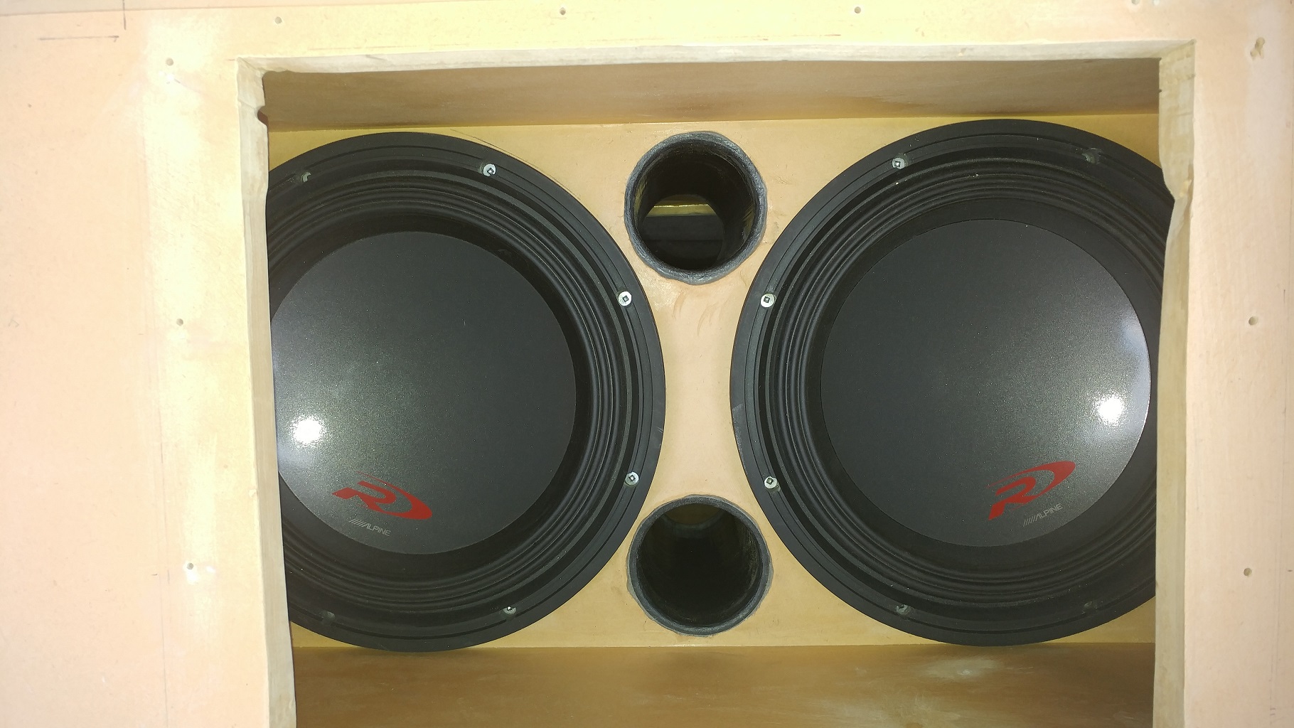

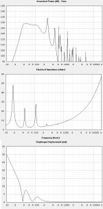

Hi Brian,

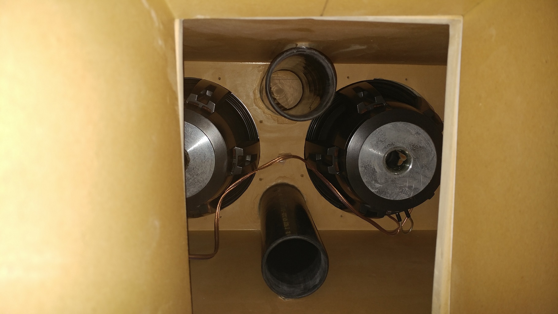

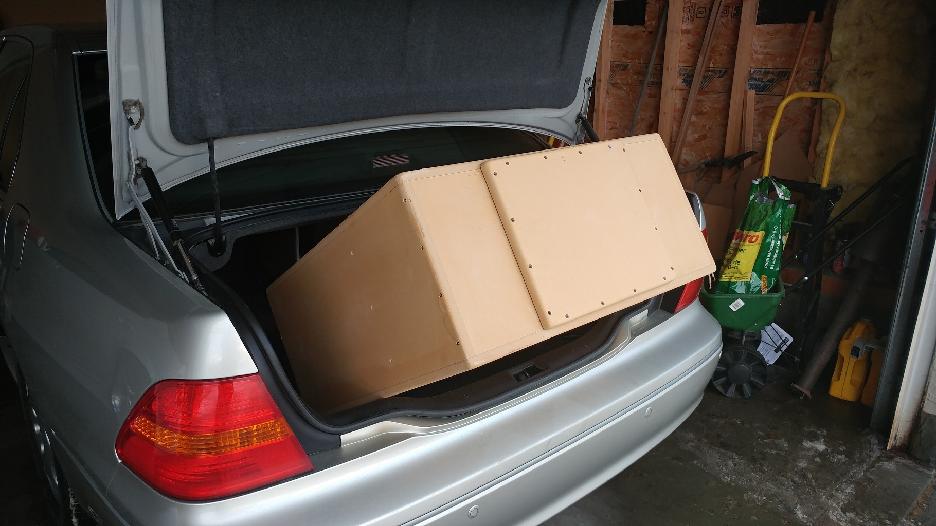

Yes, port area was one of my main concerns when I built my first BP6S enclosure in that vehicle (two SWR-1243Ds, which happen to be my favorite well-rounded sub drivers of all-time).
I don't want to digress too much but for interest's sake that enclosure looked as follows and had predicted port velocities on the output of ~25-40m/s in the 1000-2000W range (this is theoretical of course, as concessions have to be made in terms of real reactive power, power compression, port compression, etc...). In practice though, even at such power levels the output from the skipass had no chuffing and was honestly quite effortless.
Another concern of mine were the interior ports, but that's another story. From practical testing in the car audio community it was found that when they begin to compress the enclosure starts to act closer to a 4th orders. Ultimately though for such enclosures I like to use PVC pipes as you can retroactively adjust them (and even have them sticking out of the box) unlike slot ports.
For interest's sake:
attachment.php
attachment.php
attachment.php
attachment.php
attachment.php
In the case of the B&C 18SW115s it seems that at 1kW level port velocities are acceptable, but you are right, at 3kW it's quite concerning (~40-70m/s). I'm afraid that the amount of port area at the ski-pass is a hard constraint and cannot be changed. That being said, I think even at 1kW of power this setup will be extremely loud and I am building this setup with a lot of headroom in terms of power handling so I don't really expect to play 3kW in a realistic setting. As a side note, at 1kW this setup will not even see significant power compression whereas the Alpines did get notable quieter (at least ~3dB on the ear-o-meter after they had "warmed" up) after extended use. For the sake of curiosity though I'm interested in finding out how much air you can stuff through a skipass... LOL
As for other considerations, the front chamber port will basically be a hole in the baffle (which will be wedge shaped to mate up to the rear seat, not modelled here for the sake of simplicity but the impact of that is nominal). The effective length will be ~2" which is the length of plastic ski-pass frame. From what I've read in literature it seems that extremely short ports that are also quite square in ratio (~1:1) will have even less propensity for noise/compression.

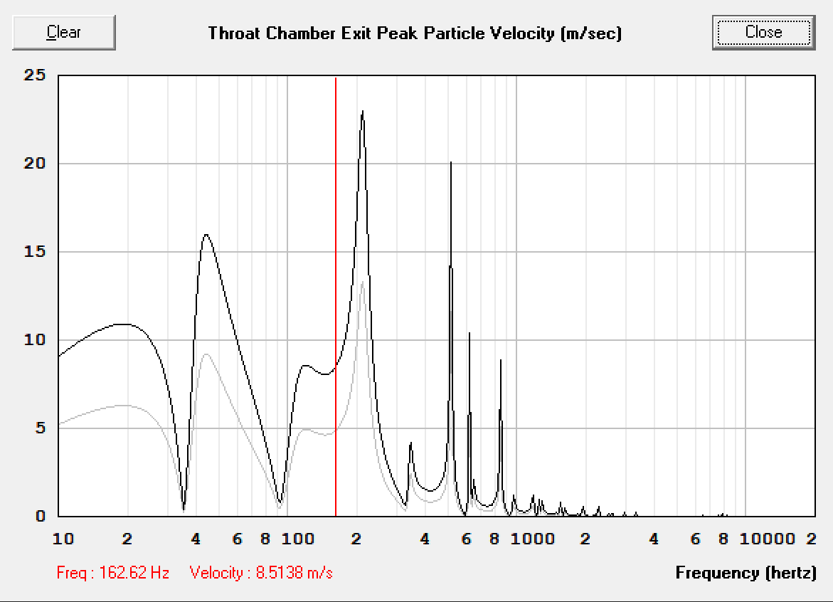

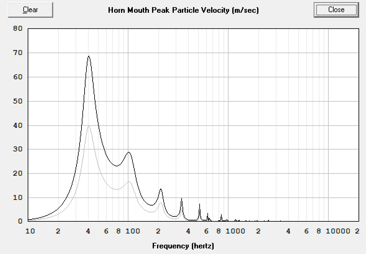

Below are velocities at 1kW (grey) and 3kW (black) at three sections (using model 2.2 for reference). Overall they appear to be acceptable at 1kW (<40m/s) with concerns in the 35-50Hz region (40-70m/s) at 3kW but I'm interested in finding out in practice what really happens at this higher power level.
Mid chamber (throat chamber exit section where the woofer is firing into, which mates to the front chamber):
attachment.php
Front chamber (skipass):
attachment.php
Apart from such high-power non-linearities for practical purposes at ~1kW it should work well.
Ultimately though, I think what's happening in the mid-chamber is going to be x-factor. From a velocity standpoint velocities here are relatively low (~15m/s @ 3kW) so I don't see a bottleneck in this regard. It's clear however that there is a unique resonance happening here and must somehow be modelled as it affects the loading of the internal 4" ports and ultimately what's happening on the ski-pass exit. Based on different modelling approaches it can induce a +/- 3dB ripple in the passband as you've see in the various models which are essentially equivalent in air-space but with varying geometries.

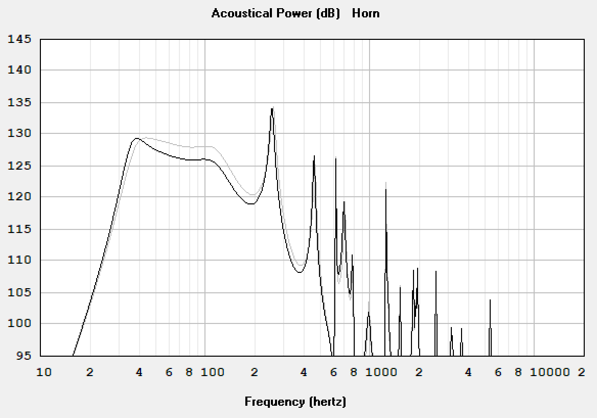

For the 18SW115s alignment, the only port that I considered a hole in the baffle will be the port at the ski-pass. In the initial diagrams, the front port is actually not in the box but just a placeholder. In practice, it's effective physical length will be ~5cm when it is mated up to the "skipass sleeve" which is basically a plastic beauty cover... so basically basically 0.75" hole in the MDF + another 1.5" or so of sleeve. It can obviously be extended as needed.
Making this port longer (say for example ~10cm) drops the the average response by a couple dB, and bumps the low-peak by a couple dBs as expected.
This is what that the response looks like using model 1 using 5cm (grey) vs. 10cm (black) of port at the skipass.

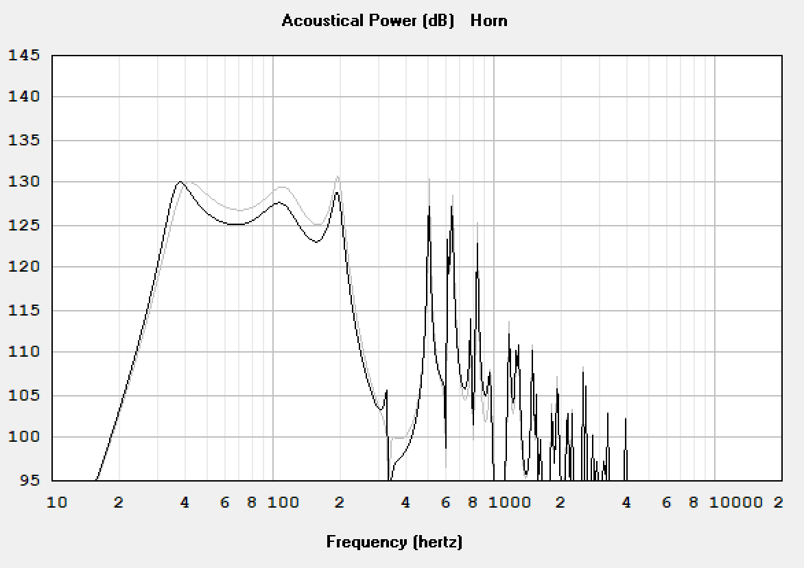

If I consider model 2.2 as closer to the truth, then the following happens respectively at 5 and 10cm.
attachment.php
Whatever the case may be it's clear that it's going to be loud but it's a big puzzle as to what could the correct model could be given the mid-chamber. The good thing about this design is that due to modularity there is a lot of room to make adjustments retroactively, in terms of port, even the box.

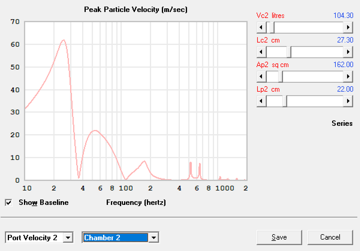

In this particular TH1 configuration (models 1 and 2) Hornresp is not letting me see the port velocities in this section but in the BP8S wizard model (approximating the BP6S) we can get an idea. This model also features the lowest extension as well.
We can see that with the twin 4" PVCs the port velocity at 1kW is acceptable down to 30Hz. It's quite interesting as the other resonances are loading down the inner ports... common sense would dictate that you would get a huge velocity at 40Hz but that does not appear to be the case.
attachment.php
Unlike parallel bandpasses, series bandpasses are weird animals as it's quite clear that all port tunings are not mutually exclusive. They all seem to work in conjunction with one another resulting in interesting tuning shifts at each node.
The rear chamber in the above design, at face value considered as a simple vented box, is 104L tuned to 38Hz and would be considered grossly undersized for two low QTS 18s. However, when placed in a series alignment it seems that conventional logic generally goes out the window. From others' conjecture and testing it seems that people like to use small rear vented sections and small rear ports in series tuned enclosures, and again if they do compress they act somewhere in between a 4th and a 6th BP.

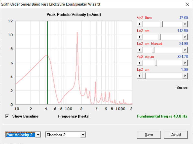

That's curious. I'd have expected the particle velocity of the internal vents to peak at the lower Fb. In your design, the particle velocity is almost at a minimum, if the location of the lower Fb based on the excursion curve is correct.
Here's what the particle velocity for the internal vent of a BP6S that I just designed today looks like. And it's peaking at Fb. Oh, double-clicking on the graph should cause Hornresp to highlight the lower Fb, as indicated in the attached image.
Didn't know that. That's a good tip for the wizard, should come in helpful in the future.
But yes, I agree that is what I would also expect...
I think this is some sort of a unconventionality that's induced by having this "mid-chamber". In all models it manifests itself in some capacity but I could see something like that happening as the ported drivers have huge area (Sd of ~2400cm^2 + port) firing into a chamber with a relatively short cross sectional area of 900cm^2 with a ~500cm^2 stepped exit before going into the front chamber. The velocity out of this chamber can be up to 7-15m/s (1-3kW respectively) which means that there is some resonance here that is not significant to appear on it's own but given the passband will manifest in the other impedance peaks.
I don't think the wizard for the BP6S fully entails this nuance as it just thinks of the the box as two simple rectangular sections. I don't think the model is fully representative in my case as I would basically bin the front and mid chamber as one, neglecting all geometry. However the BP8S wizard can model this in some pseudo capacity (basically considering the mid-chamber volume as the 3rd chamber with a port length of 0.75").
I think the TH1 models are going to be closest to ground truth despite some shortcomings in regards to entry points but I despite this they seem to take into account the potential geometry most closely (I'm leaning towards the ground truth being somewhere been 2.1 and 2.2)...
Right - mystery solved. Your model is an 8th order BP, not 6th order. The vent velocity curves for the rear enclosure in an 8th order BP system are a bit different. At least, Hornresp says so 🙂.
The impedance curve will be quite different as well (four main peaks, instead of three). And three excursion minimums in the passband, instead of two.
LOL, yeah... I guess whether to consider this a BP6S or BP8S is the crux of the problem... 😉
From a wizard perspective, approximating this as a BP8S (model 3) we can get the four peaks, but can the mid-chamber really be considered "ported" by way of the wizard's nomenclature if it's only 0.75" deep?
On the contrary the non-wizard TH1 profiles are approximating something along the lines of a BP6S but adding some nuance of the 8S element by way of either stepped horn sections or using the Vtc/Atc parameter.

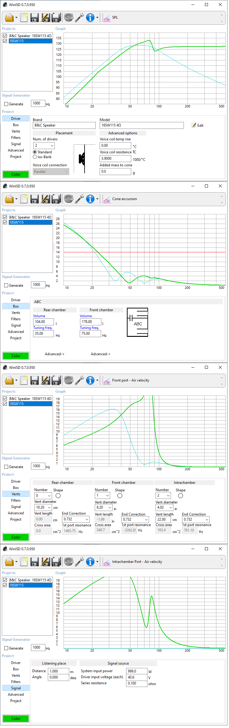

I have no experiences building 6th order (or whatever order), but I have played some with WinISD and I thought what your case would look like in WinISD.
Apart from a 4th or 6th order you can choose 'ABC' which has 2 chambers and 3 ports to configure. In this case the rear chamber has '0' ports, but only 2 intrachamber ports. I put the volume of the blue and red together.
Unfortunately the vent length is of the front chamber is not editable, but I tuned the frequency to match your length.
I don't know what to think of the results, but I put an regular 6th order with same drivers and boxvolumes at the back for comparison.
Dont know if it helps, but success with you sub.

I actually did a little reading in the Hornresp dialogs and it turns out that in the throat chamber the Atc parameter refers to the "average cross-section area normal to the axis". As such, I interpreted the axis as bending in the "mid-chamber"... that is to say that you have the axial area of the driver baffle (4416cm^2 for 4.76cm) and then when it bends the axial area changes to (895cm^2 for 24.5cm).
You can see that in the illustration here:
attachment.php
If were compute the average area over this "bend" then we get an average chamber length of ~30cm with a cross-sectional area of 1335cm^2.
By defining the mid-chamber entirely by this throat chamber approximation we free up the TH1 horn segments to model the entry as the 571cm^2 step as well as the rest of the rear chamber. On top of that, we can place the entry points in the correct locations.
Response looks as follows which is somewhere in between all the prior TH1 models where concessions were made by only placing one of the two entry points in the correct location. Now, the entries are placed "on top" (0.1cm) of one another. Compared to the TH1 model the most deviant model was the BP8 wizard (the one that was picture perfect flat down to 28Hz) but in truth I don't believe that this takes into account the geometry most closely as well as for the fact that the mid-chamber will probably not have a significant enough resonance to make it a true 8th order as the wizard would suggest.
The TH1 model still entails the nuance of this box being a mild 8th order... I think we can still see the manifestation of this 4th resonance in the mid-chamber as a small resonance at ~225Hz (which makes sense as from a chamber of 40 liters with a 0.75" "port" of 571cm^2). Aside from this, in terms of acoustical power, there is an element of compression in this chamber which causes loading of the rear ports as well as giving a slight notch at 40Hz (Atc < 2xSd). Overall, I think it makes a lot of sense.
This what the model looks like:
attachment.php
