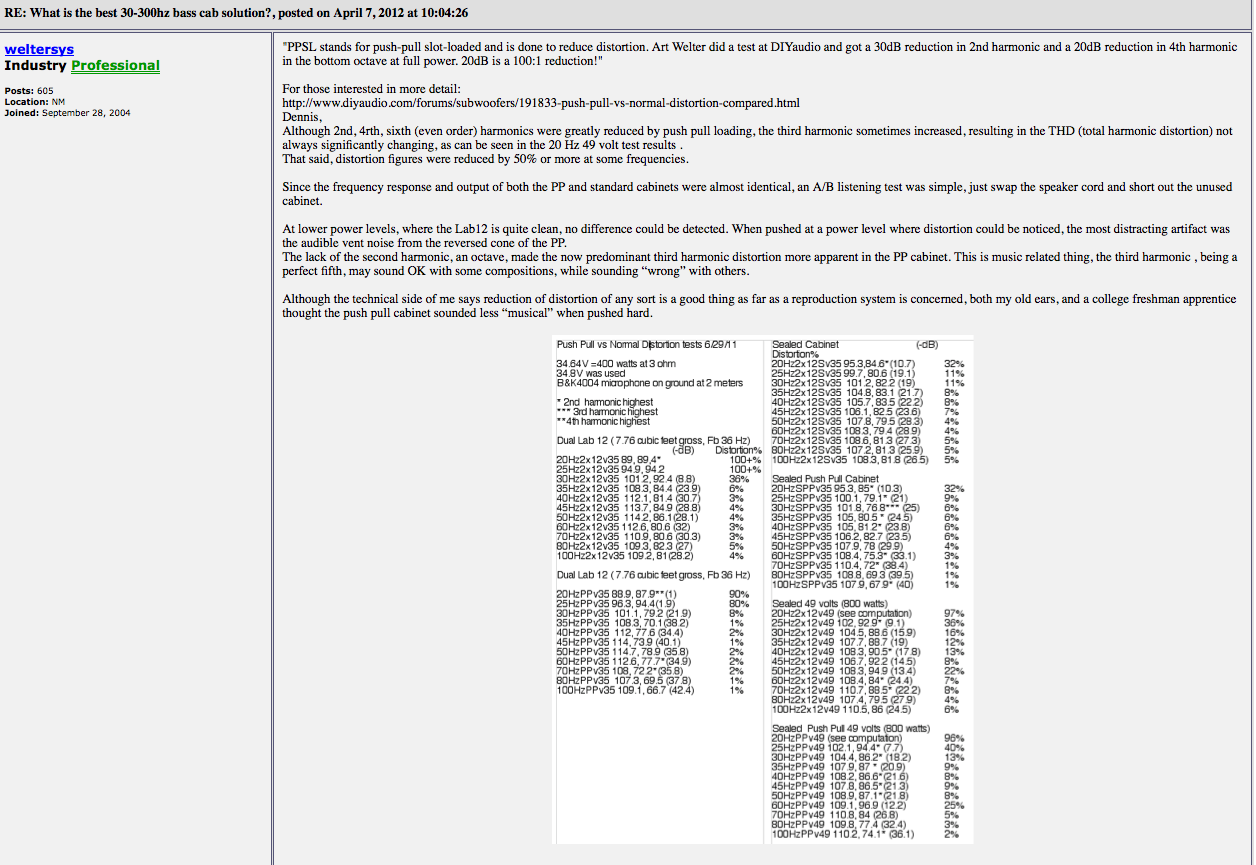

I'd still like to know your reasoning for the statement in Post #76. I'm not trying to start an argument. I just would like to know the basis for your assessment. I know that you have build and measured quite a few subwoofers, and what you say does have meaning to me.
Different cab different drivers,obviously not Art's. It works out in a similar fashion:
I call this the pack up and go home.
