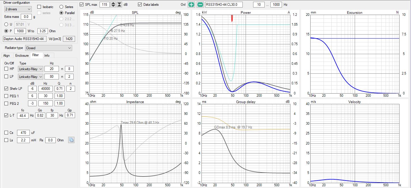

A few days ago, I did a nearly minimum sized design just at 13.5". It is probably legitimately too small, and VCAD predicts power handling reductions and big power spikes at low frequencies. But as a test, what would be an adequate bracing strategy for a small container like this? Maybe a simple tic-tac-toe or hastag bracing scheme, but slightly irregular? #

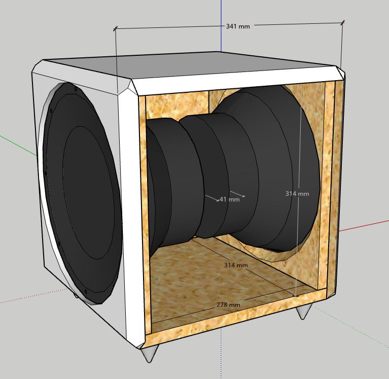

I have these woofers that can be bolted togehter.Note that the magnet is inside the basket. Scott and i worked ona Casle WAW design with a client in Sweden who designed and machined some aluminum fittings for the back of the Scans him to tightly connect the drivers by twisting and locking them together.
This is an illustration of how i first thot i would do it. Shows how ready-rod could be used to hold the bezels together, but having the baffles tighty conected together close to the baffle cut-out. Box width close to the woofer width and additional braces between baffles and top and bottom. With the 10s we used a single brace just off centre that also braced the two drivers together. The minimal box size ( + LW-R transform) here means box all 4 walls act as such.
dave
dave
In this design, I have the bracing a few mm from the magnet and a cutout where I suspect the pole vent will be. My plan would be to put some thick foam surrounding the magnet or cloth to connect and damp it, leaving a gap where the brace has been cut away in the center. Installing the drivers would require compressing this foam, hopefully connecting it to the opposite driver and the brace system. This way any vibration would be reduced by the damping material. Would that be better or worse than direct contact?

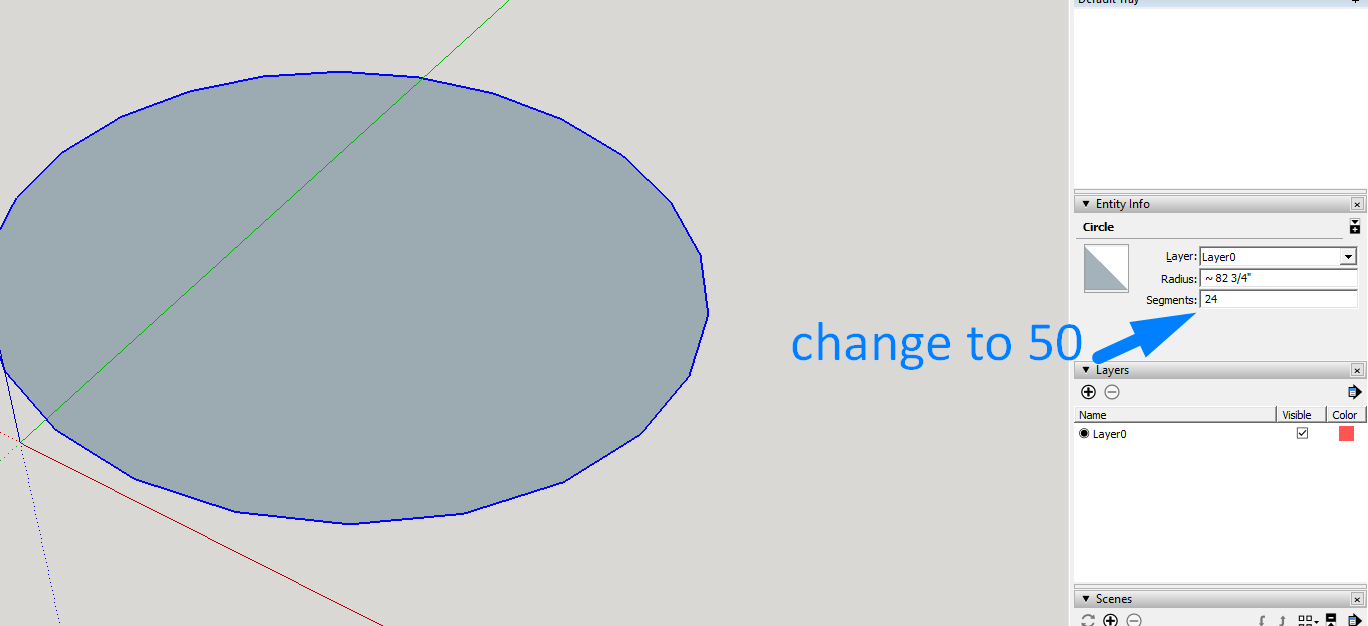

is there any tutorials that help to draw subwoofer and speaker cabinets ? i tried fusion one time but the tutorial was made to make complex moving pieces and parts of machinery, nothing that i found that can help you draw cabinets and internal panels and bracing for tapped horns and bandpass cabinets

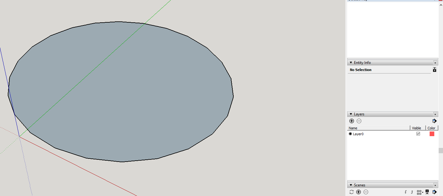

Just to clarify, these are Sketchup drawings, a much lower fidelity software for basic renderings. I wouldn't send a circle cut to a CNC machine from anything less than a Fusion file. IIRC, it doesn't store a curve so much as remember the parameters and draw it as best as possible for each platform. Sketchup draws the most polygonal circle you've ever seen on close inspection, and I've seen the prints.
My favorite, not currently compatible with the MacOS version last I checked due to hotkey changes.tutorials

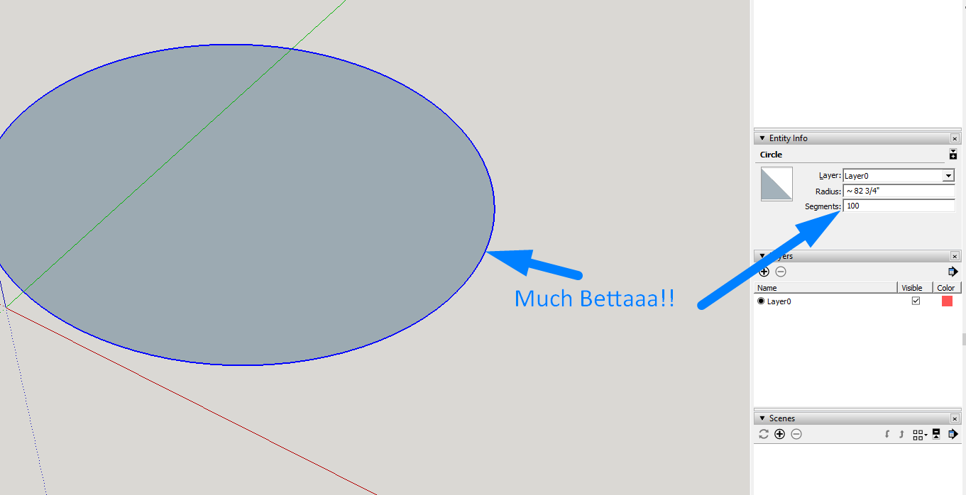

open the inspector on sketchup circle you want to fix
and where segments are , type 40 or 50 and presto!! problem fixed, smooth circles
idk why sketchup made that on round objects,
Sukkk right ?
default is 24 segments
click on the circle outline
change to 50 or 100
FIXED!!

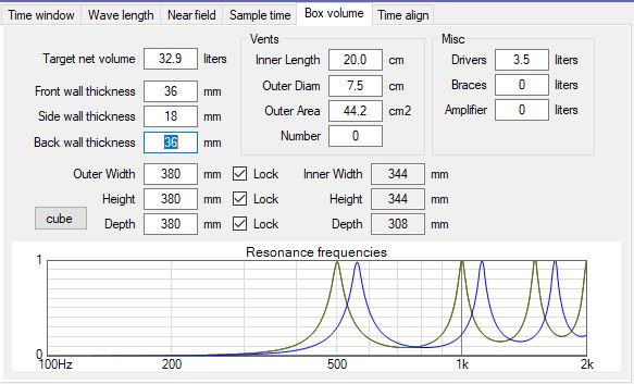

I took a minute to look into my potential panel resonances and final box volumes this morning. Using the 380mm model and some online references, I have a better estimate of the space these Dayton 12's take up. The magnets alone are a full liter+. The cone displacement is approximately 0.7 L. I am going to guess 3.5L for the pair, which leaves me 33L without bracing.
Next I ran a final rough box sim, with no assumptions of accuracy, to see if the final volume would impede on power handling and extension. It doesn't really. In fact, the smaller box volume does a better job reducing excursion at the lowest frequencies without a latency inducing high-pass filter. This is at the cost of efficiency at the lowest frequencies, but who cares about hearing 10Hz anyways?
Most importantly:
With the panel resonances as high as 500Hz, I am looking at a second harmonic in 250Hz/1khz, a third at ~160Hz and 1.5KHz. Do I even need bracing if the panels are stiff enough, and the resonances are that high? Or I could focus on a single window brace that couples the drivers at the magnet somehow. Very simple.
Most importantly:
Nice investigation, I think it's time I learn to use Vcad! I still think bracing is worthwhile, if only to limit cabinet vibration due to panel flex. Not surprised to see that the resonances are well above the sub passband.
I would target a sealed enclosure volume that lets you hit xmax of your drivers given the available amplifier power or driver thermal power limit, whichever is lower. It looks like you've got it pretty dialed in at this point, just make sure the amplifier you ultimately choose can actually deliver the voltage swing with which you're simulating, 57 Vrms in this case.
