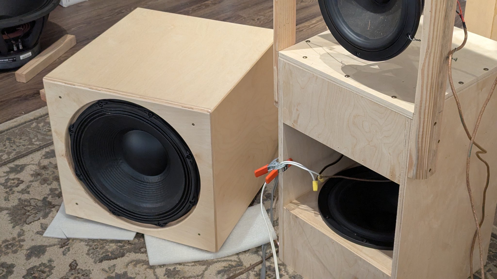

I used a pro driver -- SB Acoustics NERO-15SW800 -- in a 3cf sealed box of 18mm BB plywood well braced much like you're planning, with a 24+18mm baffle. Q in the box was ~0.7 and the rolloff began ~80Hz. Didn't use Linkwitz transform. Used REW EQ feature to get F3=30Hz and F6=25Hz. The driver is 96 dB/W and the 1W response is >90 dB even at ~40Hz. Rated 800W AES. Powered it with 600W. I ended up using it only under 50Hz. Crossed higher, I had the subjective impression of "fatness" even though the FR showed it to be flat to 100Hz in the listening area.

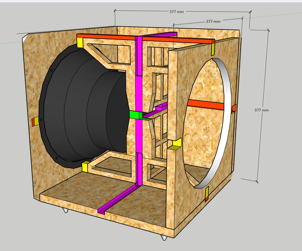

The 12's fit very comfortably in this box once it's scaled up by 1mm in each direction. That brings the scale up to a 15.5" cube for the imperial system users around here. SB Acoustics builds a massive frame for their subs. The internal difference between the 10s and 12s isn't that significant either, just cutting the braces back an inch at most in every direction to fit. I have a few more choices to make, like final materials and their thickness. I am considering a full 3/4" design with a double thick baffle. It would shave 1/2" or 13mm from the outer edges. I may have to redesign the panels into something I can cut and round over, though the long flat corner cuts are appealing to me.
The RSS315 series is listed as having the exact same dimensions from HF to HO. I think the frames and magnets are all reused. After some more sims, the clear winner is the RSS315HO-44. Dual binding posts give me the most flexibility for wiring, the rated sensitivity is the most accurate to the measurements in the sub-bass region. And the alignment requires the least correction in a small box. 20L/driver yields a ~45hz cabinet resonance, which is fine for music playback. Correcting to get equal output at 30hz and below was always going to be a given in my space. But the HO-44 appears to have a better response with less power than the HF-8. All of these subs seem to dip 6-10dB below their rated sensitivity from 50hz to Fs. I have a hard time assuming the response will match these sims and it's why I keep leaning towards overbuilding, though room gain will probably equalize these issues.

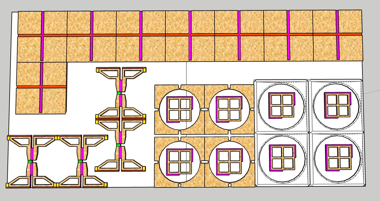

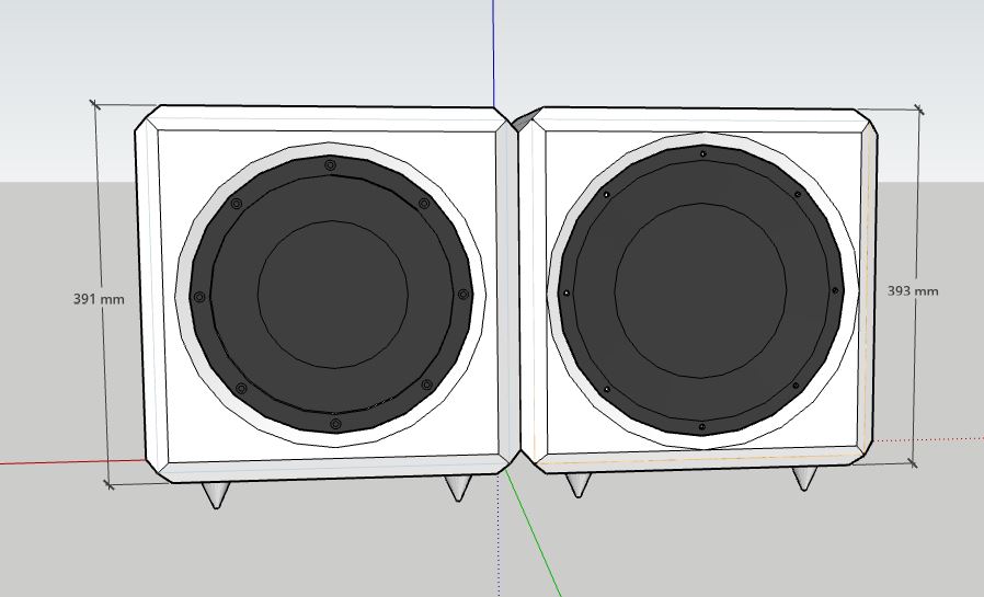

Last update for a while (I think). Cabinets redone in 3/4" or 18mm. This is a simpler set of cuts, all butt joints with smaller roundovers. Designed to roll up like a burrito. All cut from the same sheet, it is just as easy to make two subs from the same standard sheet, I can't figure a way to fold it all into a half sheet yet. The internal dimensions are still the same, between 30-40 liters. I have the front baffle fully sunk with a planned roundover on any excess space inside the circle. The driver should screw into the inner baffle and the cross brace.
The final size dips below 15" total in every direction, ~380mm. It should be a mean little package when it's all over.
I just use the free version of Sketchup. I like doing initial models in it because it's easy to manipulate each line, point or panel. Fusion360 is what I would finalize in, but it's been so long since I started learning Autodesk I would actually have to start over. Sketchup can't do curves as cleanly as Fusion, so prints are better off in the pro software.
The benefit of 3D modeling is twofold, I can "test fit" and adjust parts together before cutting them. And I can check any measurement I want against the model for my own sanity once the pieces become real.
I have a few shops in my area where I can rent a CNC wood mill designed for a 4x8 ply/MDF sheet. There are a couple of shops I can buy short term membership with for larger projects.
The last design is simple enough to be made with a router and saw of any kind, given a good protractor and some straight edges. This model is even simpler, circle cuts are full depth, the only complication being the (optional) braces at ~1/4" or 8mm depth.
