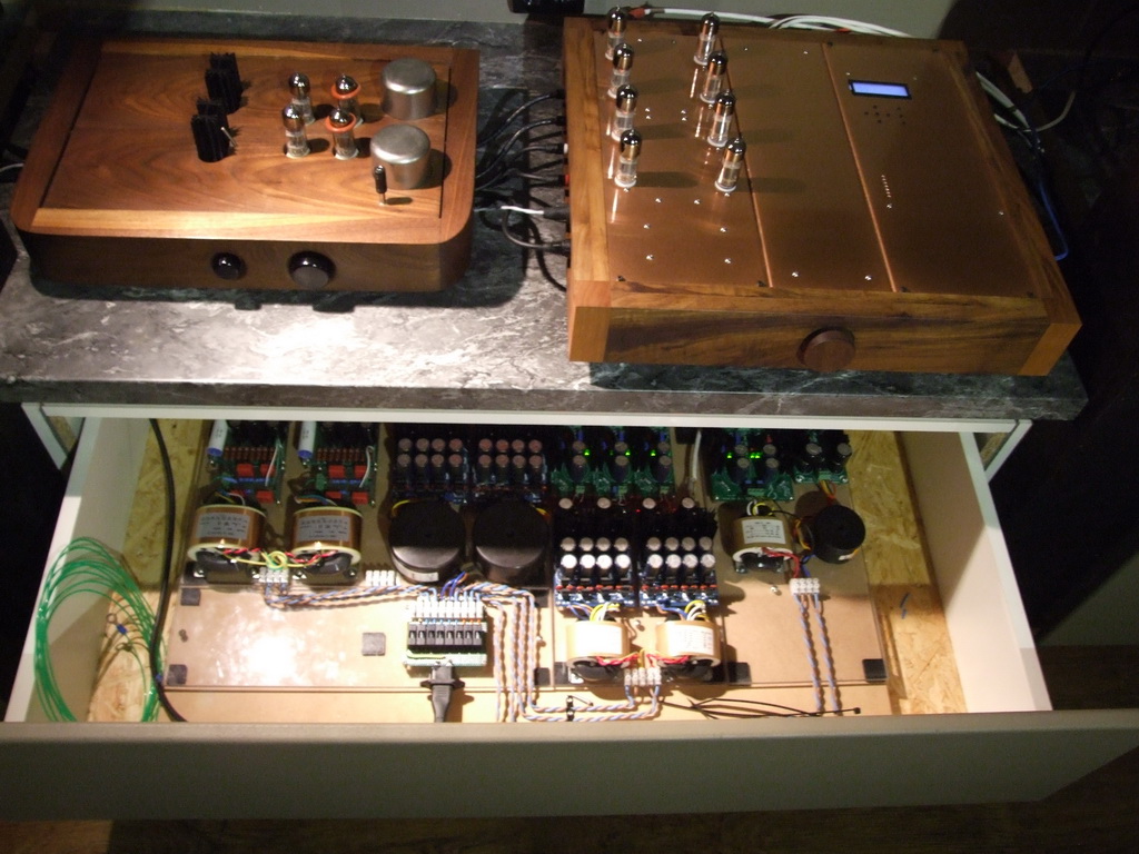

You can see two Stevens and Billington tx-102 on the preamp that's no
longer in use. I belive that this volume control solution is just as god or extremely close.

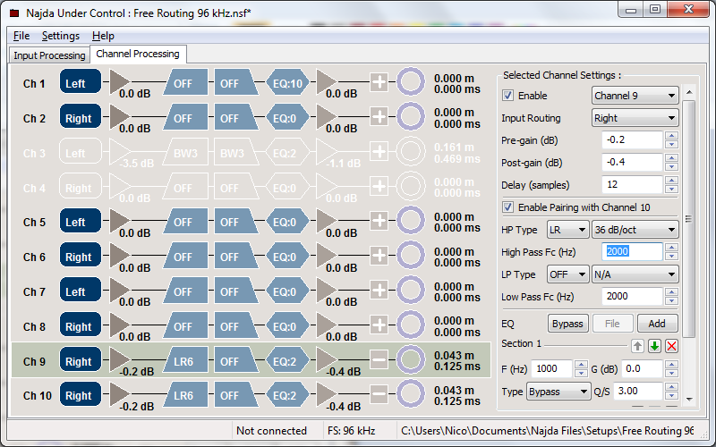

When you paired channel 9 to channel 10 they both ended up as right channels 😱.

Is the new software out?
I belive not. I just posted a screendump of what's coming, posted earlier.
Just installed the latest on this computer and the display of time compensation is updated.
Dont forget to keep an eye on time compensation, when changing samplingfrequency
it doubles distance if the numbers of samples is the same.
Yes 😉 That's alright, and you can have different routing also for paired channels.
