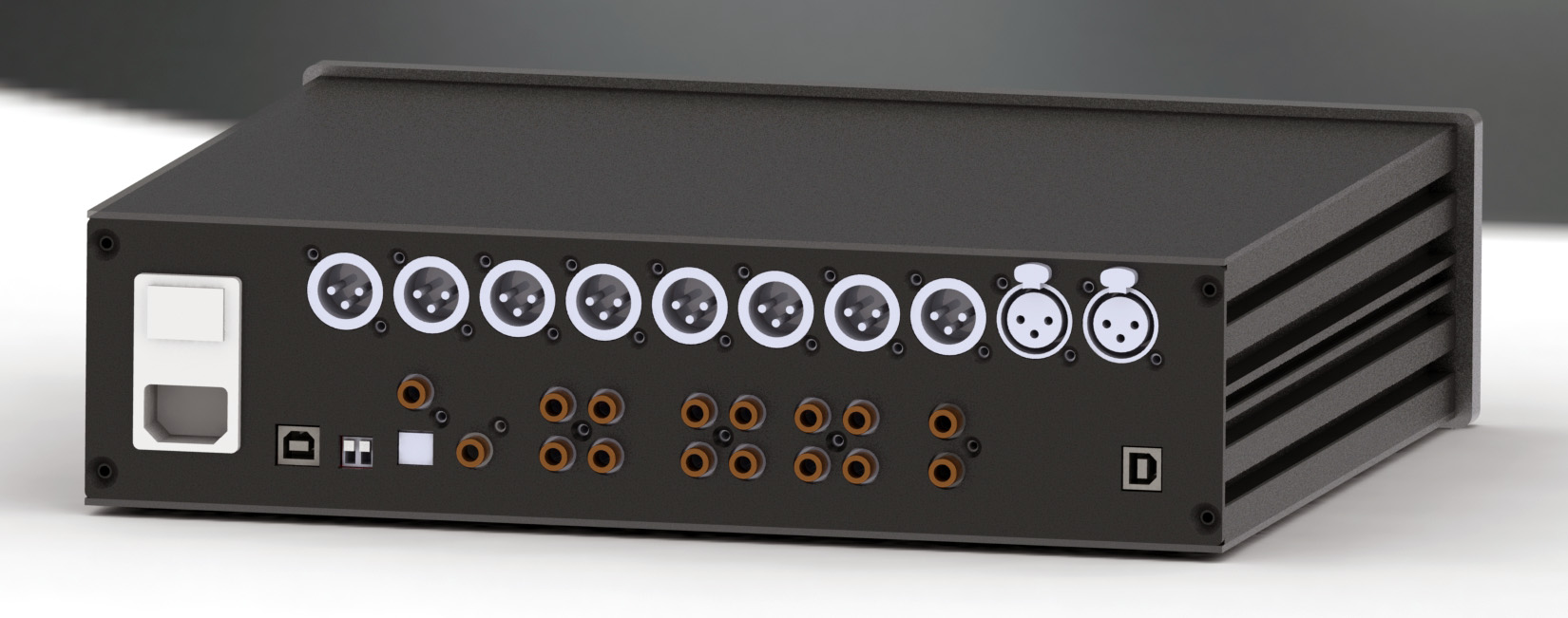

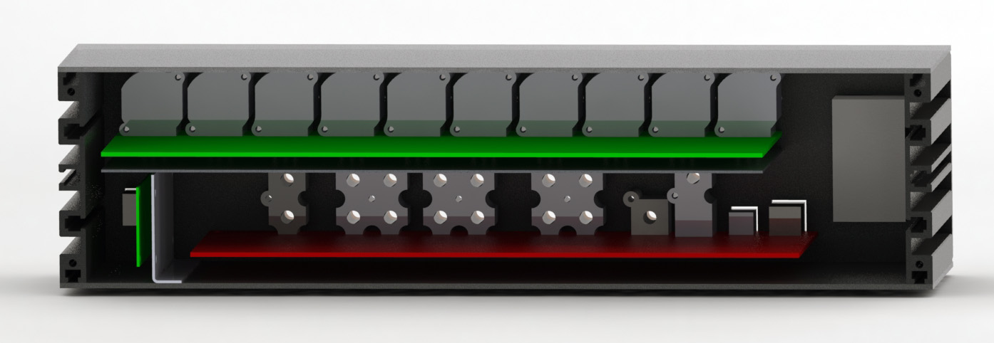

I just finished the 3D drawings of the back panel and some parts implementation. Here are two renderings.
The published Najda suggested cut-outs appendix is validated beside the 201.6 which should be 197.1mm as already said.
Now I will have to design the relative pcbs...

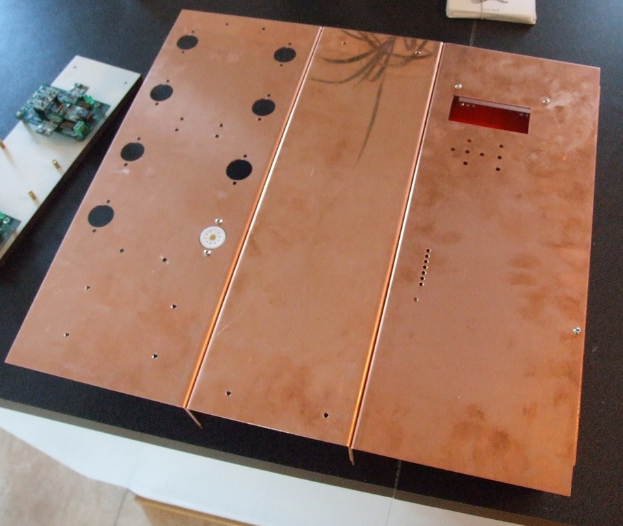

What you are looking at are the three assembled top plates. There will be a surrounding
walnut frame and all in/outputs will be on the left and right sides, Najda to the right. All
power inlets will be on the back. So yes, it will lay like this on/in something.
Like most tubeamps are built, sort of.
