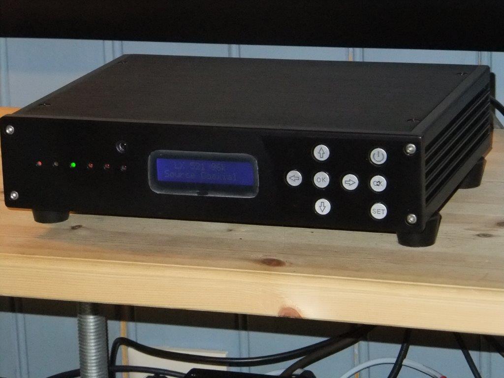

Wow! That's very nice Paal!! Very very nice!!!

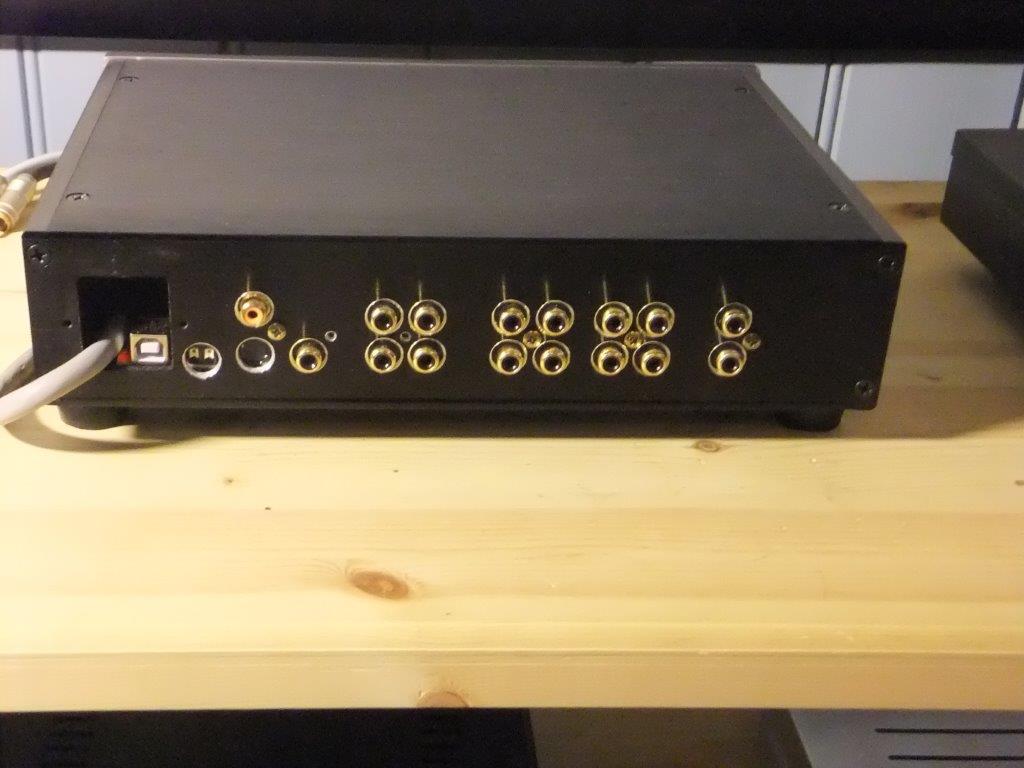

Have you also drilled the rear panel?
Something others will want to ask too: Where did you get these buttons? 🙂
For the logo, how about 'Paal Industries - Norway'? 😀
(Power supply can remain out of the box. There's nothing wrong about that I suppose)

Thanks a lot.
The buttons 2 x Round Cap Power/Arrow/Set/OK Logo Tactile Push Button Switch Momentary Tact LED | eBay
Najda from behind: see attachment.🙂
For the Logo. I'll have a look🙂
