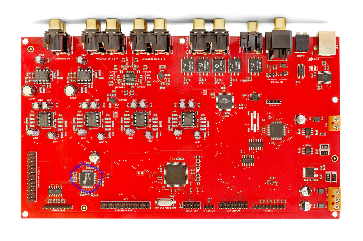

huh? 9023 has an opamp inside it...
I guess you dont mind opamps as long as you dont know it is there?
only current out dacs dont have opamps and even some of them do
besides the opamps on the board are just acting as a buffer, easy enough to replace with a simple discrete buffer/follower if you find opamps that objectionable, even though they probably are used in many things you like.
badly applied opamps sound bad, well applied opamps can sound excellent. I like discrete too, but thats as much about the fun of building discrete circuits.

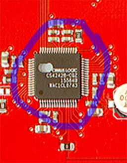

this one - it is DAC and ADC in one IC
I confirm: CS42428, a nice little chip that includes a proper PLL for a low-jitter master clock. Congrats to tomtom ;)
I think I already mentioned the remaining chips:
- The DSP is the dual-core DSPB56725 (500 MMACS)
- The micro is the STM8S207
The default opamps are STM's LM833. They make a warm sound with this configuration, I like it a lot. You can always swap them with your preferred opamp as - a reminder - opamps are on sockets. Swapping takes 1 minute, no soldering required, so if you have a few opamps in your drawer, just go ahead.
I tried a bunch of different opamps and selected these ones based on the result, and on cost because more expensive opamps would have impacted the final price of the board - there's no mystery.
Now you know it all :) (Well the USB controller is a FT232R but i guess nobody cares about that one guy :wchair: )
