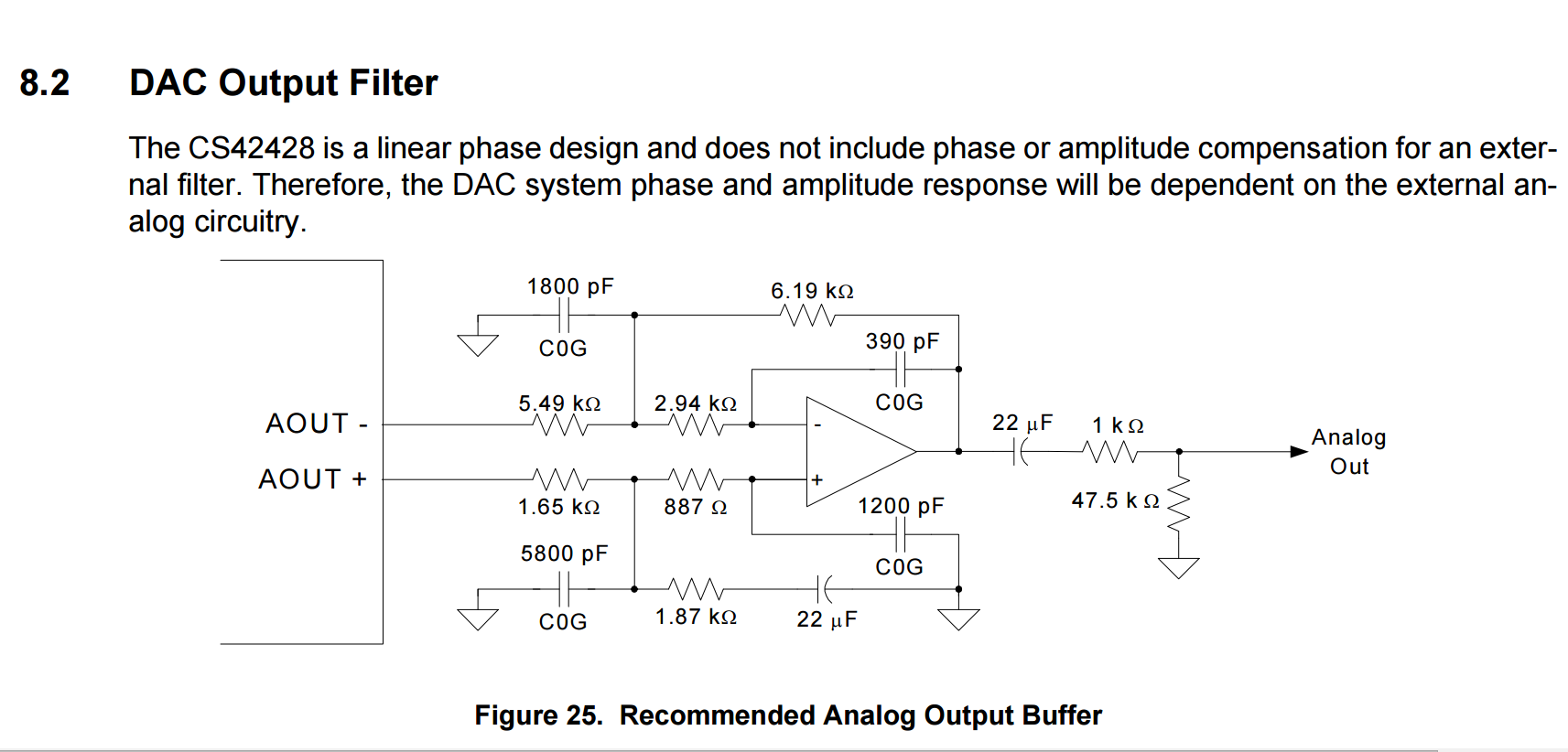

Hi guys,
went ahead with the suggestion from a previous post, so that's how it looks on my side.
It's 6,8uF Wima MKS2 for lows and analog input, and 1uF Wima MKS02 for mids and highs.
In lack of an A/B possibility can't say for sure if it had an impact on the sound - but it feels good and looks good too! : )
Hello!
I'm going to order WIMA capacitors and Its need to be clear how much I need to buy. On your photo I see you changed only two capacitors for each OP amp, but the other guys changed all four. We don't have diagram, but as I understood you changed only input and output capacitors - is it? Do you think, it's not very important to change the other two?

Hi, we changed 4 capacitors per OPAMP based on a circuitry recommended by Cirrus Logic fot that DAC. We don't really know if Nick used the same topology, but it seems logical to suppose that he adhered to the suggestions of Cirrus Logic. You can find the schematic of the output buffer in the data sheet of the DAC. If you only change the output capacitor you only need 2 per OPAMP
Hi! There is a schematic of the output filter/buffer from the manual. As we can see, there are only one capacitor in the signal path. The other is in the filter. If we change 22uF to 6.8uF, we will change the cutoff frequency for this RC-filter from 3.8 Hz to 12,5 Hz and I don't know if does it matter.
