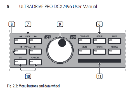

Also I don't seem to need any boost on the deep bass with the really cheap boxes that are handling 20 to 60 Hz; but just in case how do I adjust parametric boost "on the fly" with the DCX?

Moondog,Also I don't seem to need any boost on the deep bass with the really cheap boxes that are handling 20 to 60 Hz; but just in case how do I adjust parametric boost "on the fly" with the DCX?

https://www.parts-express.com/pedocs/manuals/248-669-behringer-dcx2496-manual-41812.pdf
Adjustment requires pushing buttons and spinning the data wheel, if they are not convenient to your listening position, you have to "fly further" 😉

Thanx I got it figured out, for some reason my laptop and the unit didn't want to talk to each other, I was trying to use the remote program.
