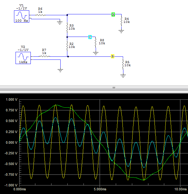

This is how to do simple mixing of L&R, you might find this skill useful at some point.
This is not about filtering bass and treble. All amplifiers will receive a full range signal. I have used two frequencies only so you can see the amount they are being mixed.
V1 is meant to be the left channel signal, V2 is the right. R6 and R7 are the source impedances, don't add these. R4 and R5 are the treble amplifiers, R8 is the bass amplifier/s and R2 and R3 are the mixing resistors.
