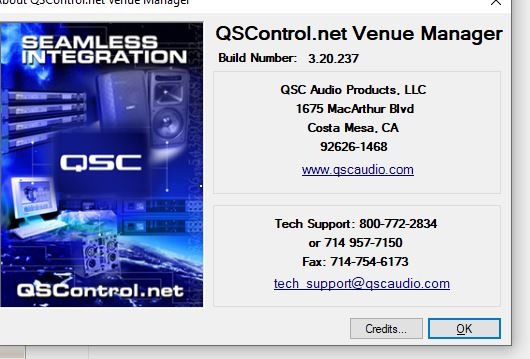

Based on a recommendation from @kipman725 I'm using a QSC Basis 922az. It is ancient so I got two of them off ebay for around $100.00 each. They claim to be balanced 8 analog in and 8 analog out, there are digital inputs, but they are CobraNet which I never found a way to use. They use phoenix connectors for inputs and 15 pin high density D connectors (VGA) for the outputs. I hacked some Amazon Basic RCA to use the outputs. Not quit what you are looking for, but they work great and the price can't be beat. Looks like the price is up, here is one for $199.00.

Hi Jason, no the basis units are not compatible with Q-Sys.does the q-sys software work with the basis 922az units? Forgive me because im knew to this..

It works with QSControl Venue Manager, it is free download off the QSC website, it is under legacy/discontinued product support. Here is a snapshot from the help about.does the q-sys software work with the basis 922az units? Forgive me because im knew to this..
