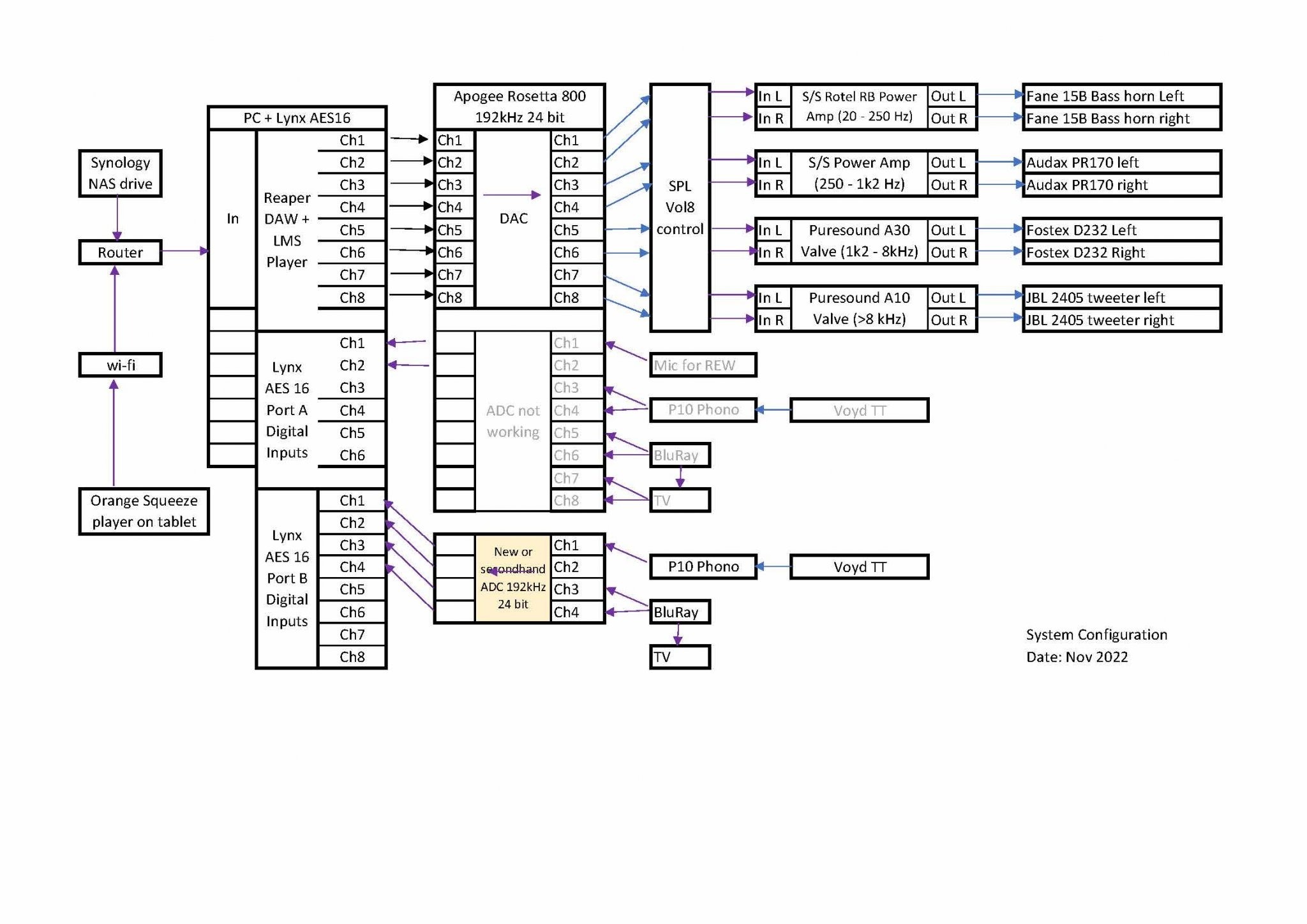

I'm watching this with interest. The ADC in my Apogee has failed and so currently looking for ADC to go into Lynx AES card or alternatives to Apogee. See attached system.
One candidate is Focusrite Scarlett 18i20. This is USB, so all DSP is done inside PC.
If you only want A/D USB the the Cosmos from E1DA is hard to beat
https://e1dashz.wixsite.com/index
I have a Scarlett 18i20 and whilst it works fine the sound is just a little bit flat, not bad but I do prefer the sound of all the other DAC's I've built or bought with Sabre chips in them.

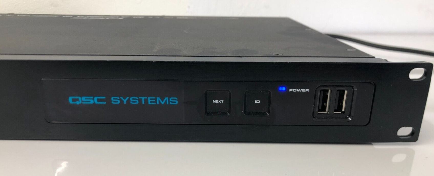

But I'd like to warn folks that I don't think it's presently a good time to dive into Q-sys....if looking at a used 110f.
Parts supply disruptions halted the production of new Core110fs. Which has put crazy price pressure on the used ebay market.
Pre-covid, with any patience at all, a used 110f could be picked up for around $1200.
In the last couple of months, I've seen them trade crazily for over $4000. i just sold one for $2700.
There's a new 110f v2 out, that doesn't have GPIO (which home use doesn't care about)..but I don't know price or availability.
Also, there are widespread reports of Core110fs that have been in use for a number of years, having SSD failures from previous versions of Q-sys Designer, causing excessive read/writes.
QSC is a super solid company and is warrantying units sold within last 5 years, but who knows age when buying in the used market.
The SSD failure apparently hangs the unit up on startup, and it can't get past this opening screen....
So anyone shopping used should make sure they get picts of the LCD showing status / firmware /etc....that proves no lockup.

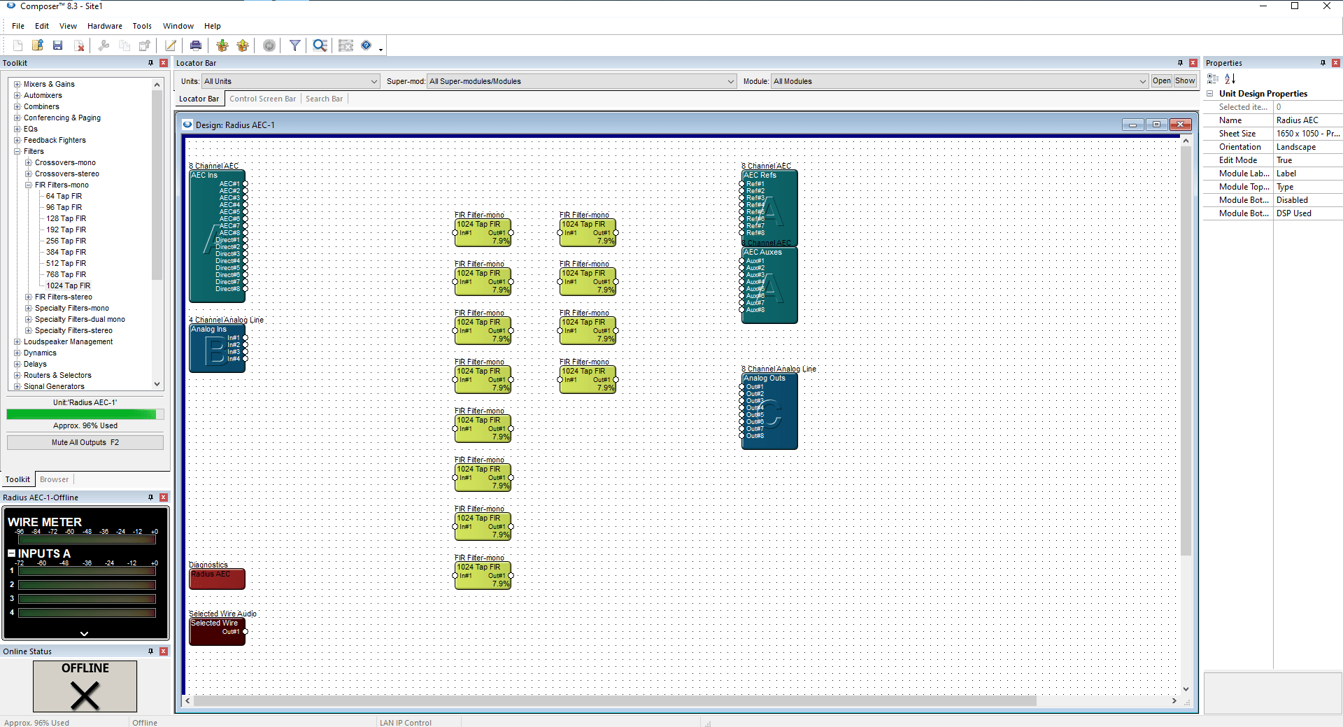

These older Cores are incredibly powerful...much more so than a 110f, and for me, increase FIR capability to all i can eat, 16k taps per channel.
