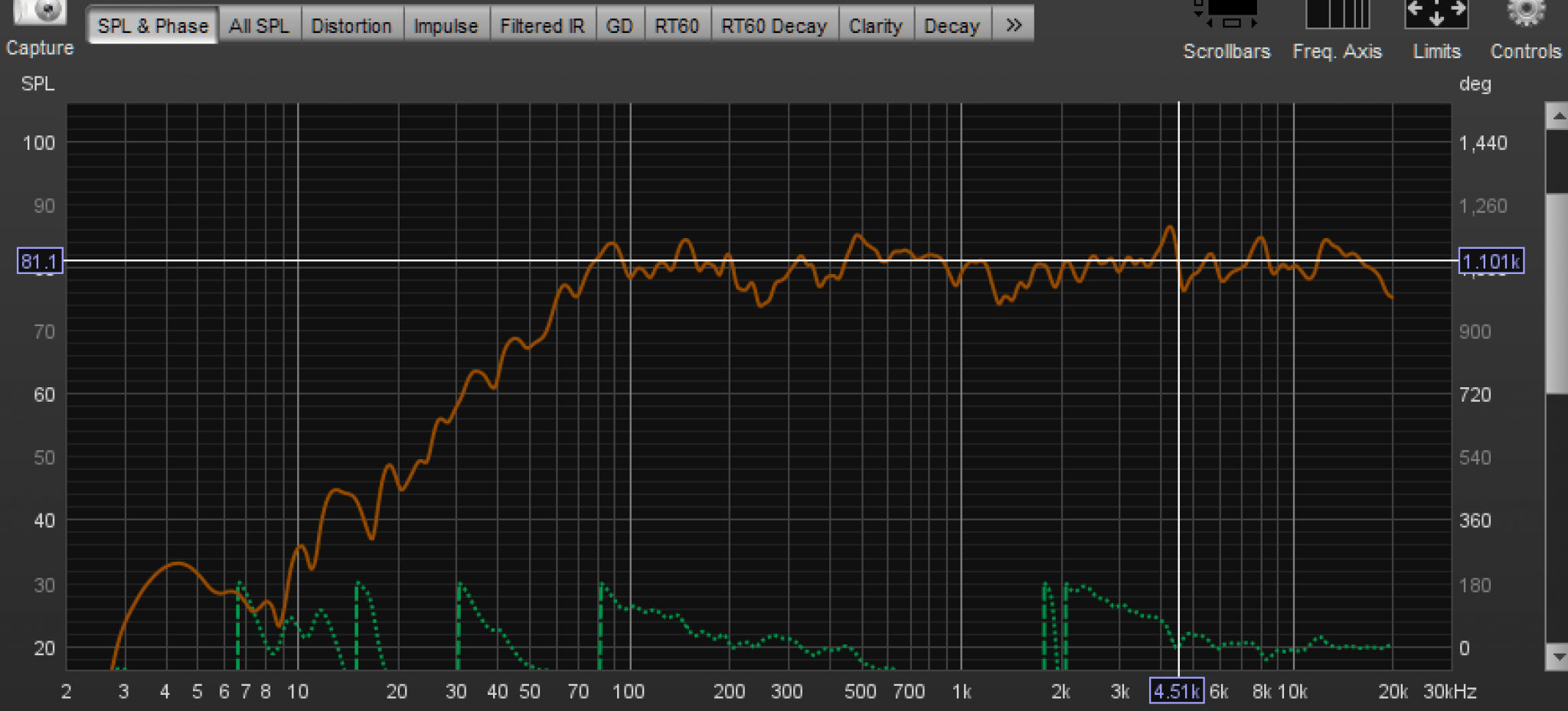

recently i picked up some 700hz-4.5khz crossovers from aliexpess, i still noticed a really large mid bump so i stuffed the boxes with pillow stuffing and put a 3db l-pad on the tweeter night and day difference..

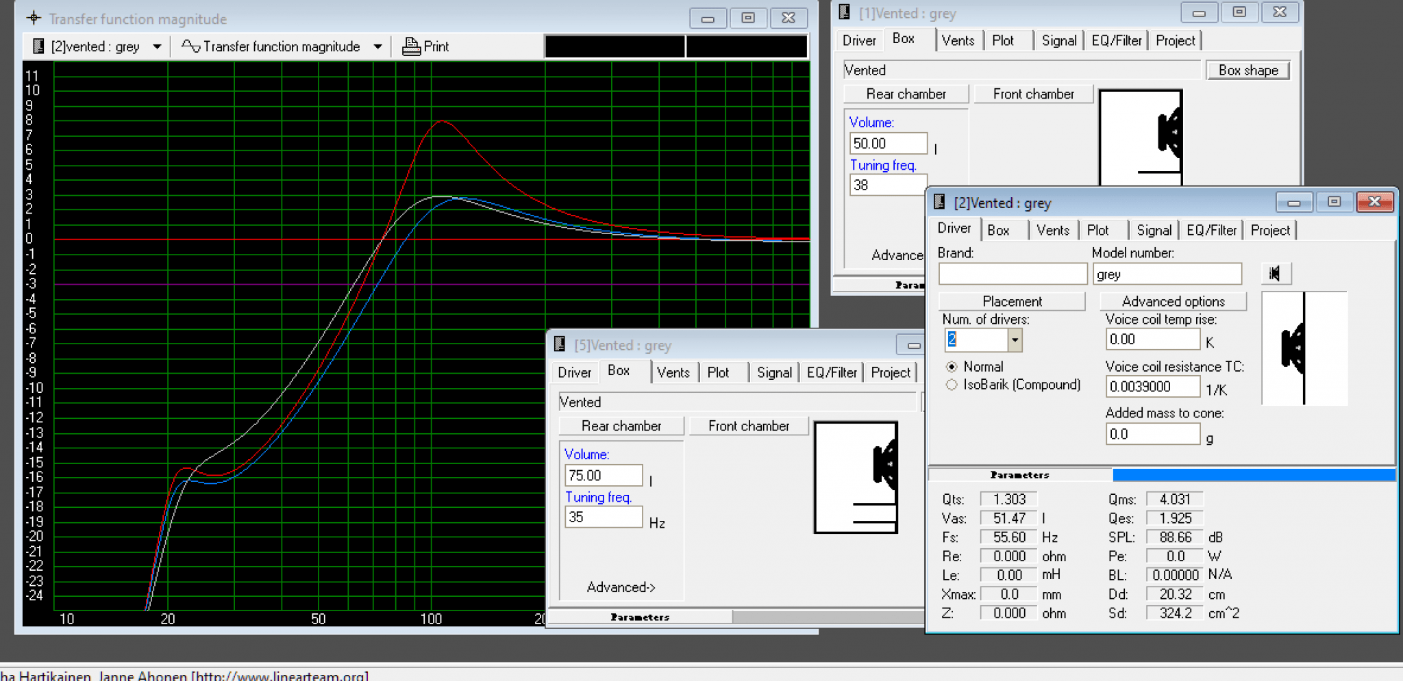

but why stop there after pulling a bass driver i messured a qts of 1.3 after playing around in winisd i think a stuffed vented box of 75l will be just about perfect to tame the midbass hump. so i will get some plywood at a later date and give it a go
after aliexpress crossover stuffing and 3db lpad mesured in the middle of a room
red = stock, blue = stock tuning and stuffed. white = 75l and stuffed looks to be 3db down a 60hz perfect for use with a sub

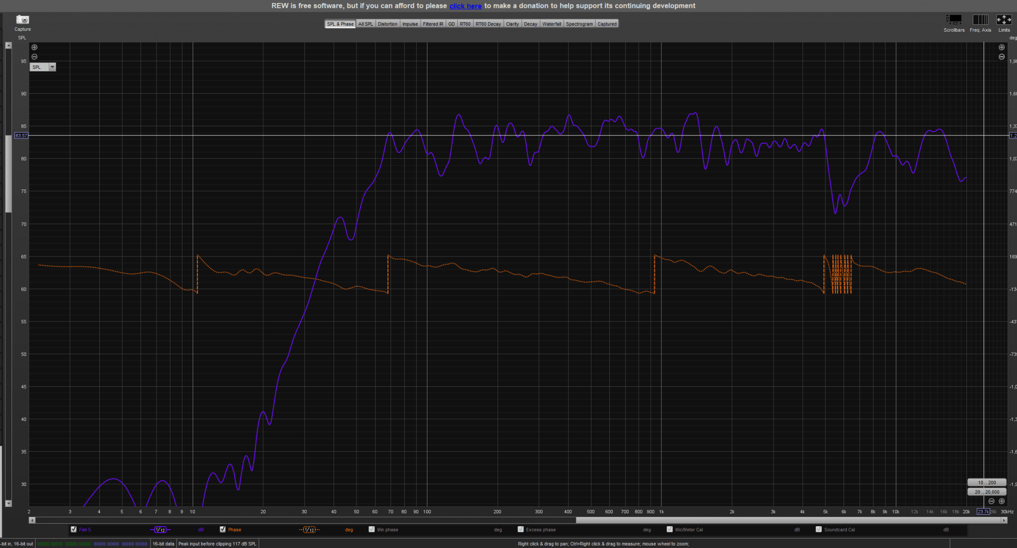

after some more playing later. i have to say the boxes are very thin, smearing bass lines and adding a sort of muddy tone to speech.. i changed the mids on 2 of the speakers and i honestly love the way they sound. however differently beefer boxes would help.. i changed the phasing of the drivers around to help with a peak at 5khz across the room at listening position that did is not there, just can find the acoustic centre
