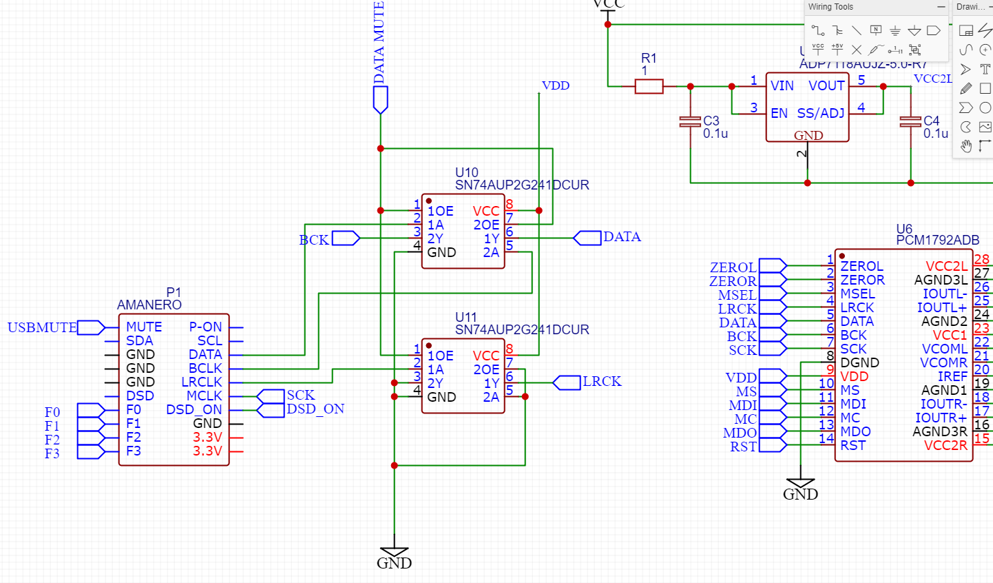

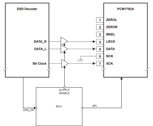

Sorry for delay in my replies. We are preparing polish RSD drops and it takes a lot of time. I've recieved support from TI forums, see attached. They recommended using a tri-state buffer, e.g. SN74AUP2G241. I think I'll try that approach plus sw muting, plus hw muting (mix of Amanero and uC for PCM inputs).
Up to you. If that's what you want to try, then try it. If it doesn't work maybe try what Thorp described.
Remember, it may be you are planning to use the chip in circumstances not envisioned by its designers so you may have to experiment a little at some point to get the project working the way you want.

IIRC what Thorp found that was Amanero (or XMOS) MUTE (and or maybe DSD_ON) should directly gate off LRCK,etc., to the dac chip, and MUTE (and or DSD_ON) should also be read by the MCU. The MCU should then have the option continue to gate off LRCK, etc., a bit longer after Amanero resets its MUTE signal, if found to be necessary.
The reason for MUTE/DSD_ON to gate off LRCK directly in hardware is to make the gating happen as quickly as possible, which even then may not be fast enough to prevent a pop noise or some other problem such as lockup. Going through the MCU to start the gating will definitely be slower.
EDIT:Obviously, if DSD-ON were used to start hardware gating, then the MCU would need to be able to override that gating after dac registers are programmed to accept DSD.
If hardware gating is not fast enough, then LRCK and the other I2S signals may need to be delayed in a D-Type Flip-Flop (or maybe a two-stage FF delay) so that gating-off can take effect before DSD gets to the dac chip on LRCK pin.

I think I have an algorithm ready to go:
Amanero gives MUTE flag everytime it changes format or sampling
Everytime MUTE flag from Amanero forces tri-state buffers into high Z state and mutes the output
uC recognizes audio format with Amanero flags and DSD flag, sets PCM1792A into proper mode
Tri-state buffers are released and data reaches PCM1792A
I just hope it will be fast enough to be impossible to notice when playing.
