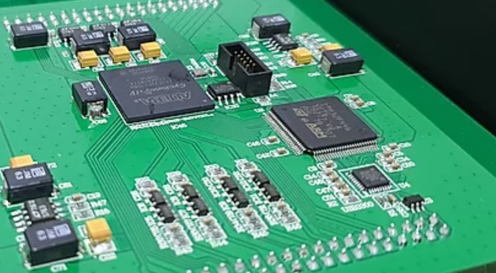

If you didn't settled on digital interface, check out this review.
Measurements of GUSTARD U16 USB Digital Interface | Audio Science Review (ASR) Forum
The reviewed device is a Gustard U16 digital interface. There's a 60$ Chinese reference unit which outperforms much more expensive Gustard unit.
USBAS318B PCM1536 DSD1024AmaneroXMOSI2S-
USB digital interface AS318B PCM1536 DSD1024 compatible with Amanero Italy XMOS to I2S|Digital-to-Analog Converter| - AliExpress

@terranigma: Very, very interesting with the USB adapter you linked to - I've been waiting for someone to develop a 1.536 MHz interface for a long time, and now it finally appears to be here ... I did try to download the user manual but I ended up in a dialog box with non-translated Chinese so I couldn't get any further. You wouldn't by any chance have a user manual that you can share (e.g. by email)? ... A P.S.: Came to think of if you know that it actually works - drivers etc.?
I came across this unit accidentally. I don't have it yet but I will order it. For 60$, that jitter performance is ridiculous in my opinion. Seller on Aliexpress has sent me the manual. It is in Chinese but since it is a technical document, Google translate does it fairly. I'm attaching the document here.
Windows srivers are here. You can alter USB ID's of the device in order to use with other device's drivers.
Support – XING

It is not possible for XMOS to decode PCM SR higher than 768k, since it only accepts 50MHz clock as maximum - see their datasheet.I came across this unit accidentally. I don't have it yet but I will order it. For 60$, that jitter performance is ridiculous in my opinion. Seller on Aliexpress has sent me the manual. It is in Chinese but since it is a technical document, Google translate does it fairly. I'm attaching the document here.
Support – XING
Good point but device is not XMOS based.
