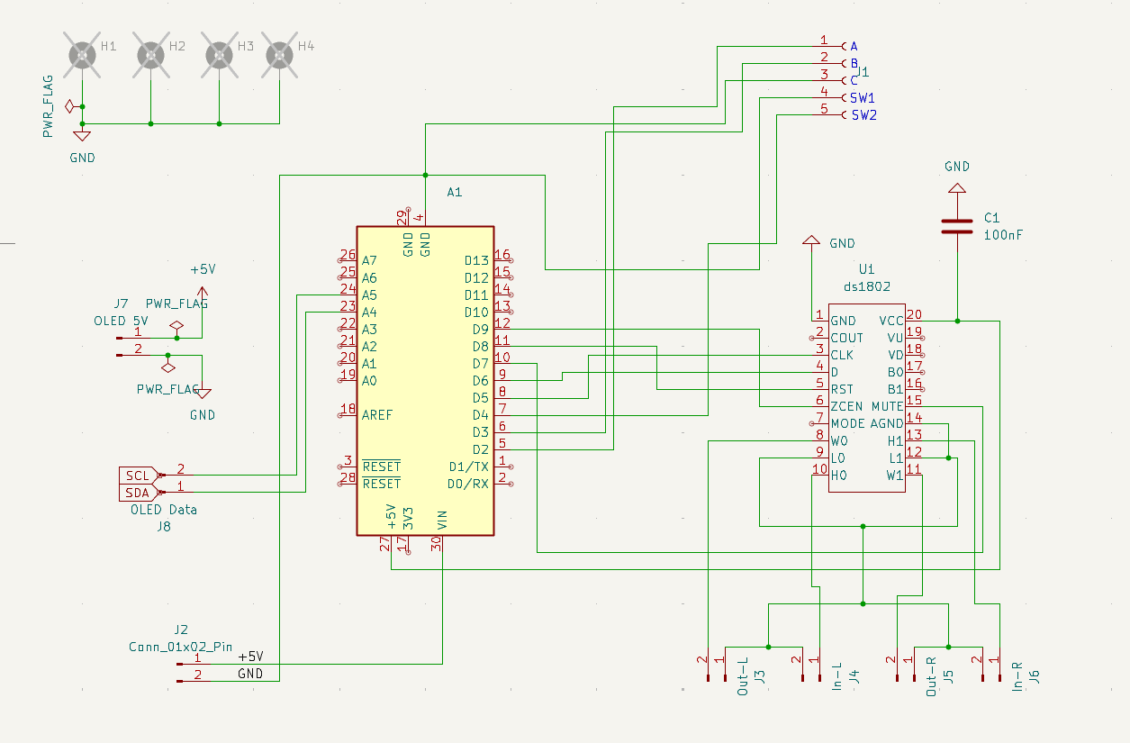

I managed, with some help from AI, to create this schema for a digital volumecontrol, using a DS1802, Arduino Nano and a rotaryEncoder.
It will be connected to either a OLED display or a 2 x 16 LCD, have the code for both.
Does it look correct ?
Have i missed something ?

Hi. I'm not familiar wirh ds1802, but about arduino - you should leave d0 d1 digital ports alone, don't connect anything to them. They are rx tx ports, used for code uploading over USB, also useful when debugging code and send variables through serial port, to view them in serial monitor in arduino ide.
Also about rottary encoder connection.
If it contains a push button and two switches, connected one by one while rotatong, you can use regular digital portas like d2 d3 d4 etc for encoder connection, and use input internal pullup defining in code, internal pull-up resistor inside cpu will be turned on then and used, less parts count. Now you have pushbutton connected without external pull-up, but maybe you plan to enable it in code?

Ahh, will change the pin and use D2 & D3 instead.
The rotary is: Rotary encoder,code switch EC11 audio digital potentiometer,with switch,5Pin

Unfortunately the DS1802 looks to be obsolete, a DS1882 chip looks like a good chip that is available (DS1882 Datasheet).
It is SMD, but it looks workable.
Well its normal to use the SPI pins for a clocked serial interface like this, i.e. SCLK and MOSI talking to CLK and D on the DS1802. Also you must interface the #RST line to use the serial interface as it the equivalent of a chip select (but positive logic, not negative logic as is more usual). See the description and timing diagrams in the datasheet.I managed, with some help from AI, to create this schema for a digital volumecontrol, using a DS1802, Arduino Nano and a rotaryEncoder.

Hmm, i understand that as i should put RST to GND as well ?Also you must interface the #RST line to use the serial interface...
Thats what i've seen on some othe schema's, but when i asked chatGPT, CoPilot & Gemini, they all three answered that i should leave RST not connected.
Now i'm confused.
Read the datasheet, don't follow AI's for circuit design, they are cargo-cult designers without understanding. The datasheet says #RST must be used when driving the serial interface.
I suspect the AI's are tripped up by the fact that some circuits don't use the serial interface at all. AI's are trained on any old stuff out there, low quality data, basically.
As I said see the timing diagrams, its Figure 6 in the version of the datasheet I found.

hi @iceman, never worked with DS1802, but saw your schematic and I took a Quick Look to datasheet and there are a couple of things that should be checked.
Mute line of DS1802 should be connected to a dedicated Arduino Pin whilst now it is connected to the B channel of rotary encoder (and the relative Arduino PIN).
W0, L0 and H0 on DS1802 are the three pin that connect to the internal “potentiometer”
So you should connect input to H0, output to W0 and L0 to GND. The same for the other channel with W1, L1, H1
hope this help
