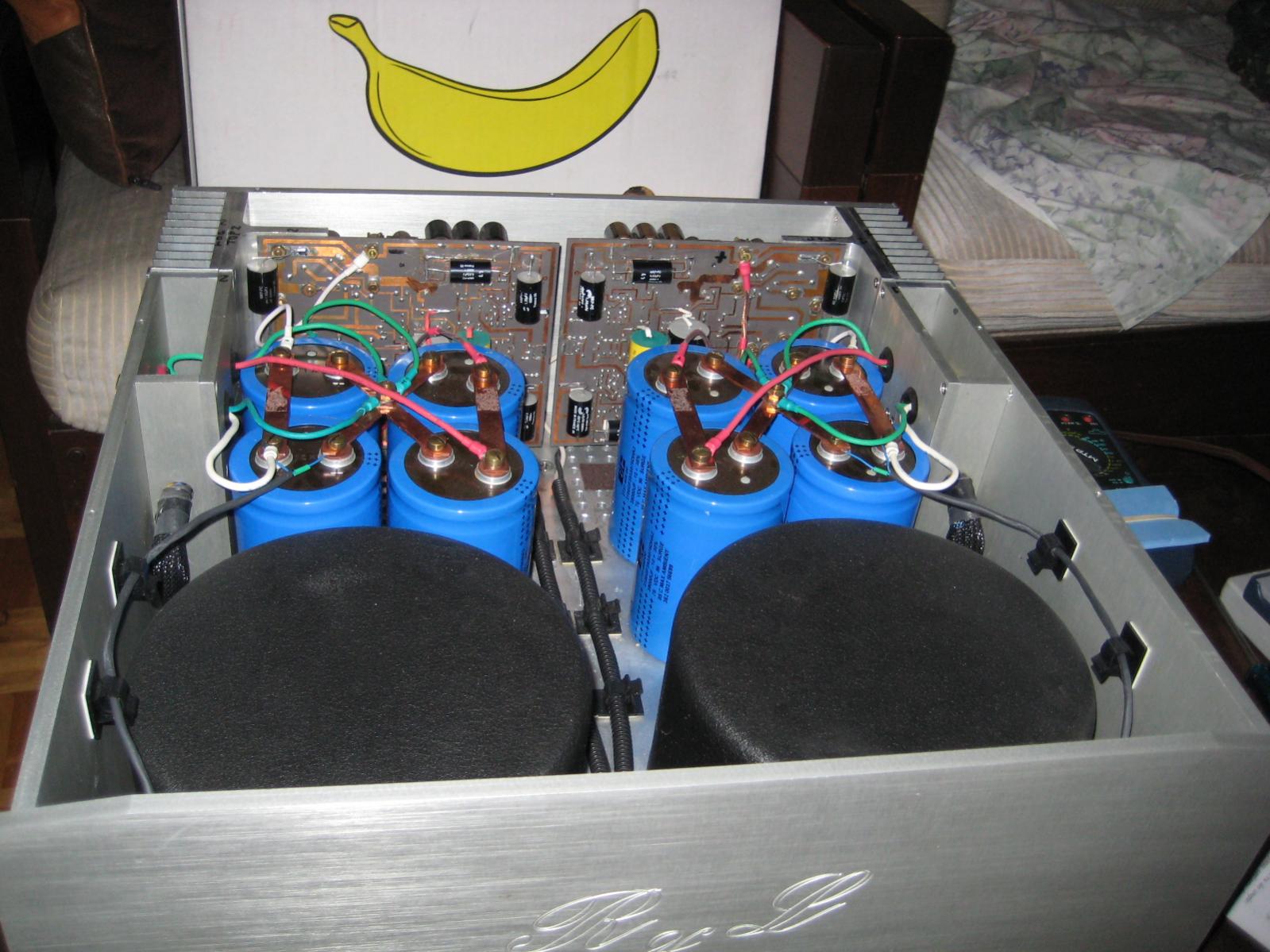

Actually in low voltage equipment (i.e. dacs, preamps, ecc.) i see that toroidals are much more common.
Nevertheless I also remember an old interview of Mr. Curl where he was sustaining that split bobbin transformers have some advantages when the task is to suppress high Hz noise coming from the grid.

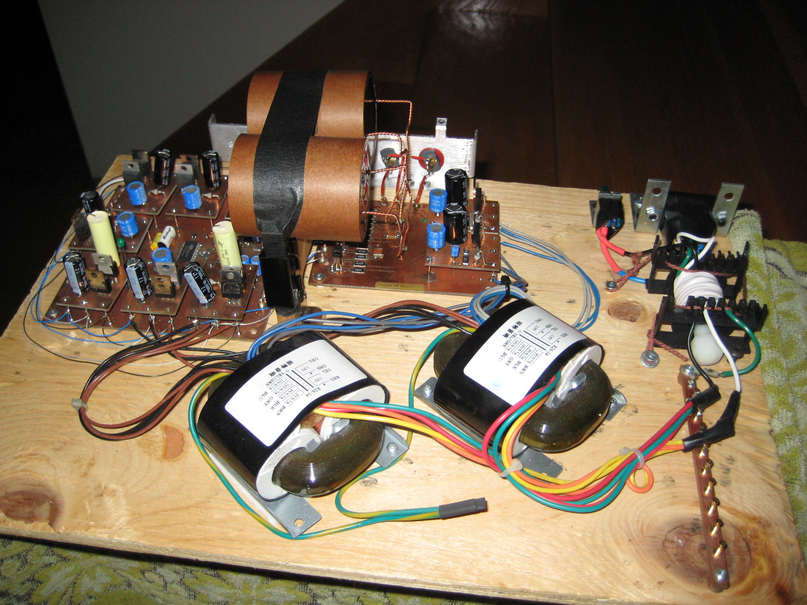

Something like the one in the picture i guess.
or another type

Toroidals are more "transparent" to grid noise. They tend to let it through passing the task of suppressing it to following stages.

I do not know the types shown, but with a round toroidal transformer you will not go wrong. If you want to spend a lot of money, then take a guy with shielding between primary and secondary.
Quite some outdated info in this thread. Best transformers for audio light use (let's call DACs and preamps "light" use) are Rcore transformers very closely followed (if not exceeded) by split bobbin types and the least preferable are toroids. Toroids however are relatively cheap, most easy to mount, have a low stray field and they are most easy to find. This explains their popularity. For power amps I am not the one to comment. If Rcore transformers would be as easily available as toroids I think not many would use toroids. I use them too as they are cheap and not every project needs the best transformer available. However, I have experienced quite some times that toroids hum because of a slight DC component on the mains voltage. Something you will not likely experience with split bobbin or Rcore types.
