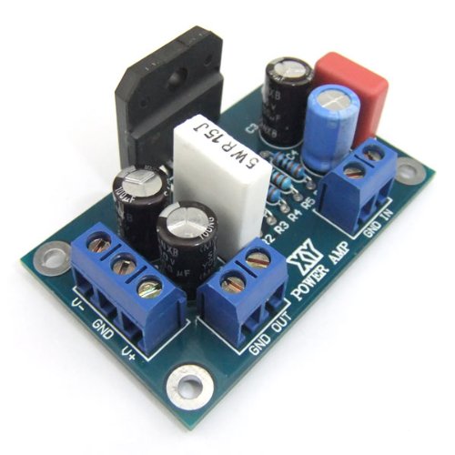

DROK LM3886TF 60W 20~28V amplifier on Amazon Prime
Anyone familiar with this amp?
I'm looking for something small like this, that does not have volume knobs or anything else sticking out of it (space constraints in enclosure).
Amazon.com: DROK HI-FI Digital Stereo Power Amp Circuit LM3886TF Small Audio Amplifier IC Mono 60W AC 20~28V: Electronics
Product Model:LM3886TF
  • Operating Voltage:AC 20V~28V
  • Output Power: 60W
  • Resistance:1% copper foot metal film
  • Can monolithic or used in parallel
Basically, I'm wondering what type of power I'll get with my application?
I've got a single 4 ohm, power hungry speaker.
And I think my battery setup will be ~12 volts?

You'll want something the full width of the PCB and the height should be say 75mm with a depth of at least 30mm. Choose a black anodized one over plain shiny aluminium.
As regards to power output, with 6 cells into 4ohms, you'll have about 8WRMS.
8 Watts?
So is the 60 watt rating just specs BS or is this a limitation of the battery pack?
I need about 33 watts minimum for my single channel portable speaker and it's got to run on battery. Any suggestions?
I appreciate the help. I'm way out of my knowledge level when it comes to this battery pack stuff.
Yes, you're limited by your relatively low voltage battery pack. 60W is achievable but you'd need something like 70V total supply as well as a bigger heatsink. I was going to suggest classD but I see you've already discovered that 🙂
Note that with this new board and the same 6 cells you'll get round about your target power. However 6 freshly charged 18650s will exceed the maximum voltage rating so I'd suggest reducing the number to 5.http://www.diyaudio.com//www.pinterest.com/pin/create/extension/
Glad you saw the light with class D and portable battery powers application. The class AB chip amp would have chewed through batteries like nothing. LM3886 is almost a heater from my experience with them.
The Sanwu 3118 PBTL monoblocks are the BEST stock class D amps you can get for up to 60w operation but run them below 40w to keep sound clean.
