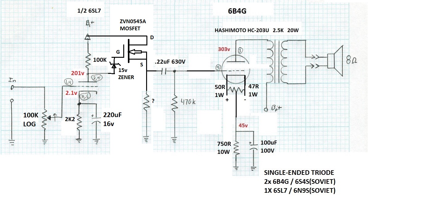

The amp chassis only has 3 octal sockets, so my options for driver tube are rather limited; I've been using a 6SL7 with 100K on the Plate and 2K2 on the Cathode with 303v supply. Here's the schematic with voltages.
Being a tinker, I can't help wonder if this is the absolute best way, and some reading through old forums has given me the idea to try a 6SN7 as driver with 27K on the Plate and 1k5 on the Cathode. A look at the charts in the RCA manual tells me to swap out the following grid leak resistor with 220k, or perhaps smaller? Would my bypass cap need to change as well? Coupling caps?

Will it work? Is it worth it? Should I change anything? Any Miller Cap issues to worry about?

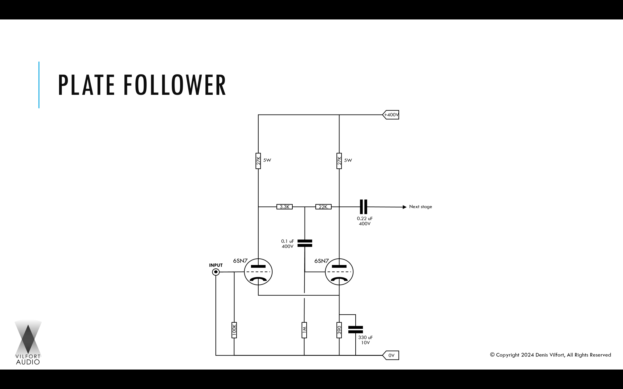

Another way to play here is to make use of a full 6sn7 in a plate follower arrangement.
Volage gain can be adjusted by the ratio between the two resistors between the two plates.
Have fun.
Have fun.

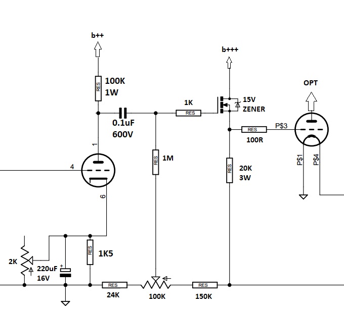

If you are interested in this direction (i.e. keeping the 6SL7 and adding a MOSFET follower) you could check the Tubelab TSEII design for how George Anderson implemented it in a similar amp. Schematic and BOM are in the first post.It does sound interesting, but I know very little of this new-fangled Silicone. I see you've started a thread or 2 on the subject. Maybe I need to check the MJ book. He loves the little sandy bits.

The MOSFET follower is not hard to implement. I am sure you have found this internet link: MOSFET FolliesIt does sound interesting, but I know very little of this new-fangled Silicone. I see you've started a thread or 2 on the subject. Maybe I need to check the MJ book. He loves the little sandy bits.
For 6SL7 just use ZVN0545A. Make sure to use a 15V zener diode to protect the gate, and try not to exceed the 700mw power limit to the ZVN0545A.
It seriously takes up almost no space, and yes, you will hear the difference right away. Even a wimpy 12AX7 can effectively drive a 300b when using a source follower.
I suspect that's how AmpsandSound uses a single 12AX7 to drive a pair of 300b tubes. thanks for the info!
So it's creating another gain stage using a MOSFET and I don't have to drill any holes in the chassis. cool.
Something like this?
I assume the resistor controls the current thru the device and should be measured under use to optimize. I see 20K 3w in the TSE BOM.
EDIT after looking at the TSE schematic again I see the above drawing is wrong. standby.
Ok, is this it?
If I'm reading the schematic correctly the TSE-II has a negative voltage rail that supplies the MOSFET Source. My amp doesn't have a negative supply. Is this necessary?
I see another node in the power supply was created to feed the Drain of the MOSFETS. Simple enough.
I'll stick to a traditional plate resistor for now.
Is that Zener the one you were saying would protect the gate?
