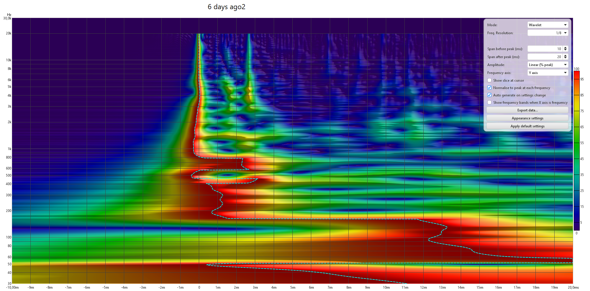

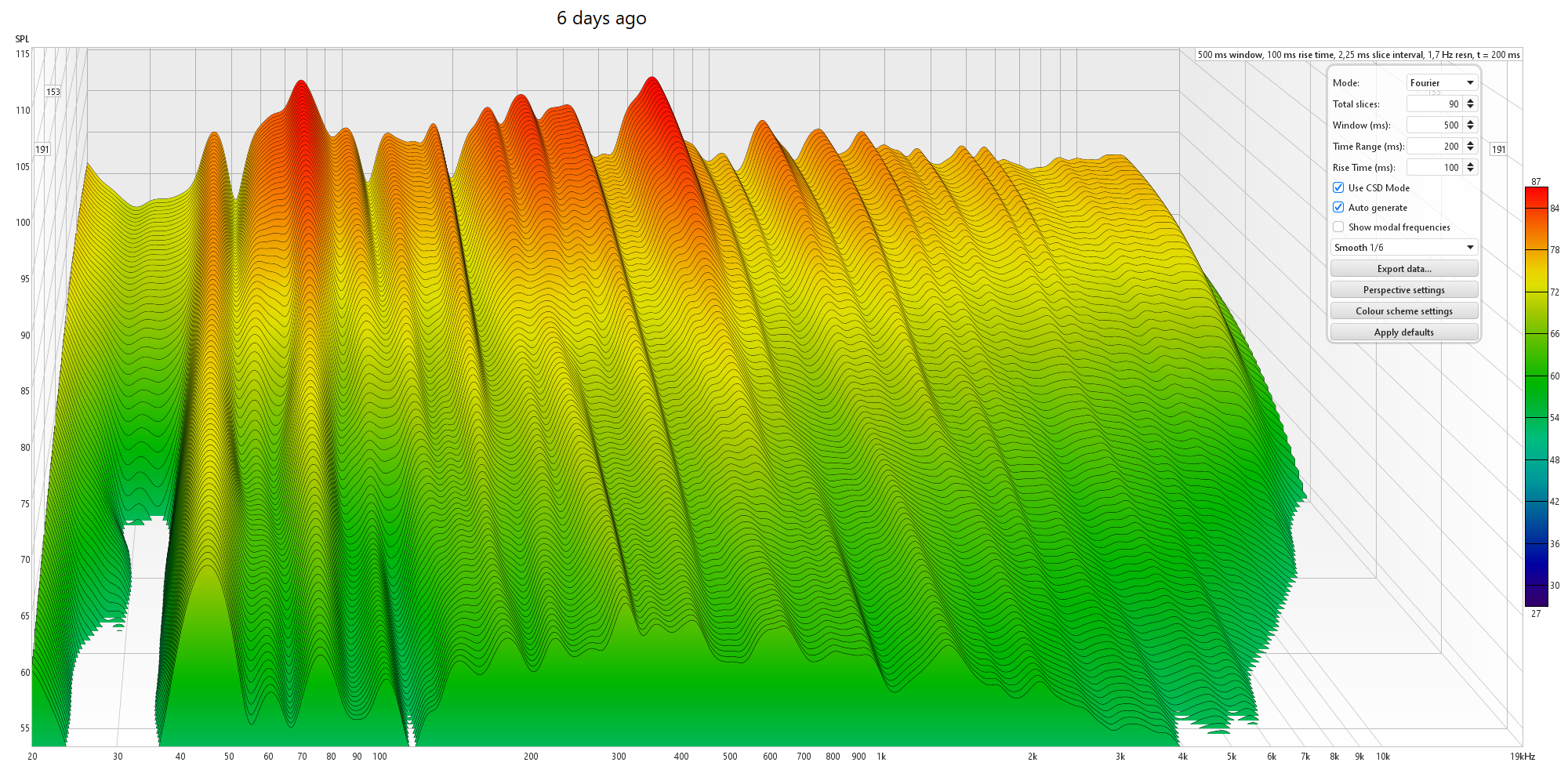

The graph at post #36 shows the LF 100 Hz or so decays in about half of the time frame, but from 200Hz upward until the tweeter Xover you have a very slow decay? I am guessing in matching Daves time you have picked up some reflected data. Even if this is the case it doesnt explain why the the drivers are taking so long to decay across so many frequencies.

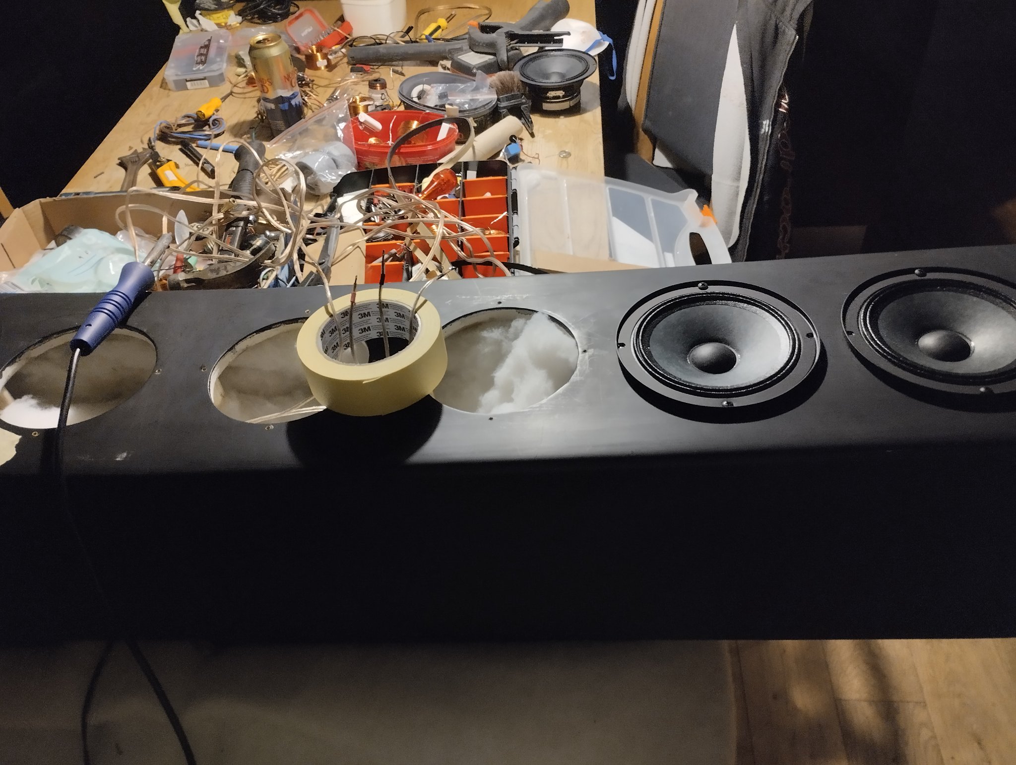

I would need to look at the decay of one of the midrange drivers in isolation to help understand is it the driver, or reflections from within the cabinet coming out through the cone etc. Do you have any damping in there ? what does the decay look like at a sound level of 80dBs, is the decay more sensible from the midrange?

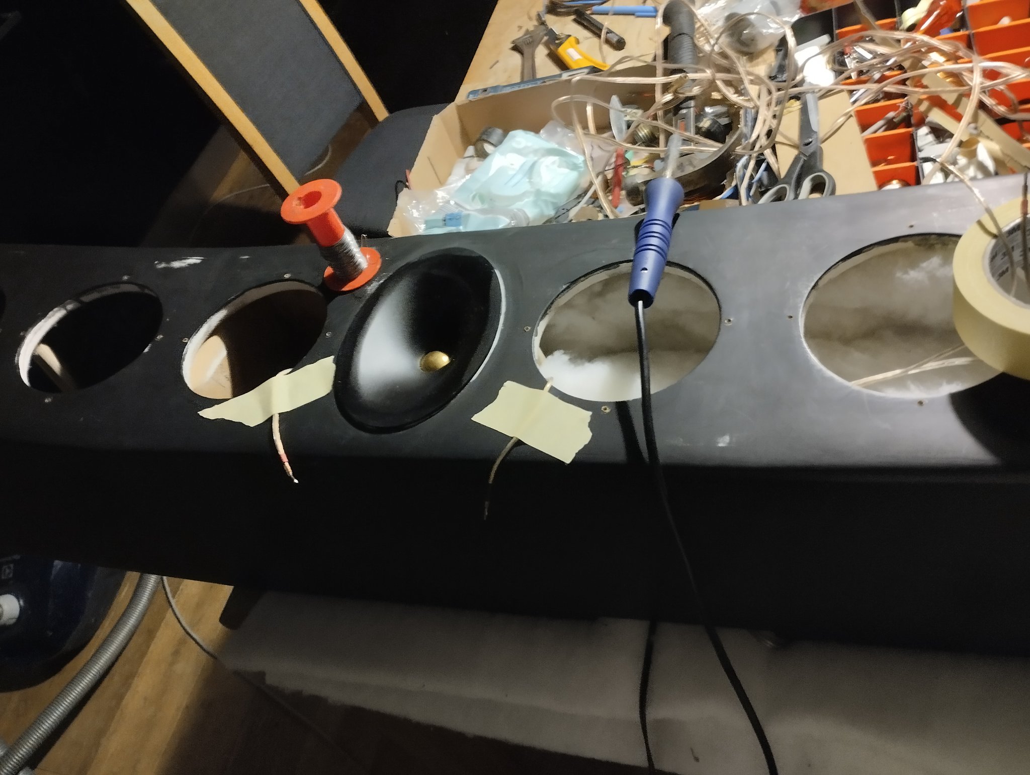

Just seen your picture of the cabinet damping, I wonder what some decent stuffing would do to the decay.

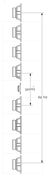

This is ... driver placement.
i would imagine this configuration to have issues.
of course the issue may also be something else.
try taking out the tweeter and one woofer and building a test bookshelf speaker to see if the drivers or the crossover or the box tuning are the problem.
if the bookshelf works fine but array doesn't then it is the arraying itself that is likely the issue.

As per above but stay in the current box... run only the treble and one bass, say the one under the horn, and measure that. Expand with the bass driver above the horn... measure, add 2 more... see what happens as the "line" expands down/upwards...
YOu are catching room effects/boundaries in those long measurements. Need to be gated enough to avoid reflections.Dont know the settings in REW for best waterfall or spectrum
Also the enclosures needs more damping material.
Arez and others have thoughts about long measurement's being polluted with reflections/room boundary affects. Very good point.
I am wondering if there is something in your measurement that needs some adjustment. If I take a measurement from the impulse and go out with the window to another 6-12mS I can get graphs that look somewhat like yours.

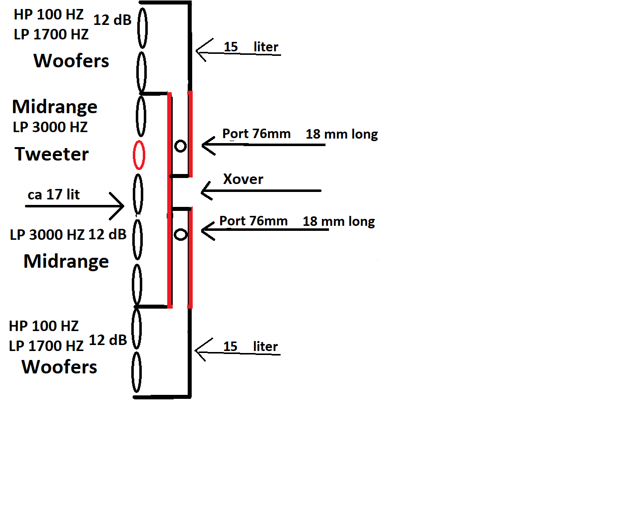

Does each driver have its own compartment? Whats the volume? What damping is used inside? Closed?
The upper and lower basses, are they OB or do they have an own/other compartment.

Inside specs in a really handsome sketch 😉Does each driver have its own compartment? Whats the volume? What damping is used inside? Closed?

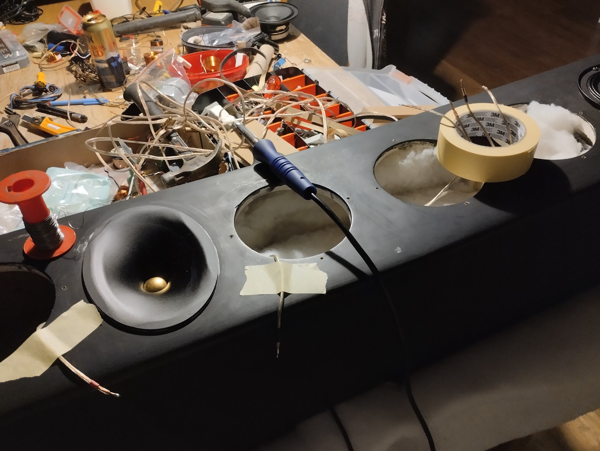

10 mm filt and a little "white stuff" inside ( more "white stuff in midrange = 4 midrange area) bad pics!

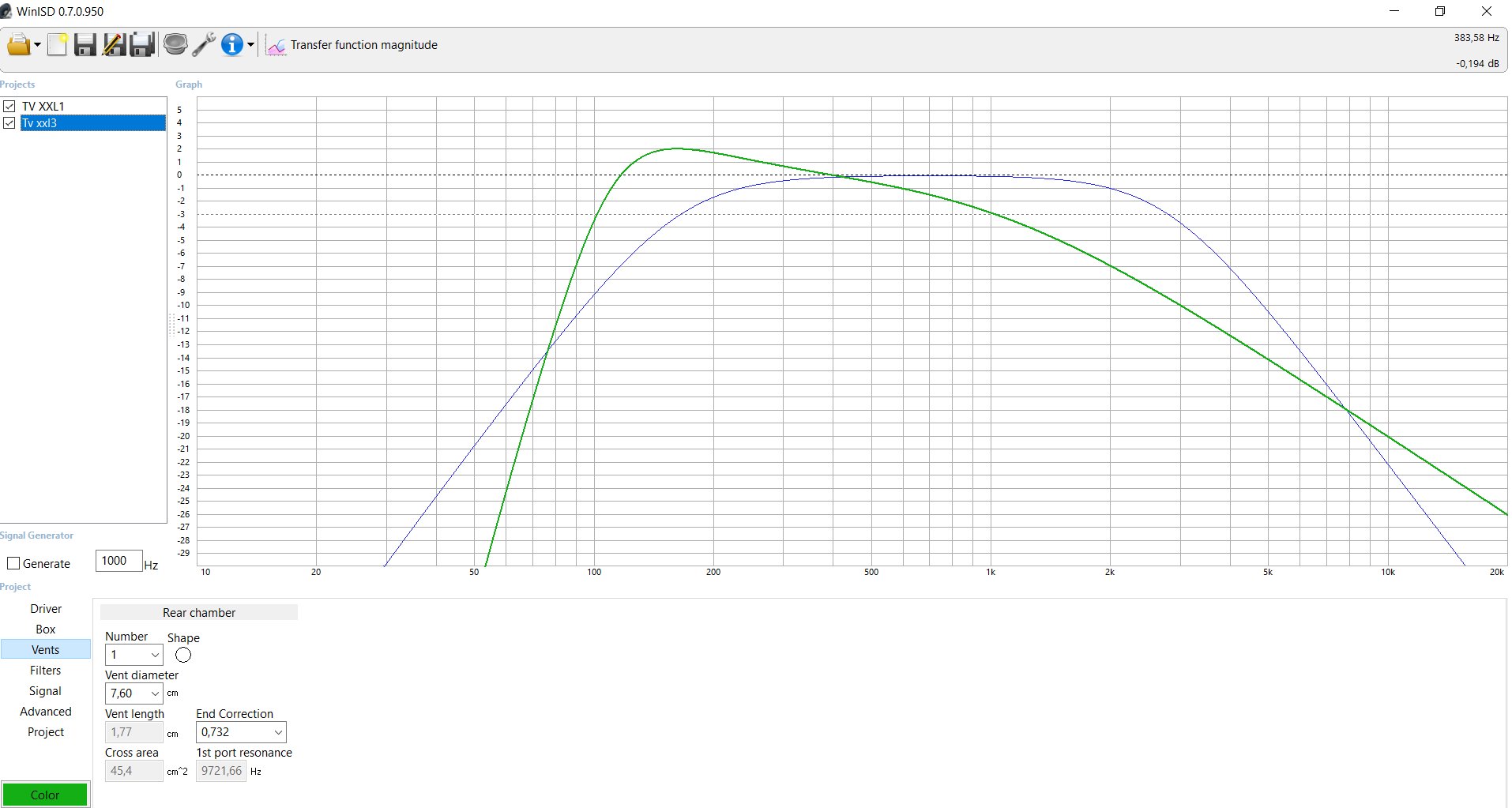

I had it the first 2 weeks without cutting the port out.Try close the ports and EQ flat instead.
Was trying to get more "punch" with ported, and maby some dB in 120-200 hz region.
Tuned now to ca 110 hz

Midrange cabinette is 84 cm high, maby 81 cm inside.In some of the measurements I see something conspicuous at ~350Hz.
What is the inner height of the mid enclosure? ~0,5 meters would match a standing wave resonance at this frequency.
15 liters with port d=76mm l=18mm will give a tuning frequency about >100Hz...
Yes tuning is 100-110 hz 👍
Spectrogram:
OkeyWaterfall:
Here is from 6 days ago, with same setting in REW as your post.

As I said earlier, I tested the speakers without the ports for 2 weeks. (before i cut the 4 ports holes)I think your tuning of the "bass" system is your problem - why on earth use a Helmholtz resonator for a "mid-bass" unit if it isn't for PA and absolute maximum SPL is required...
Simulations in Winisd showed better responses in the 120-220 hz region, so thats why my planed speakerdesign had 4 ported woffers.
Is your opinion that my problem comes from " that i design the 4 woofers ported" ?
Anyway, my first change will be to lower the LP on woofers to ca 1100 hz 12 or 18 dB.

OK. If you uncheck the "normalise" button in png2 post #54 - how does that look?
Your bass bins jump 13ms from your top at 100Hz - this is quite a lot.
