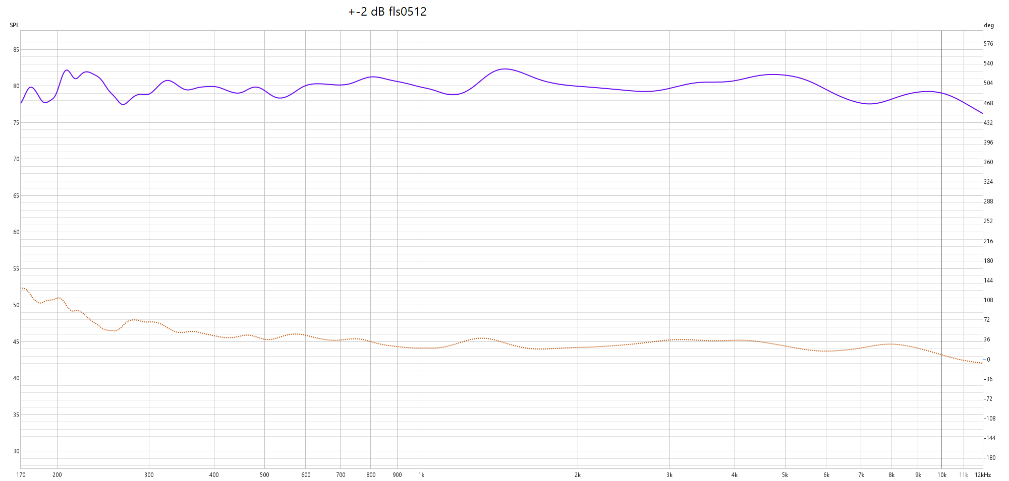

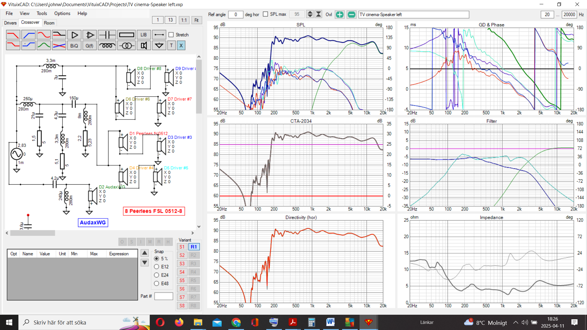

And quite impressive cheep driver, when measurement without xover look like this!
+-2 dB between 170 and 12000 hz.

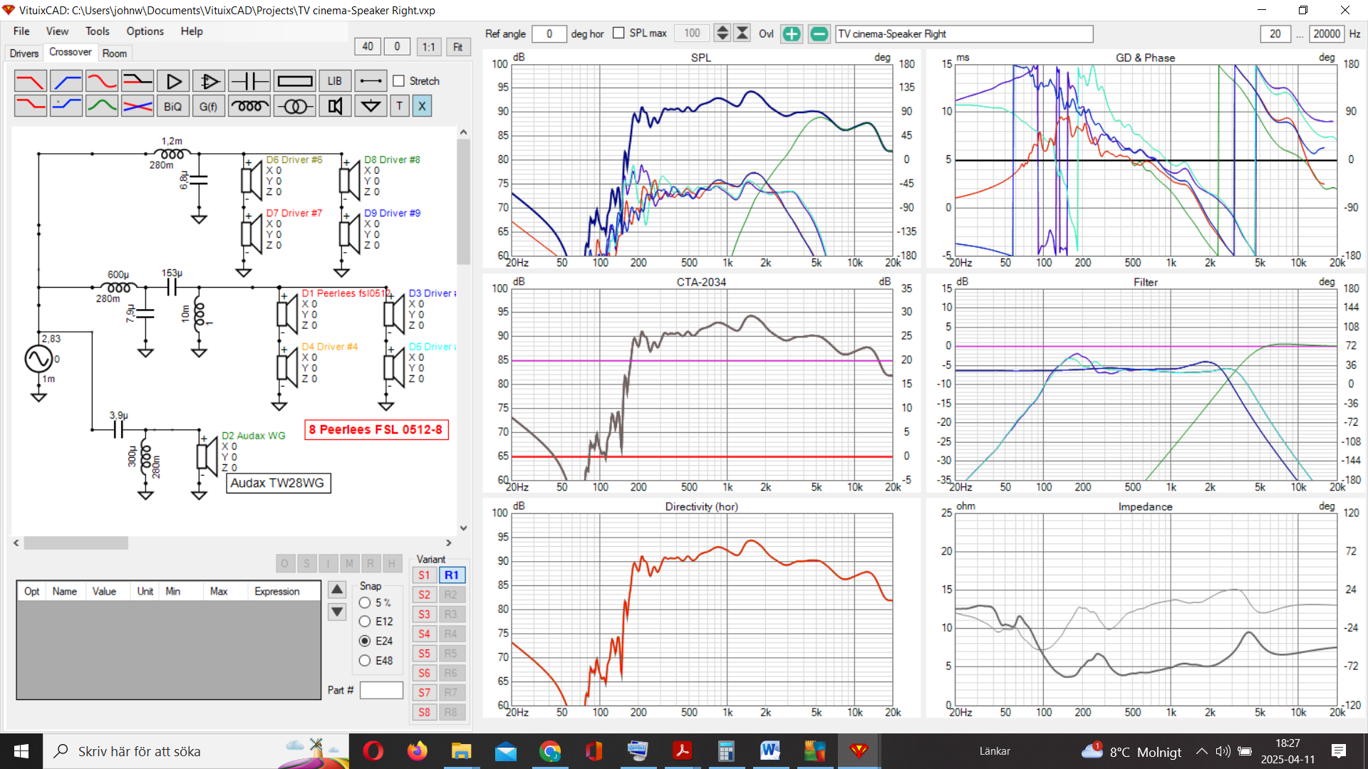

What is your XO frequency and the XO schematic and ORDER.
I still test 2 different xovers, one for left speaker and unother on right speaker.
Left has a notch and other values, but the notch creates a little low impedance.
Both speakers measure good, so right speaker without notch seems to "also" work.
Only 2 order LP at the 4 working as "woofers"
And 2 order LP and HP at the 4 working as "midranges"
Crossed today at 2900-3150 hz
And midrange HP at ca 200 hz
Here you have left and right xovers
Do a manual frequency sweep and listen to all frequencies , note down interferences, réflexions, parasitical, low and highs, beaming, etc then try to correlate what you hear with the microphone measurements
That helped me tremendously in xo
Sometimes 3rd order is required, in general try to xo when the driver has. A natural decay … your values seems right
