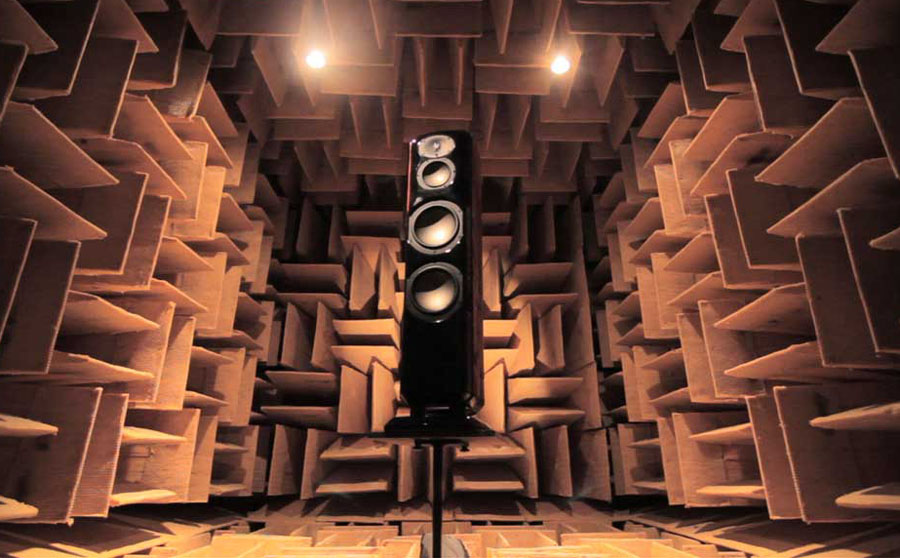

The question is, a flat response speaker at the anechoic room will be a desirable speaker for the end user or not....
That's a real good gedank-experiment but not for the reasons you think.
Sound in an anechoic chamber is awful and it isn't the FR*. Of course, I have nothing but my long-ago experience in once world's largest.
B.
*I suppose if you recorded anechoicaly and then played in normal rooms it might be OK - as is actually the case with many pop and vocalist recordings folks think are really great after pseudo-echo is synthetically added.

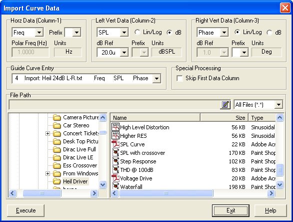

Hello Bentoronto
LEAP it's quite an amazing piece of crossover design software! All you need is a good reliable measurement system to go with it. I use CLIO and LEAP and it's a really good combo. LEAP comes with an awesome set of tutorials to get you going and after that you learn from doing.
Rob 🙂

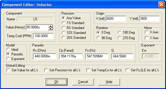

LEAP, on first examination, seems to take loosey-goosy inputs and calculates parts values to three decimal places.
The only thing loosey-goosy about LEAP is if your measurements are not accurate. Other than that it's predicted curves are as good as your measurements. LEAP was one of the tools Greg Timbers was using at JBL.
Bi-amping the JBL Model 1400 Array
And a couple of screen shoots
Rob🙂
