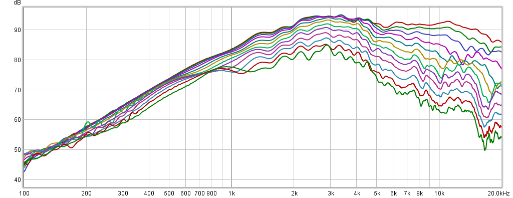

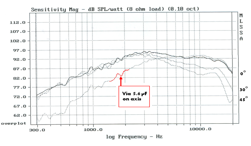

George the attached snip from the Morel CAT378 datasheet (a semi horn loaded soft dome tweeter) demonstrates just how easily the rising response from a horn loading can be counteracted. It would seem in fact that they designed the tweeter so that it could be easily used with 1st order electrical crossover (I haven't checked but suspect 2nd order acoustic rolloff).

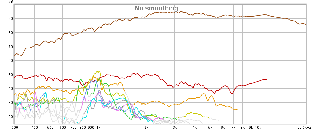

The second and third attachments are measurements of one of my morel DMS37 tweeters, the predecessor to the cat378. The first is horizontal polars taken in 10 deg increments from on axis through 120deg (after 120deg I started to get problems due non symmetry of the testing space).
Third is distortion plot. The highish numbers are due to the way REW is calculating. If you change the graph to only show from 1Khz up the figures are much lower. In any case above 2Khz I feel that the distortion is quite respectable. Drive level was 2.83V measured at 1M.
Tony.

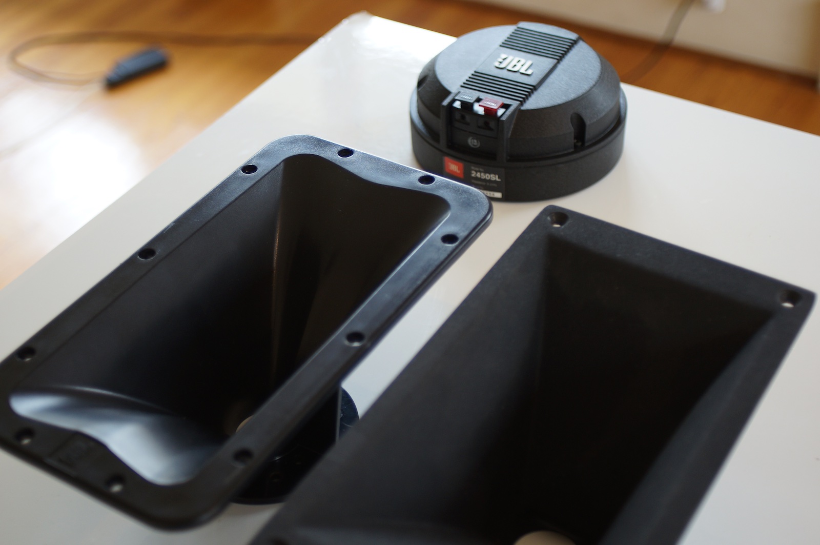

I recently found that I prefer old horn with obvious hump to the modern waveguide which FR is much smoother. My head kept telling me this waveguide is better, but my heart not. I was very confused, but I decided to follow my instinct. I realized that my time is so limited to listen to the unlimited amount of music that is on Tidal. Don't think, feel. 🙂
Picture added.
