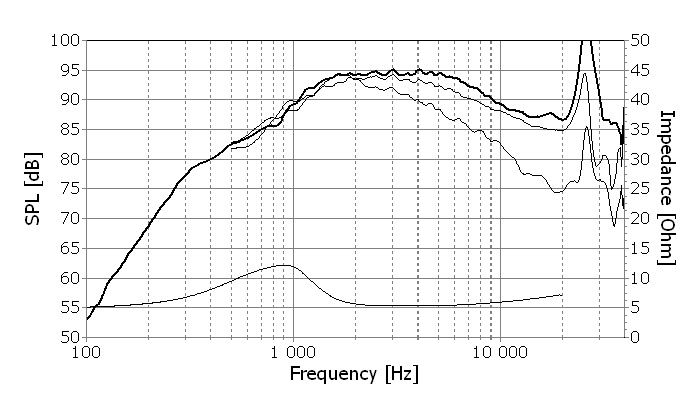

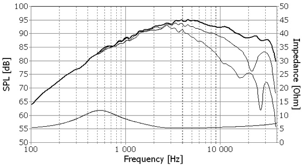

Here are two examples to illustrate my point:
First curve is a $19 HiVi and the second curve is a $546 Seas Excel.
George
There are aspects of the Seas frequency response that are better. Can you spot them?
As I mentioned before, unless you happen to be using the same conditions under which the MFG measured the driver, you will get a different (and non-flat) frequency response from the very same driver when used in your loudspeaker project. You can easily correct a peaking FR using the crossover, so don't put such a premium on "flat" MFG curves.
If you compare other performance metrics besides frequency response you will start to see some more compelling differences. The problem/challenge is that many of the other performance metrics I mentioned in post #3 are not published by the manufacturer. You have to measure them, or find someone who has. Also, after a bit of experience you will get a feel for what you can expect from a certain type of driver based on its construction and the reputation of the MFG.
Some drivers outperform their price point and represent a major bargain. Other drivers use exotic construction techniques, or command a premium because of their "pedigree", and are less of a bargain while still being of high quality (and priced that way). Some drivers perform quite differently than their MFG data sheet might suggest. Some drivers meet spec at 100mW but then fall apart at even modest power levels. Mostly the MFG data sheet will tell you very little about these other aspects of performance and is just a starting point.
Also, price should not really be a factor. Either you can afford it or you can't, and if you can't then don't worry about it!

The Seas driver has about 10dB more output at 1kHz. This may or may not translate into 10dB more maximum output capability, but I'm sure that it is going to be significantly higher. This allows a lower crossover frequency and/or just more overall SPL and/or lower distortion.
The Excel driver has higher average sensitivity. This allows more response shaping to be done in the crossover and will give the system higher average impedance. With tweeters, in general, it is better to have an overall falling slope than a rising slope. It requires less crossover components to fix this.
Problems I see.
The measurement of the first tweeter is massively smoothed. Run away from any curve that looks like this. They are hiding things. There is no reason to smooth measurements. It is just like grinding welds smooth. The only reason is to hide something.
The first tweeter doesn't have an impedance curve. You can't evaluate a driver without this. The impedance curves tells you a lot of things about the driver that can be hidden in a frequency response measurement.
There is also the issue of consistency. Buying an expensive driver doesn't guarantee this, but some some manufacturers, it greatly increases the chances of it. When you purchase an inexpensive driver, the odds are that it will not be as consistently manufactured. The first response curve above looks quite nice, but how many driver samples did they have to measure to find one which was this flat? Probably quite a few.
Without a doubt they are very expensive drivers that just aren't good, or at the very least aren't any better than a $25 driver at sound reproduction. Why do $1,000 pieces of speaker wire exist? Certainly not because they sound better. Drivers aren't going to be any different.

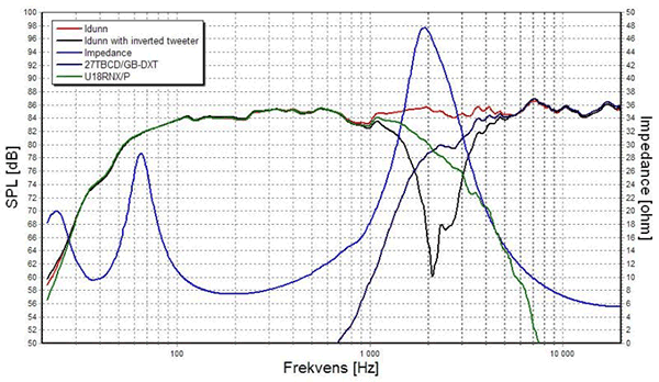

Continuing my quest to understand this, I looked at a Madisound kit (Idunn) using a Seas Tweeter with a similar "hump" in the data sheet response curve but a more modest price - 27TBCD/GB-DXT (H1499). The system response curve is much flatter than the tweeter spec sheet would suggest. As a matter of fact the individual curves also show a flatter tweeter. The crossover is fairly simple - 3rd order with L pad for the tweeter and a simple 2nd order for the mid. No BSC, no notch filters, etc. What accounts for the major difference between the tweeter spec sheet and the much flatter system curve?
Thanks,
George
Thanks,
George
George,
This is a good example of why it is better to have a tweeter with a sloped down response. If you look at the high pass filter on the tweeter, I'm sure that theratio of L to C has been adjusted to make the Q of the filter very low. This compensates for the sloped down response of the tweeter from 5kHz to 10kHz and makes the electroacoustic response flat.
They probably don't publish this, but try to get a look at the crossover v-plots. That tells you a lot.

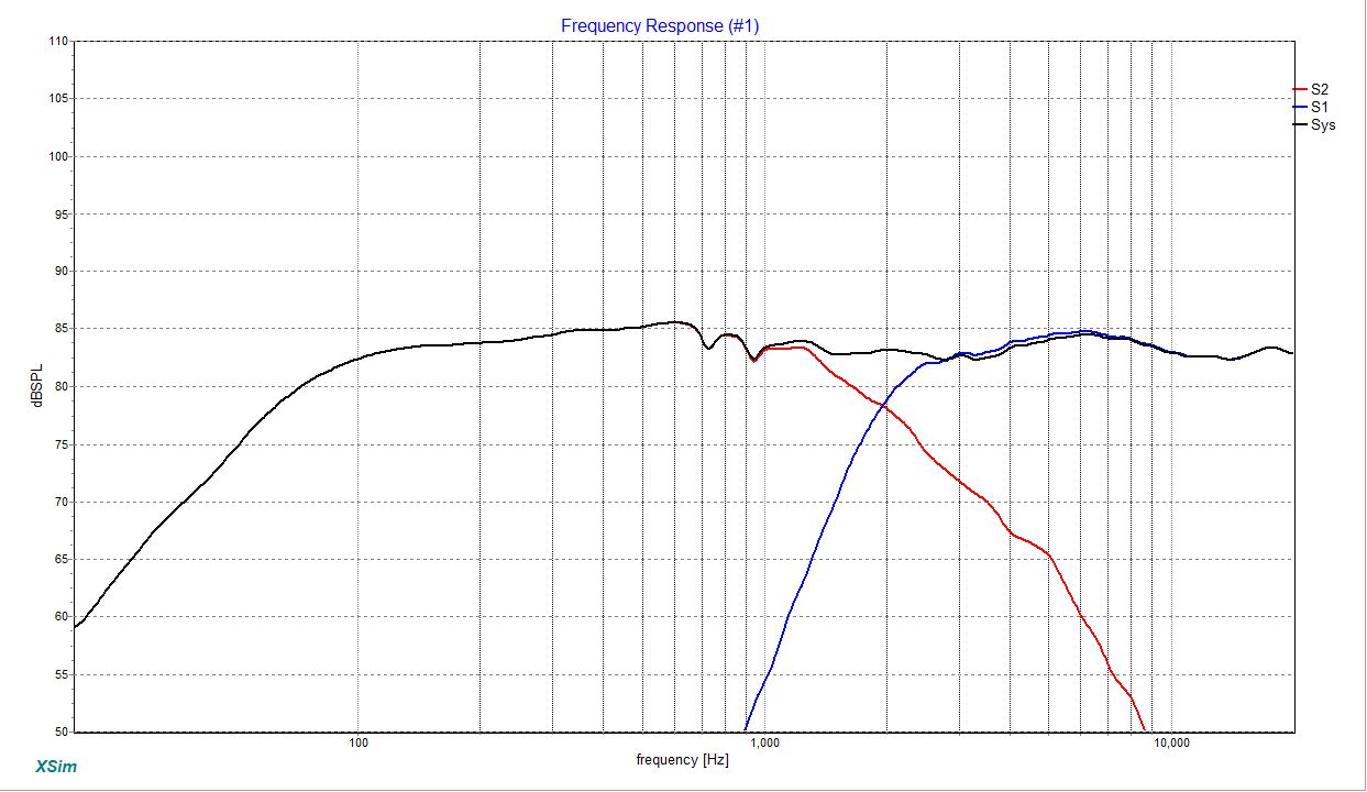

I traced the driver curves, lifted the xover circuit, and massaged the numbers. I don't have the benefit of the actual drivers in the enclosure but I am pleasantly surprised at how relatively flat I can get the system response curve so a downward sloping raw tweeter curve can be massaged to work very well. Attached is what I came up with in 5 minutes.
Thanks,
George
Thanks,
George

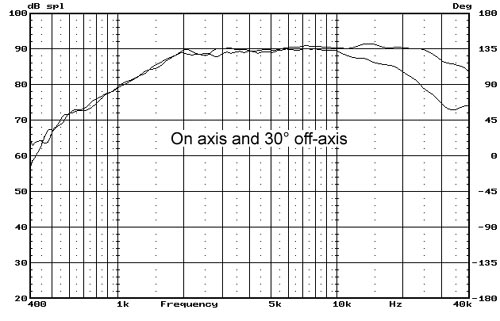

$546 Seas Excel. From the data sheet "A 7 mm thick precision die-cast aluminum front plate with moderate horn loading"
The key words "Horn Loading" This tweeter has a built in waveguide or horn that boosts the lower range. This is the desired result. It is expected that the user understands this and compensates for it. This horn gain allows the tweeter to play the lower frequencies with less cone excursion and therefore less distortion. I only came to appreciate this myself in the last few months as I looked at building some speakers with a well controlled radiation pattern or constant directivity.
Seas T29B001 Beryllium Dome Tweeter
