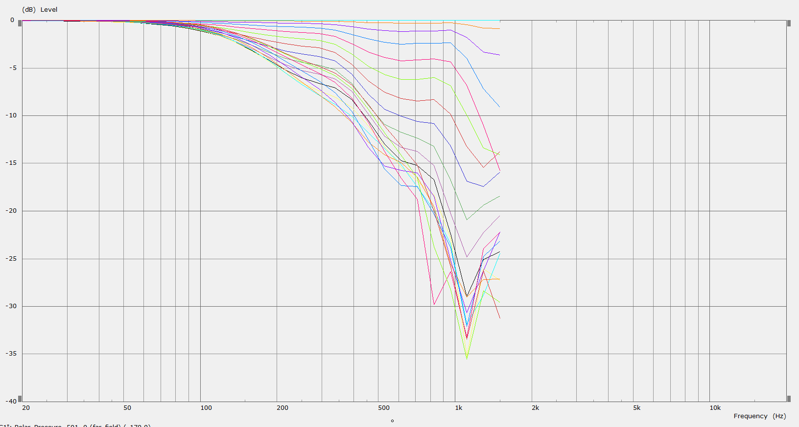

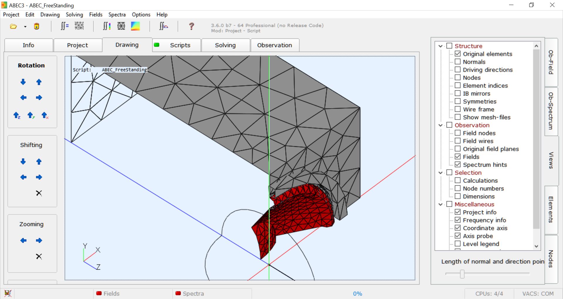

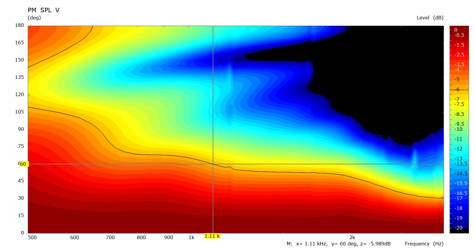

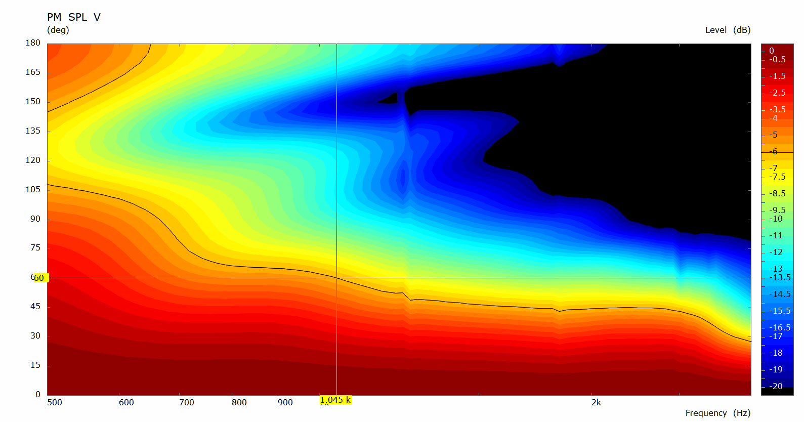

Here's an ATH/ABEC configuration file to compare flush, surface, and recessed mounting an 8 inch Dayton DC200-8 woofer. You can modify the Source.Contours in the configuration file to create different driver shapes, different enclosures, etc. In this case I simulated a H x W x D (234mm x 260mm x 260mm) box. It was supposed to be a 260mm cube but I forgot to change my box height. Recently, I used a surface mounted driver in a non-cube shaped enclosure because I wanted a slightly wider polar pattern at crossover to my waveguide. In addition, the radiation pattern over the controlled bandwidth of the driver was affected - slightly. Basically, it helped smooth my polars over the region I was trying to control. After I discovered that I remembered Neumann elevates their woofers and adds a slight bevel. So whether you surface, flush, or recess mount your driver just depends on what's going on at your crossover and your overall polar pattern goal. Would I mess with mounting variants if I couldn't use simulation first and had to physically build/measure a speaker to figure out my crossovers? Heeeeck no. But since simulation is so easy thanks to ATH software I wouldn't not do it now.
Surface mounted
Flush mounted
Recessed mounted
Designing and building speakers is all about making rational choices. It is not necessary to recess drivers, but doing so will increase the potential performance. With surface mounted drivers, tweeters in particular, there will always be some added diffraction bumpiness to the response, both on and off axis. That does not mean the speaker will sound bad. It just means that the performance potential is limited by the presence of that diffraction.

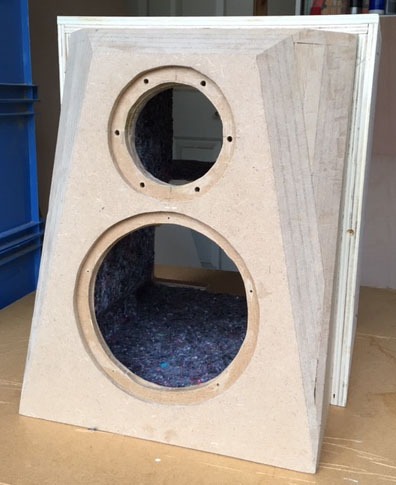

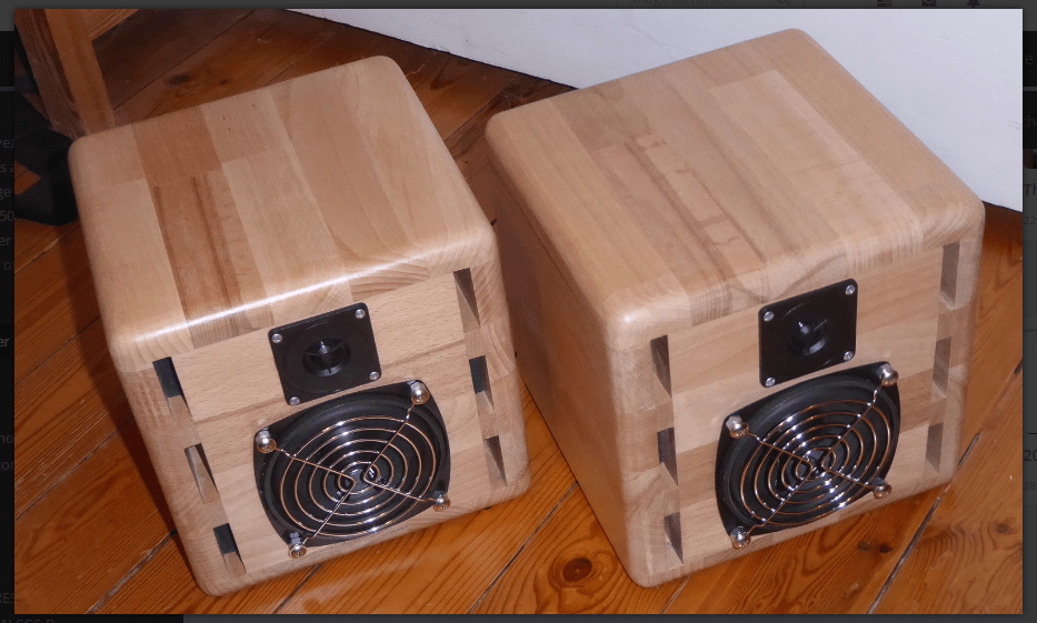

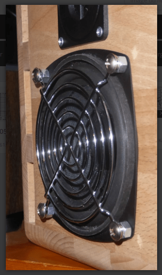

Years back I built some three ways and the instructions said recess the HF & mid. I made the baffle in two sections the second was slightly too thick. Cut the holes in the main bit, cut the profiles in the top layer then clamped and bonded the two with PVA. I Packed out the bottom layer cutouts with some veneer offcuts toalign the drive unit surfaces. Clamped & PVA'd the life out of those too.
Seemed to work ok once glue set, it was rock hard and as if it was one piece. I was young and couldn't afford a router etc. etc.
That what I have done with all my builds. I make the baffle in layers, with the one or two layers at the front having a hole fitting the outer rim of the driver. Where I live, a router (a) is too noisy, and (b) makes far too much dust for my small working space.

Yeah the whole system, including room and positioning, have to work together for best results. That would also include the recess and all other features imaginable. No magic bullets, just bunch of details that align towards same goal.

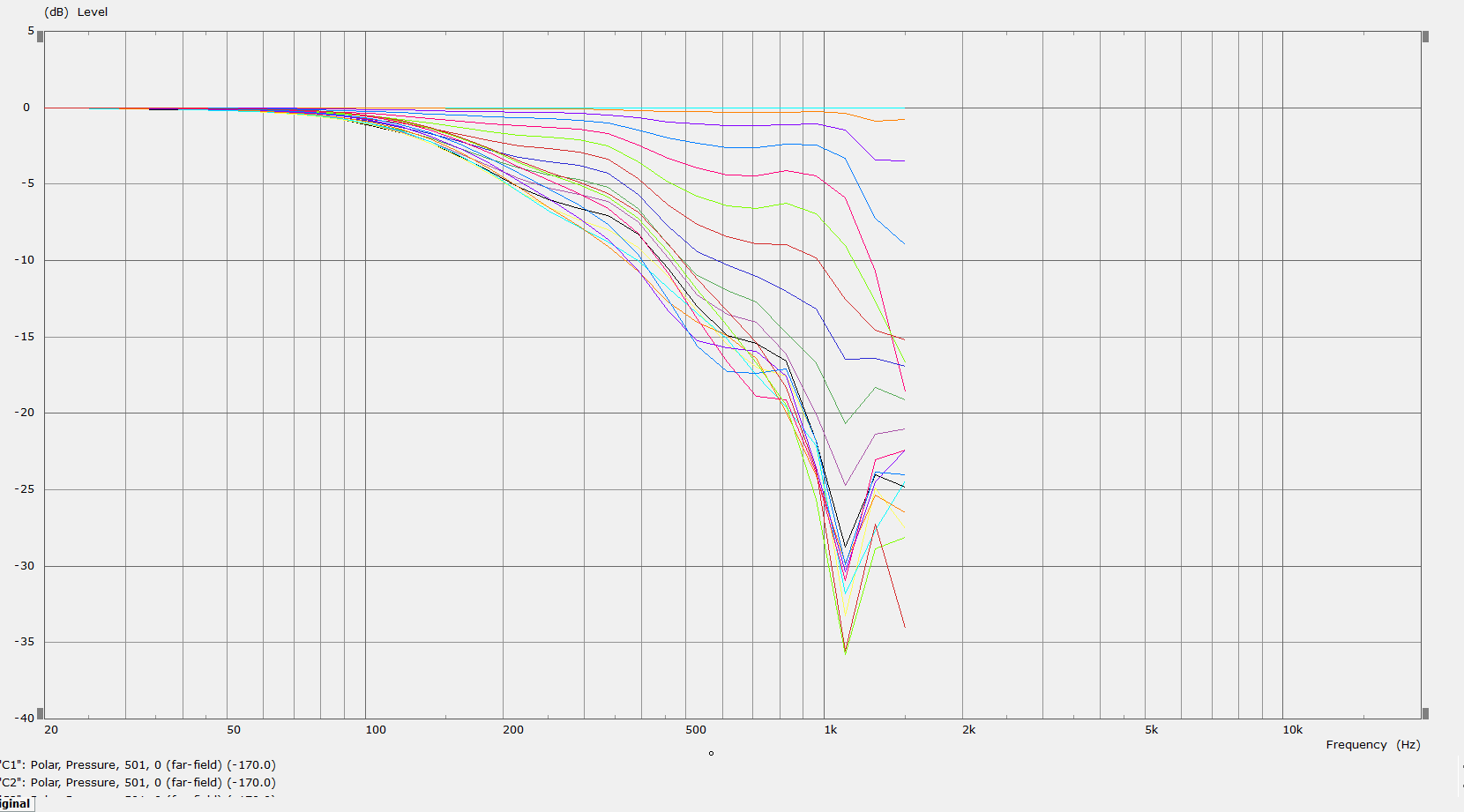

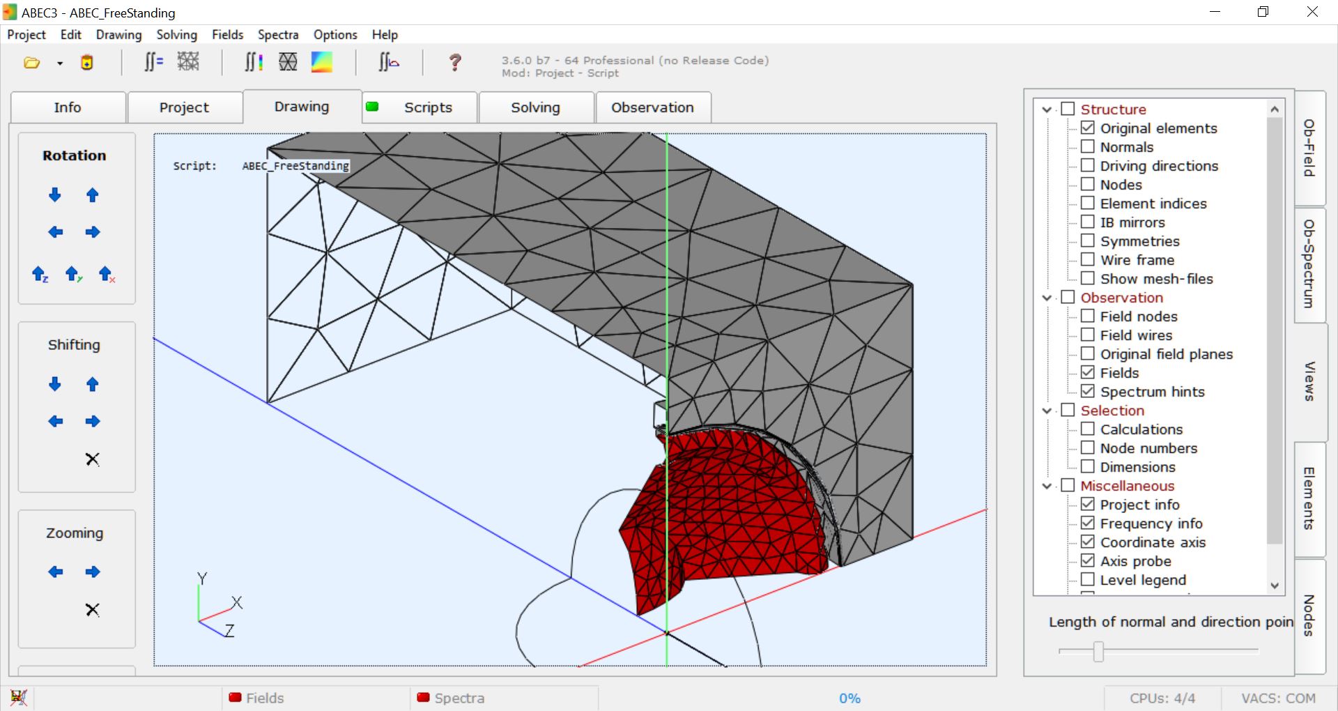

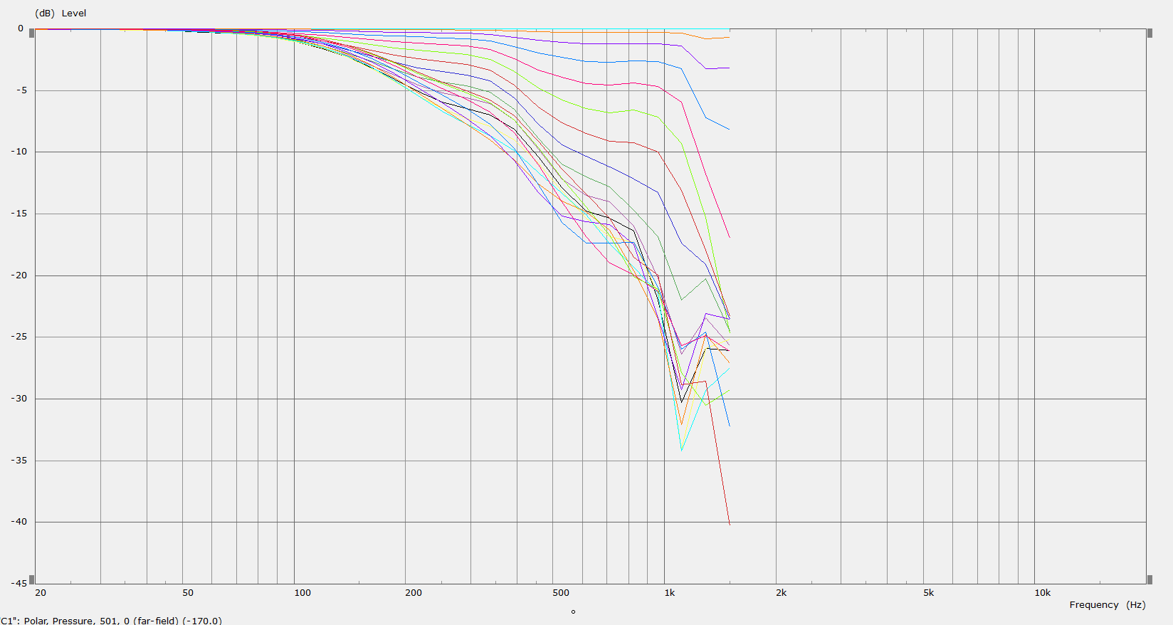

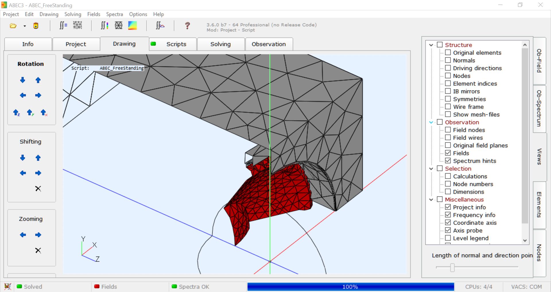

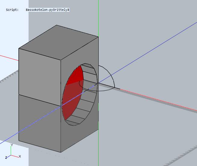

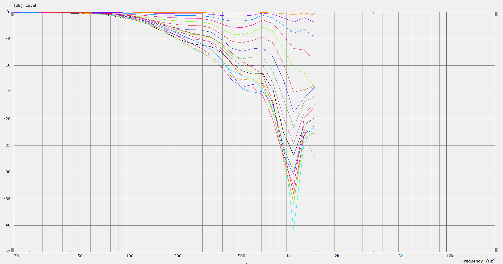

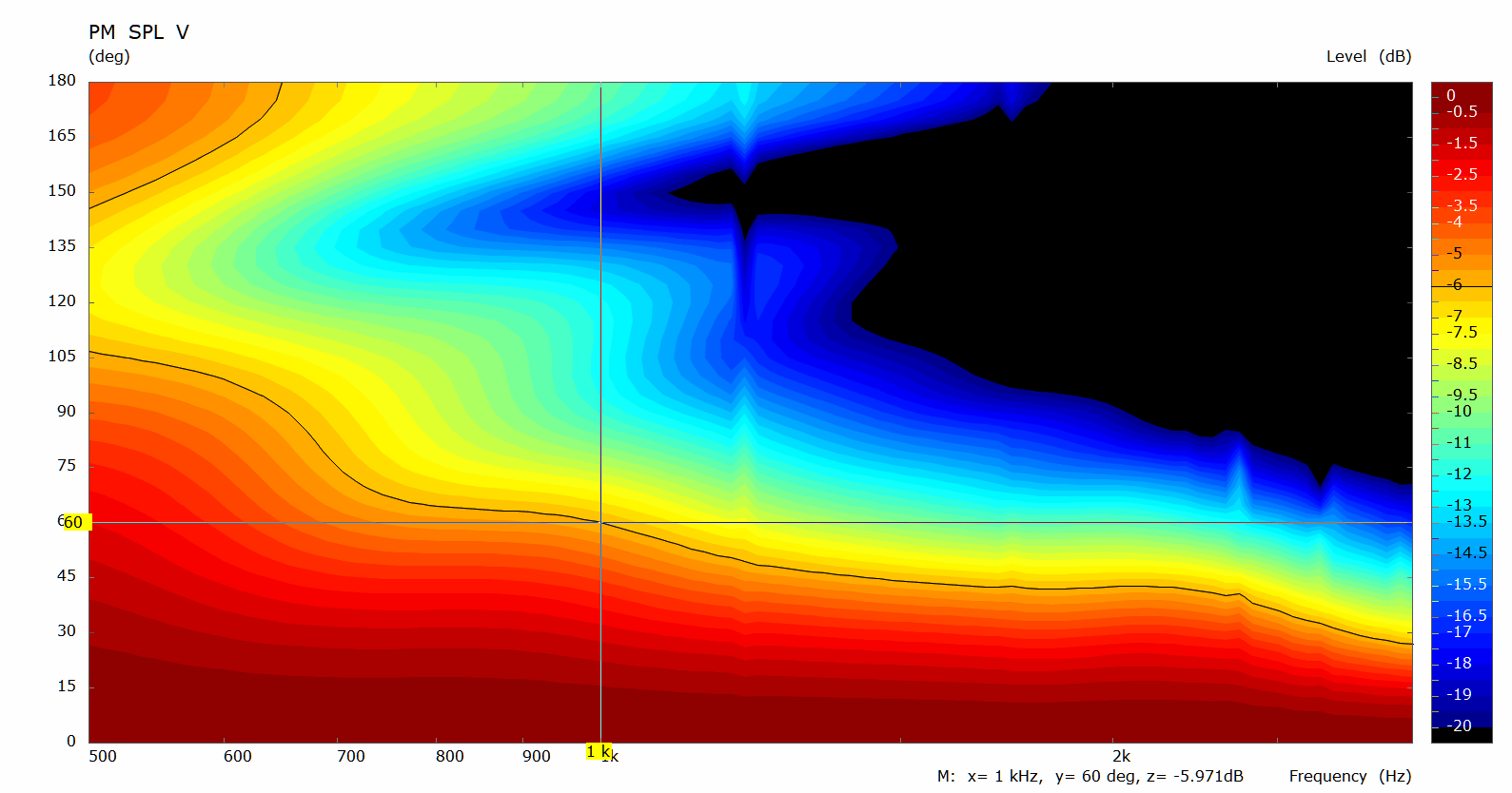

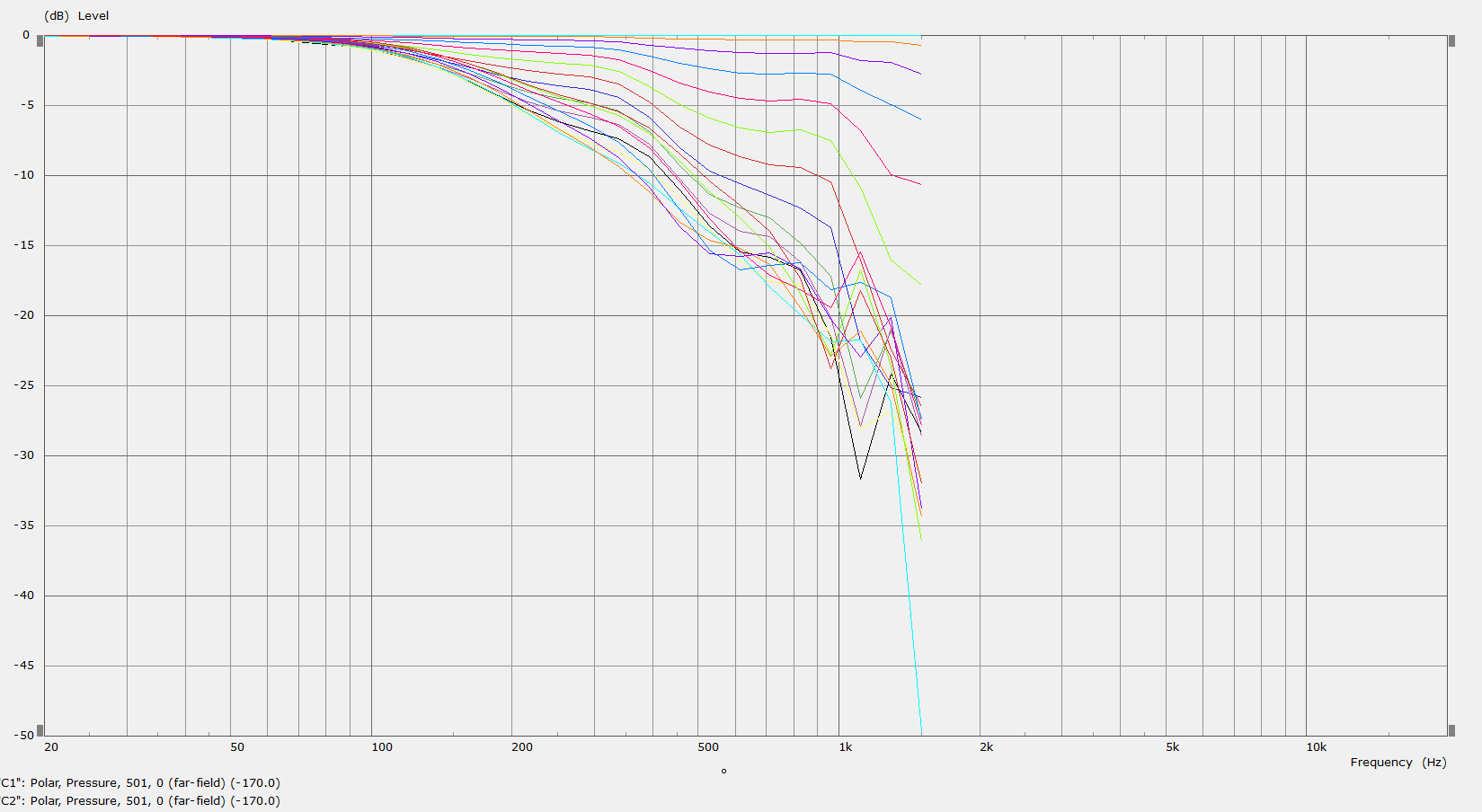

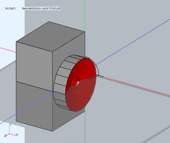

ps. here is similar sims to what cinnamonrolls posted. This is 15" driver with various (huge) recess. Sorry the images are not consistent through out, but I think it's enough to give hint of magnitude of things.
Here protruding
Illustrations what the models look like, extreme case of 100mm recess and protruding.
ps. This kind of simple boxes are easy to do with ABEC alone. There is Baffle and Diaphragm definitions along with few nodes that determine size and shape of the box, which makes things like "recess" just one parameter to adjust and simulation that is very fast to compute. This stuff can be adapted from example projects that come with ABEC, found from the Project -menu on the main program.

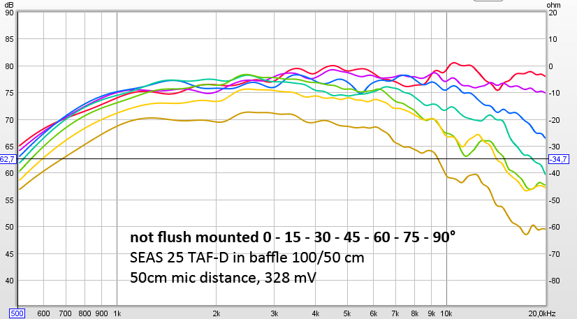

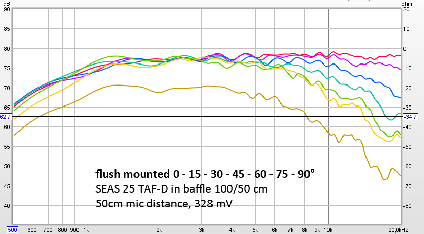

probably similar to zaph's measurements, here are my results for a 25 mm SEAS aluminium dome mounted on a large baffle (100 x 50 cm), gated measurements 1/24 octave smoothing, 50 cm mic distance, 328 mV signal, 0-90° in 15° steps.
use arrows in zoomed in view to toggle between the images!
slight differences below 1 kHz are probably due to slight rotation center difference (that is aligned with baffle surface).
depending on how much you take care of baffle edge diffrations those have a way more dramatic impact than flush-nonflush mounting.
