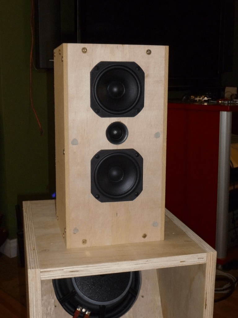

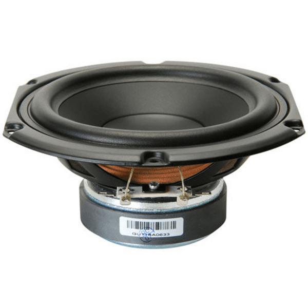

post #9 no need for a router - mattk's MTMMM Peerless 830656, Dayton ND20FB-4
https://www.diyaudio.com/community/...cond-build-after-c-notes.407647/#post-7564010
Peerless 830656
Key Features
  • Premium sculpted stamped steel chassis
  • Coated paper cone with rubber edge
  • Smooth, extended response
https://www.parts-express.com/Peerless-830656-5-1-4-Paper-Cone-SDS-Woofer-264-1078?quantity=1

Kec's TC9FD18- Adason ND20fb

Dayton ND20FB-4 tweeter. Drill a hole rear mount. Of course check the baffle thickness.

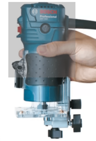

A router and a circle for it are really nothing to cry about. Some years (ages) ago even a jigsaw was an expensive tool and DIYS people made speaker cut out's with a hand drill and a file, hole by hole. If you buy a speaker kit and want to DIYS, concider to get a drill, jig saw and router, sell it on eBay later, if you don't like it.
Anyway, discussing the value of rebating a driver, because someone is too stuborn to use an electric hand tool, seems some kind of crazy to me.

I have a Perles plunge router that I put on the lowest RPM when I have to mill something like MDF.
It goes in like butter, and moves not much more different than pencil. (just a bit bigger)

My router doesn't have speed control. This small speed controller has made it way less dangerous to use. I was lucky the times it jumped out of my hand before!
